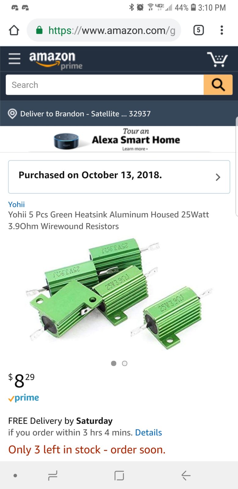

Ok then why does everyone at the beginning of this post including @NORCAL SS the suspension guru state that the same 3.9 ohm 25 watt resistors wired across the connectors at the shocks will eliminate the message and allow you guys to run whatever shocks you need? According to all I've read the same simple solution that works for the NBS also works for the NNBS. It's all through this thread that it works, until you say it doesn't.

I'm not saying norcalss is wrong. Those are the correct resistors that need to be soldered across the old autoride shock connection.
However, when I replaced my autoride system with bilstein 5100s, I had to wire resistors across the ride height sensors as well. I did not find out that I had to do that until I got a service suspension message after I had already wired up the 25W resistors.
