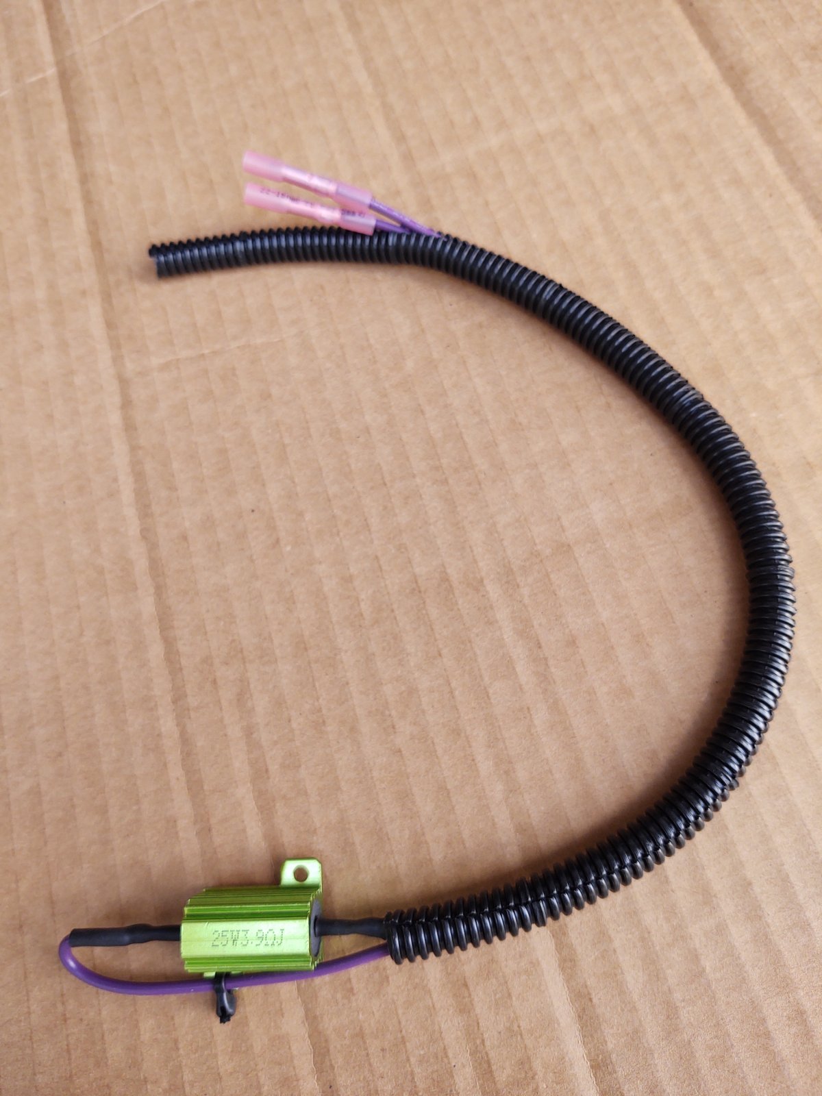

SO, I NEED HELPS!! Just installed lowering kit on a 2011 escalade with autoride. CUstomer supplied resistors to install. Finished install, and started truck up. Smoked all 4 resistors. LIke melted the heat shrink off of them and started smoking. Found out they were only a 10W 3.9 ohm resistor. Removed those and installed 25w 3.9ohm resistors. Just finished that and started it up. took longer this time but it smoked them as well! ANy help? Why would it smoke them? PLease!!!
I think the MRC shocks in an Escalade need a higher wattage than 25W. They put a higher current to those shocks than the normal autoride ones. Try 50W resistors...

Yes, but when Cadillac started using the MRC shocks, these are apparently different power wise. I know a lot of the "conversion" kits you see say they only work with the Autoride shocks, but not the MRC (Magnetic) shocks.

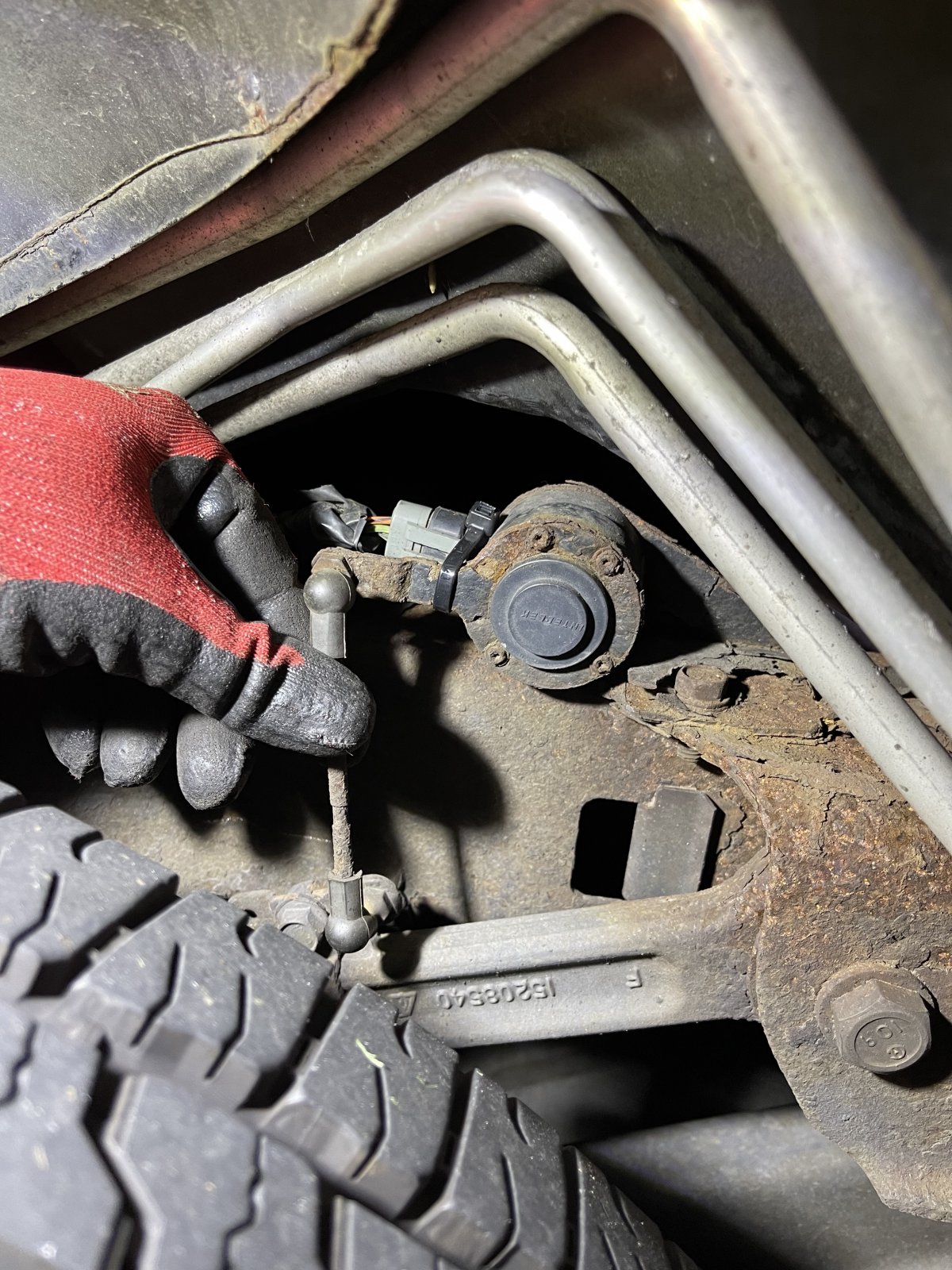

Looking for help with my 07 ltz avalanche. I did away the factory shocks and bought new struts, coils, and shocks and installed a 5" lift. Then put the resistors I bought from an eBay seller on. But still get the the service suspension message. I removed the air compressor as it was shot and unplugged the ride height sensors. Still get the the service suspension message. Where do I go from her?

I have the 25 watt resistors on the fronts along with Bilstein shocks (works good no Service messagage). Does the 25 watt resistors work for the rears too (NBS Autoride)?
