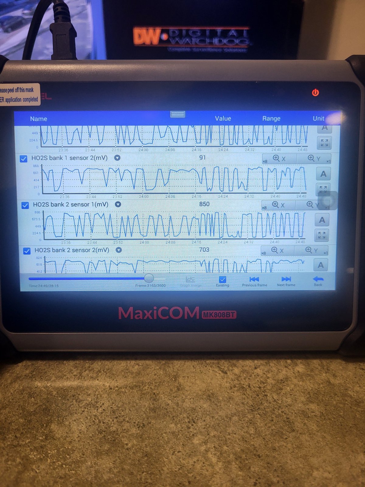

Another video parked and rpms at 1k and increasing to 1500.
Your other videos didn't show it adding that much fuel at idle (was 5% or so IIRC). But the high positive trims (+12 now) at idle go down with RPM (from what I can tell) and that indicates a vacuum leak. Not a big one, but one that affects the trims.

I say wait to hear back from black bear. their data log should have much more info in it and they can see if it's what they are used to seeing.
I kown you've had it looked at, but my curiosity would be, go find where that battery cable runs, I don't have a truck like yours, so I don't know if that's like all the way from battery to starter or something else. but I'd click the key on, turn on a bunch of stuff to get a good battery. get a meter, set to DC voltage, put on lead on end of the cable, and the other on the other end. you should have next to no voltage drop across it. like 0.2 or so at most. if it's a half volt or more, I'd suspect it's a bad connection somewhere.

my random guess is glazed plugs since it's modded and tuned. look fine but miss firing. the unburnt air from the miss fire telling the o2 is lean. ecm adding more fuel making it all worse
