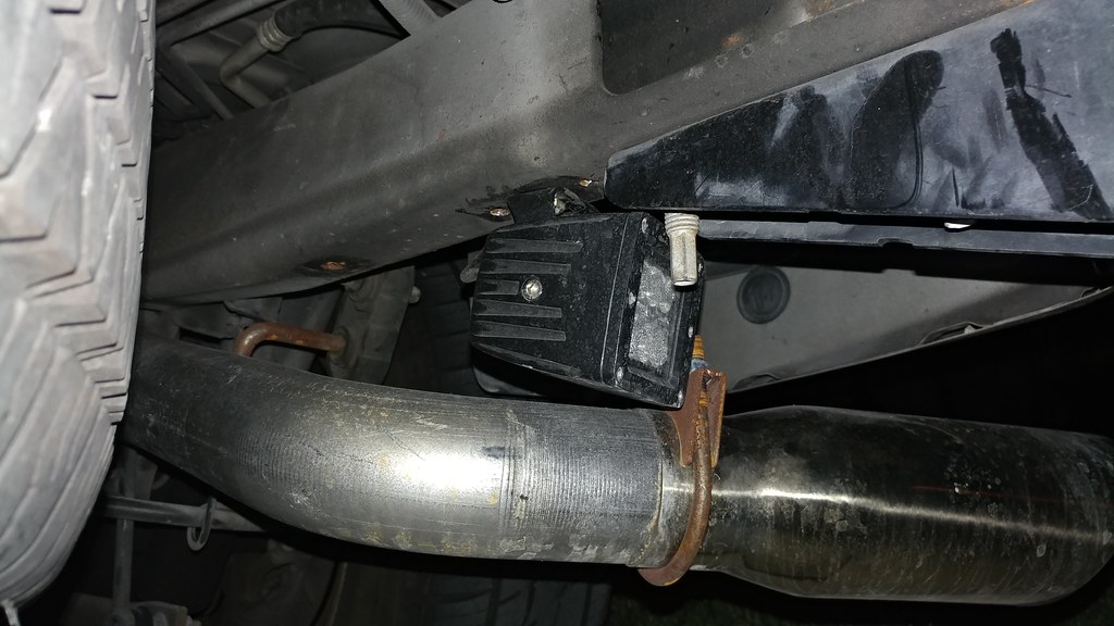

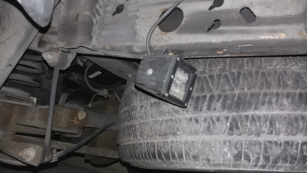

Well got the filling issue finally figured out. Dropped the tank again to see if any of the lines were clogged and sure enough they were. The lines were filled with the charcoal beads and since I never replaced the carbon canister and could pour the beads out from it I went ahead and replaced that.
Next I am going to try and replace the purge valve on the manifold to see if that will fix the hard start issue. I had the vent hose off of it today and can hear some of the beads rattling in that hose so I will blow that one out too. I think maybe that valve is stuck closed cause there is no suction from it when the truck is running with it plugged in or not.
