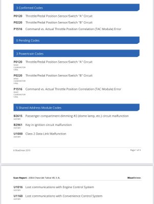

Recently my Tahoe has been dying overnight, 3 nights in a row.
Once I jump it, the RPMs will fluctuate up and down from 500 to 800. I’ll put it in drive and give it a little gas but it’s underpowered. Upon releasing the gas, it has this slightly aggressive RPM drop and you can feel the loss of power/mild jerk.
This goes away after a little bit of normal driving.
I’ve pulled codes, and they are also attached below.
A couple points. The alternator and battery are only a few months old.
I cleaned the MAF 2 days ago, and I also did that little toothpick trick for the ignition switch harness in the steering wheel area. I made sure the throttle body harness is connected and I also never touched the TB or butterfly valve.

Your U-codes indicate an issue with communication; for the DDM you may want to check the harness at the front of the driver's door, where the wires go into the body. They can break there, underneath the insulation. So the wire might look good but could be broken inside.
