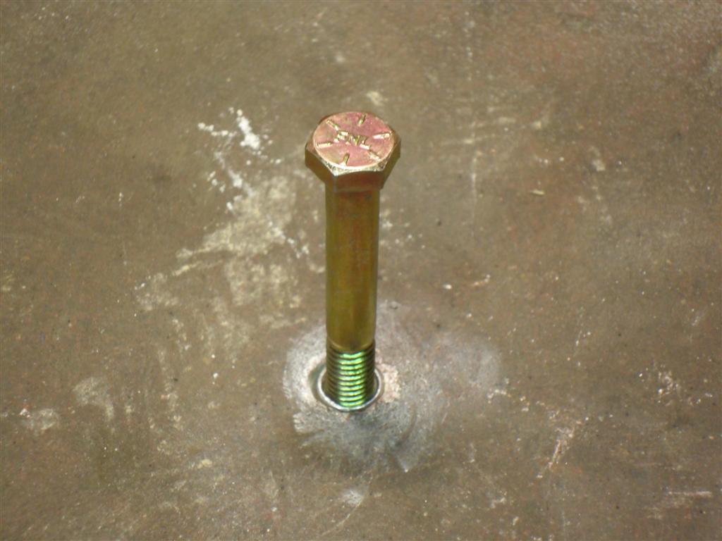

Yeah that's the same setup I use for my harbor freight tire changer. I have holes drilled in the floor and use these oversized tapcons to bolt it down with a impact gun. We use these for our form rentals at work to bolt gang form walls to foundations.

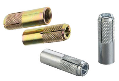

A fabricator buddy kinda did the same thing with his tubing bender until the holes in the concrete wore out. He could only drill a bigger hole and move up to a larger bolt, so I gave him some anchors that we use to bolt down safes. They leave a threaded sleeve in the concrete so you can screw in a regular bolt. He set them a little below the surface level of the concrete so when not in use, he snaps plug covers over them to keep dirt and debris out.

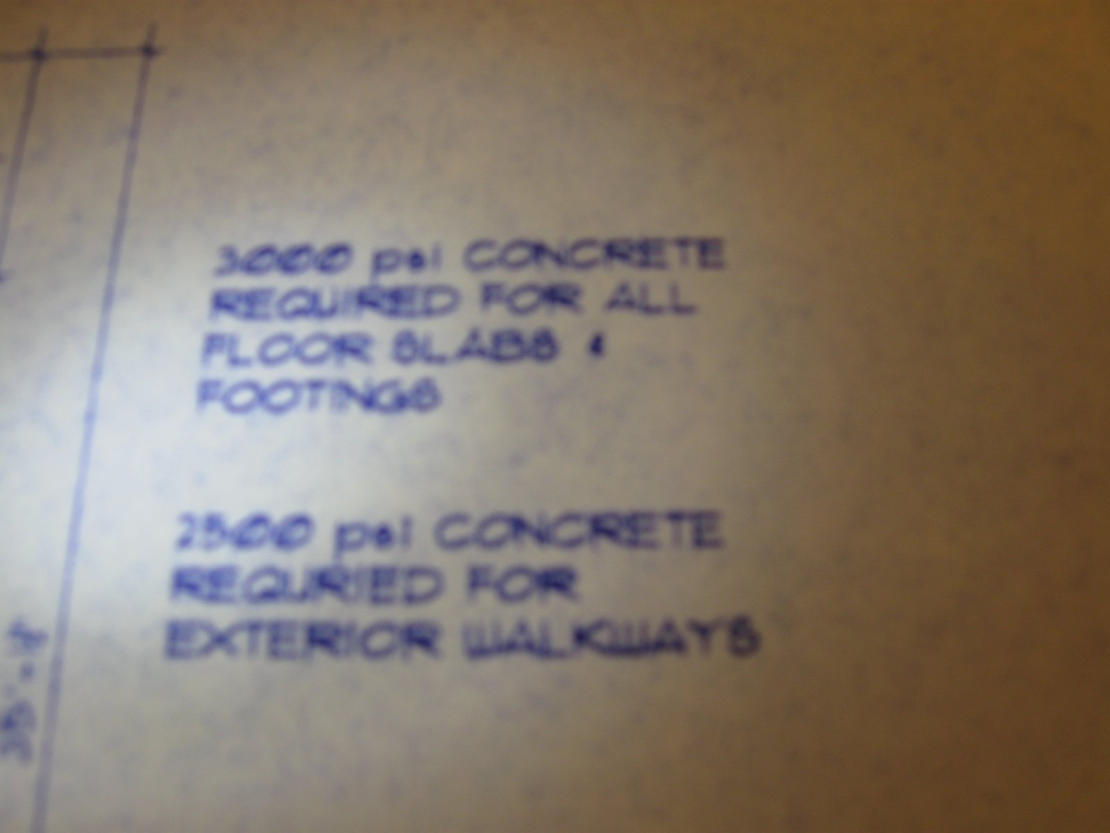

I did not hear what the spec required is but I would assume that the floor would need a certain concrete thickness and a certain amount of rebar to meet a minimum standard to lift and be safe.
View attachment 237770 View attachment 237771
I just downloaded the installation manual because I was curious as well... it says "The floor on which the lift is to be installed must be 4-inch minimum thickness concrete, with a minimum compressive strength of 3000 psi. (Reinforced steel bar optional)"
Yup we got those too. And if you are pouring a new floor and can plan ahead this is the way to go. Spider inserts. (We make these where I work.)

If/when I build another shop, my plan was to weld some thick threaded sleeves to a steel plate in the lift's bolt pattern, then add some heavy angle iron running on both axis to extend the footing and position the plates relative to each other so it's a drop-in perfect bolt layout. Pour 5"+ of 3,000 PSI or better steel-reinforced concrete and it'd be set for anything. I'd add some additional sleeves to the angle iron in between the span and to the footings to have anchor points in the concrete, just in case. You never know when you may need to pull a bent frame.
This is definitely on my radar....
Those are the same minimal requirements for my 10,000 lb. 2-post lift. I've had my neighbor's '07 crew cab 2500 diesel on it at full lift height plenty of times. So, just meeting those minimal requirements for the MaxJax is PLENTY.
