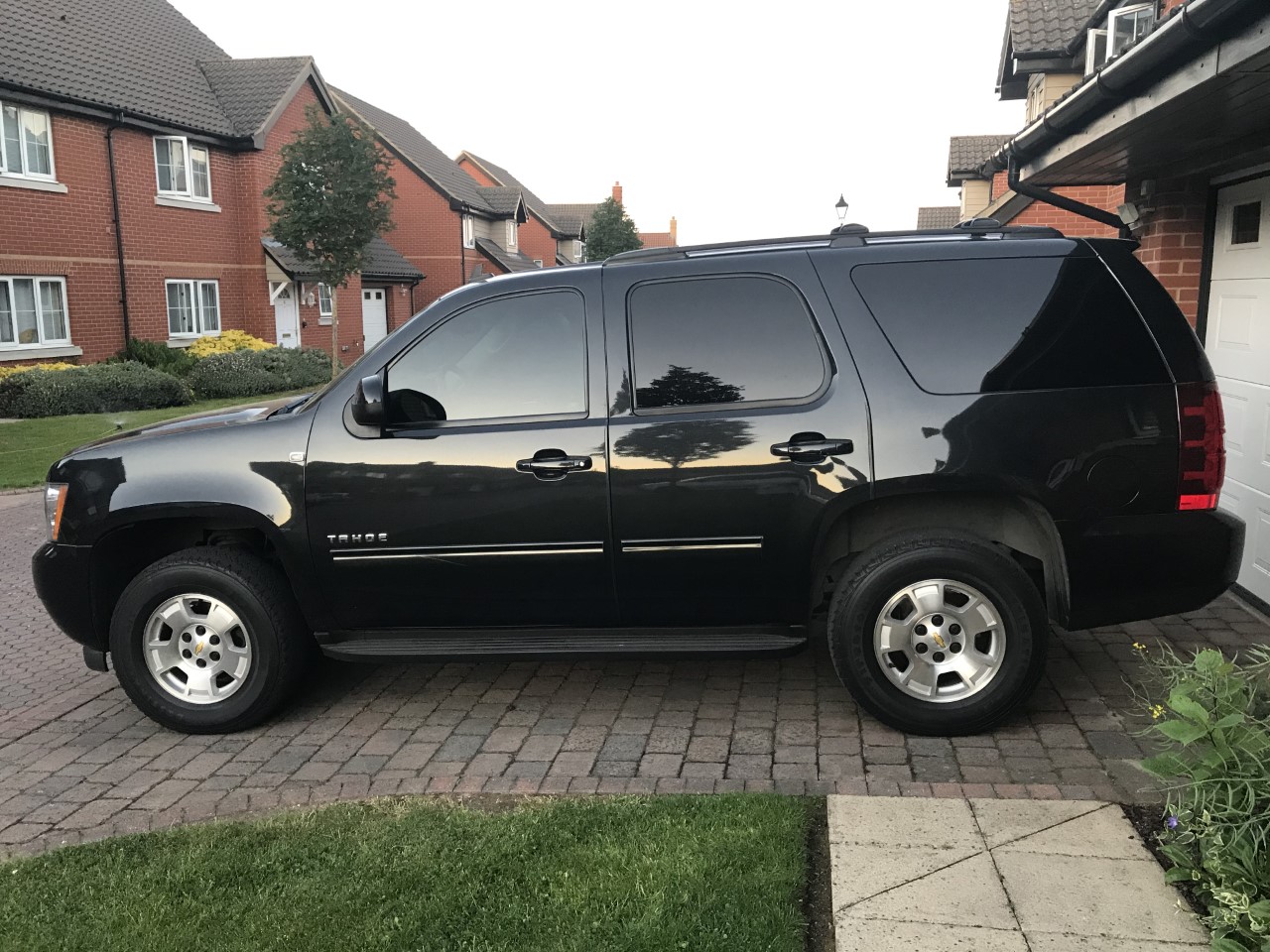

I'm looking to replace my serpentine belt, pulley and tensioner. Anyone have a good deal that may also include AutoZone to replace all 3 at the same time? 2013 Tahoe LSthumbnail_Image.jpg
