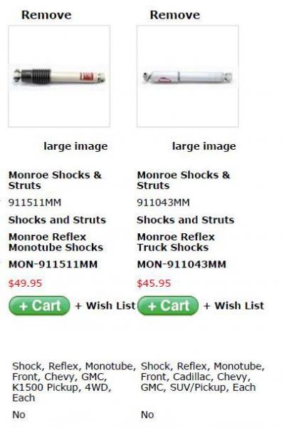

I didn't think that I would have an update so soon, but here it is.
Both of the Monroe reflex front shocks that were just put in are blown. They both make clunking noises, and it rides like sh&t again. If was good for a week or so.
Turns out after some googling that there are two part numbers for reflex shocks that go on our trucks. (Special thanks to Summit Racing webpage to clarify the difference).
When I called up Partssource.ca to order new shocks, I said that I want monroe reflex, they said ok, and soon they were at our garage. Ok, fine.
Turns out that they sent me the 2WD shocks, not the 4WD shocks. The 2WD shocks didn't make it past a week.
It took this long to order in the proper shocks from them. They were installed this afternoon while doing my oil change.
Here is a screenshot from the SR webpage that shows the proper part numbers.
I have no idea what the difference is, but I hope that they last a bit longer than the first batch.
If these blow up, then FI, I'm getting Bilsteins. and then if I end up getting bilsteins, I have the same problem, they have different part numbers for shocks for our trucks. I know that perople here like the B's. But can they tell us what kind of B's they have on? Comfort?, normal?, HD? Part numbers?
