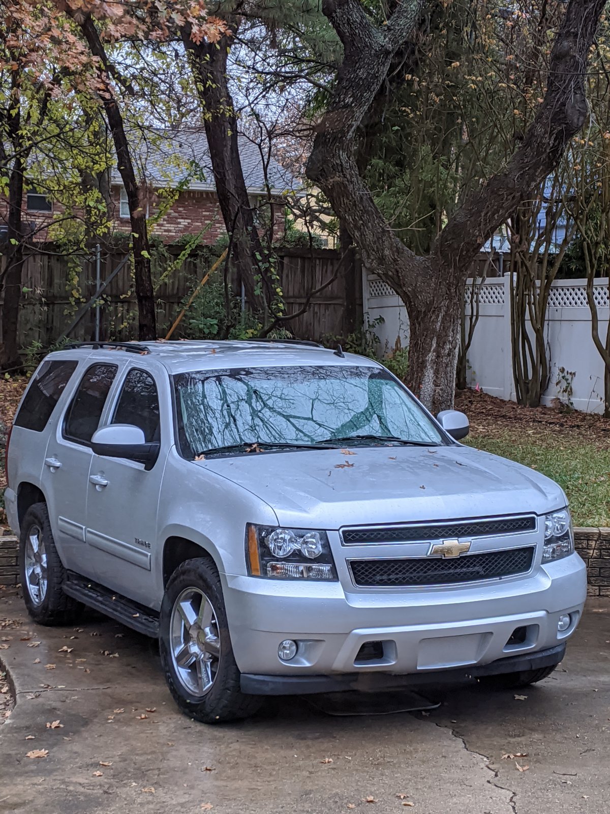

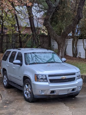

Good job, papa! Looks like a nice ride to keep your family safe.
Oh, +1 for the 6.2 swap.
