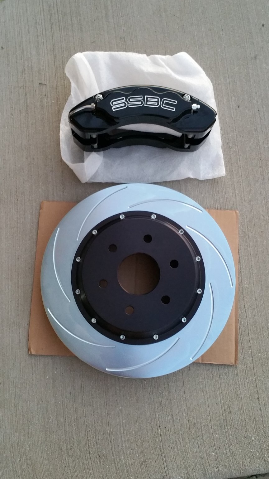

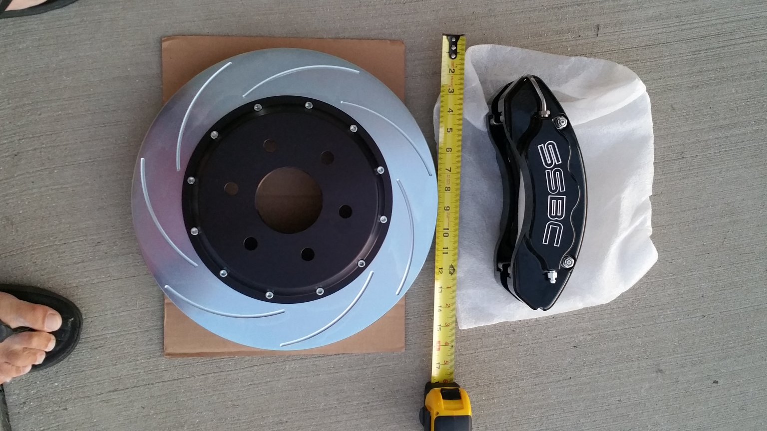

I can't find a description for his anywhere. I'd like to know what caliper and rotor assembly it uses. Would be nice if all my cars could use the same pad size...
I got the part number right from Cadillac's accessory page
Fifty
Jun 26, 2015
814
219
The part number was good. It's just that nowhere (other than summit) would give a description of what it is.
Summit says 6 piston caliper (unknown family of brembo) and a 16 inch (410mm) :0 rotor!

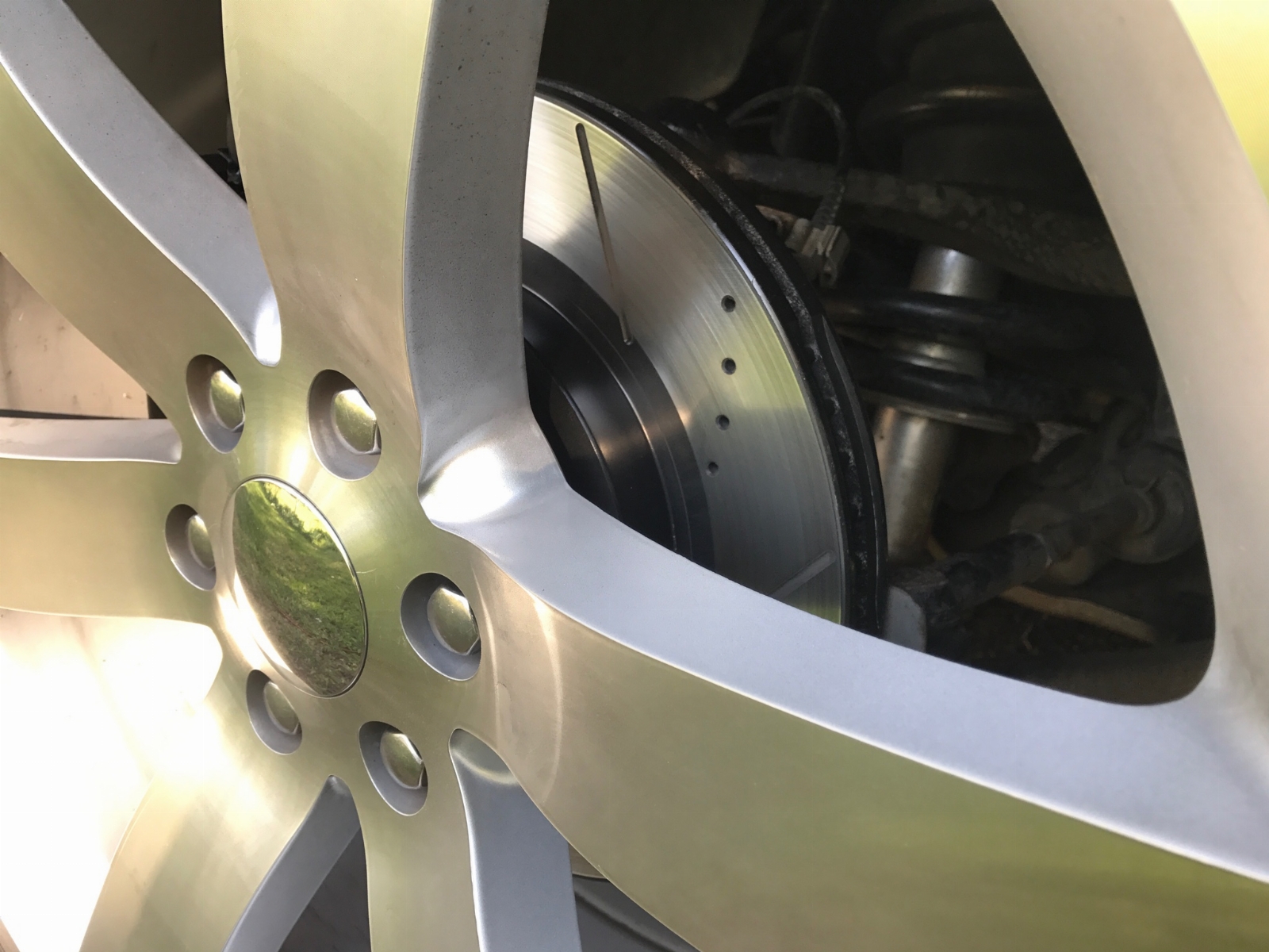

The Powerstop front and rear kit I ordered for my Escalade just came in today and it looks pretty killer. AND it was only $430 on Amazon!
No bigger in diameter but at least I'll have nice shiny (zinc plated so they won't rust) drilled and slotted rotors instead of the cheeseball factory ones. I've used their stuff on previous vehicles and always been happy with them.
Should look decent behind my 24s. I'll post pics when I get them installed next week.
