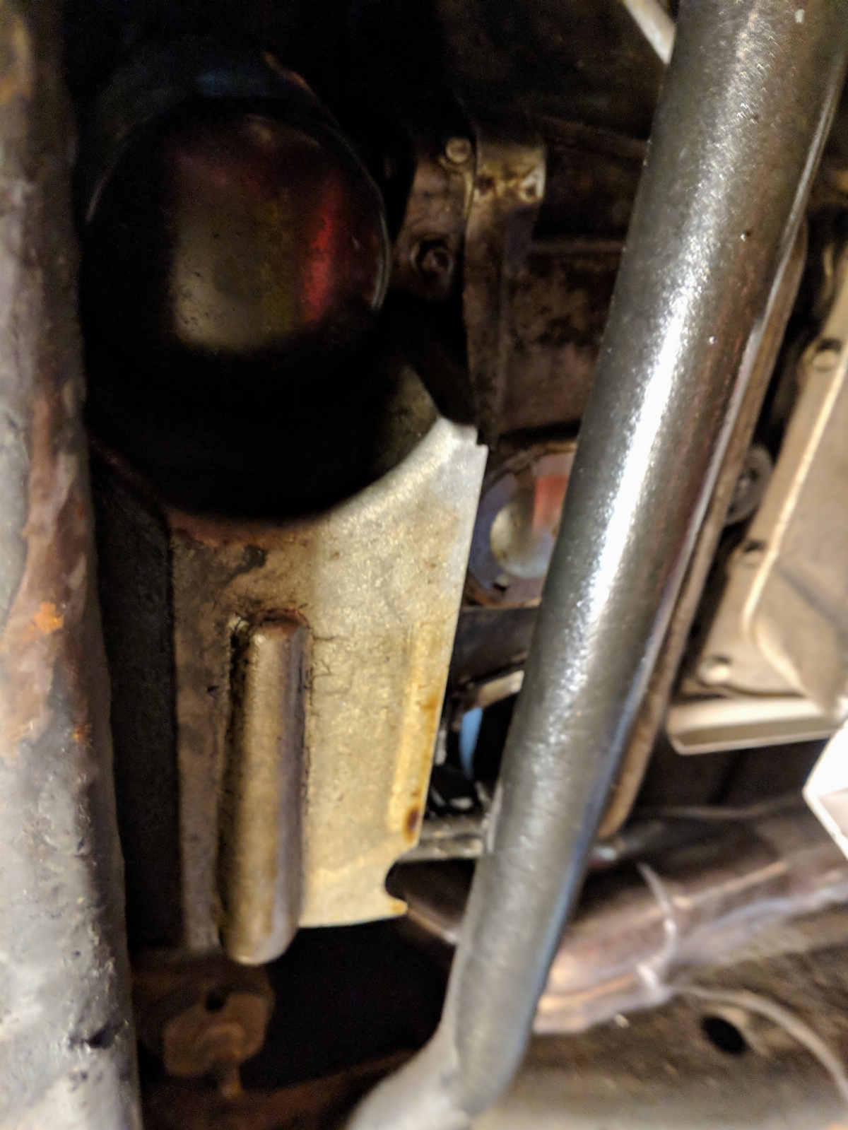

Found my first broken mount today @ 145k. I suspected it but video of the motor trying to jump out and run away confirmed it.
NGAneer
Jan 21, 2014
1,785
1,023
NWGA
Looked at a couple youtube videos but for those who have done it themselves... 4x4 guys, what do you find is the easiest method to get to the engine-side bolts on the driver side? I was looking at all the angles and I'm not 100% sure how to attack it.
08grey
Jun 17, 2012
4,596
725
Bend the heat shields out the way. Jack the motor up some with a block of wood and a jack and use short sockets.
