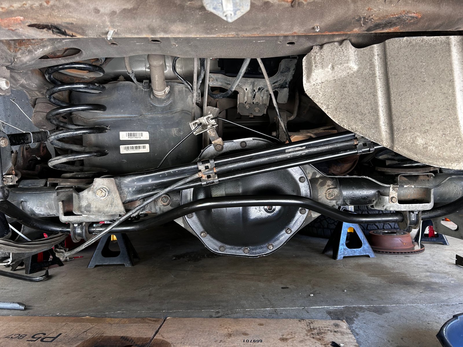

Thanks for the info. I found more damage tonight - the flange that the brake backing plate/parking brake mounts to is bent on one corner. That seals the deal, I'm going to start my return/exchange with LKQ tomorrow and hope my second attempt is more successful. I'll do a lot more close inspection before I accept the next one.
On a different note, since I couldn't work on installing the new rear end tonight, I thought I'd work on replacing the rear u-joint. But I'm confused. In other threads about this swap, guys have talked about having to use a 1310 to 1350 conversion u-joint or switch driveshafts, but it seems like my stock driveshaft already is 1350. All the bearing caps measure out at 1.19 (1 3/16") dia, which is the size of a 1350, and the yokes on the 8.5 and 9.5 are identical. So it seems I could have left my old u-joint in there, but new Spicer on order now. Can't hurt to have a new rear u-joint. Just trying to figure out why some have had to do a conversion and I don't. Maybe they changed the size in the later years of GMT 900? Mine's a '13.
