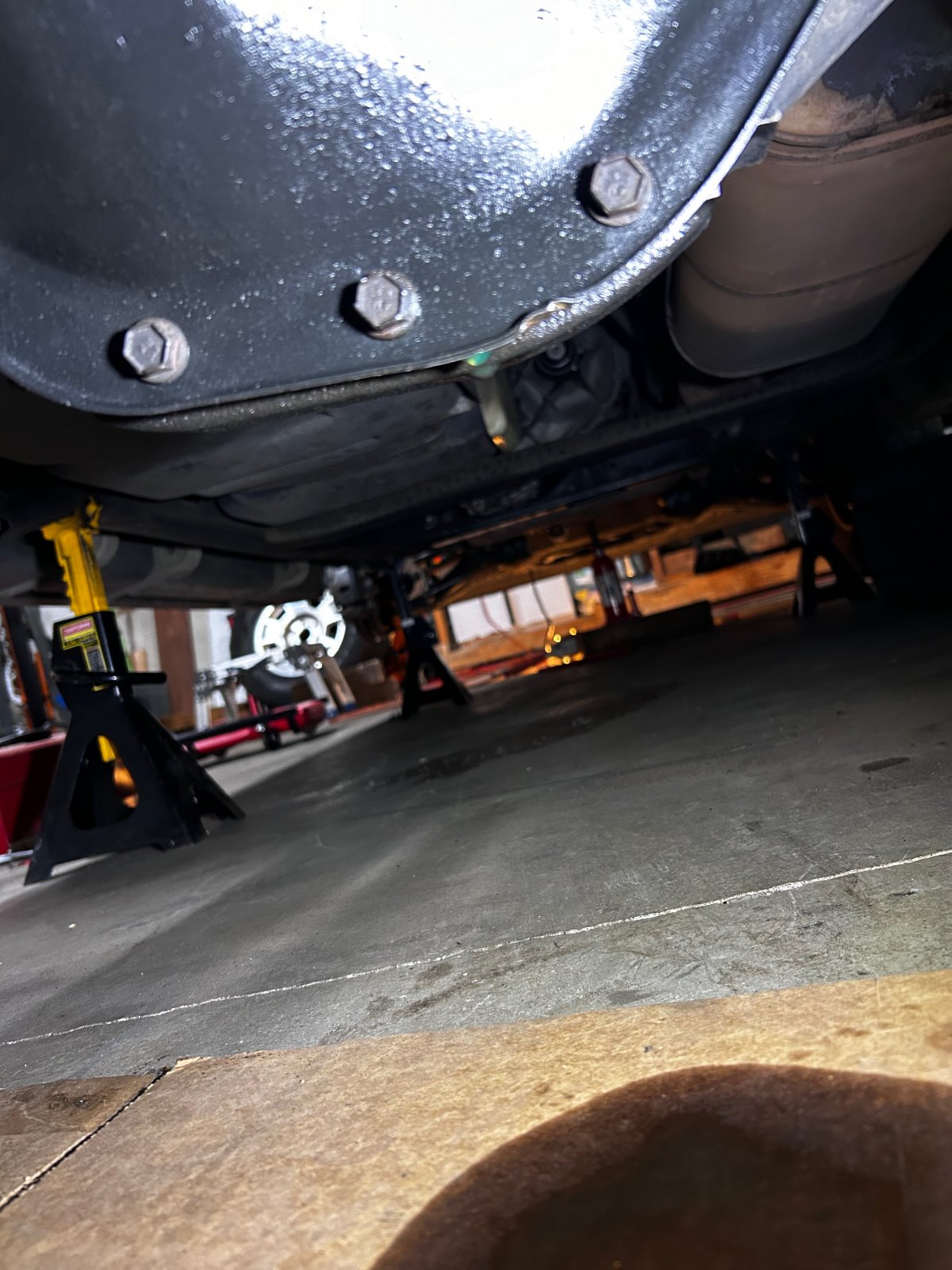

@swathdiver or anyone else: do you know where this hanger goes? Pretty sure it came from the passenger side, but it's not showing up in any of my before pics. There's a similar longer one on the pass side for parking brake cable, so I think that's what it is, but I can't find where it goes.
what (@swathdiver) he said...
It goes under driver side bump stop plate on the inside of the frame rail. You kind of have to get down and dirty there to see it as it threads in on the underside. It steers the brake cable onward and upward immediately after clearing axle tube, on its climb up to it's next point of contact along upper control arm.....

That one goes on the driver's side lower control arm bracket on the axle. It faces the differential housing. You'll see the threaded hole for it.
Got it, thanks. Hanger bracket for both p-brake cables installed now and functional in the bracket for the LCA!
