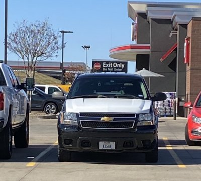

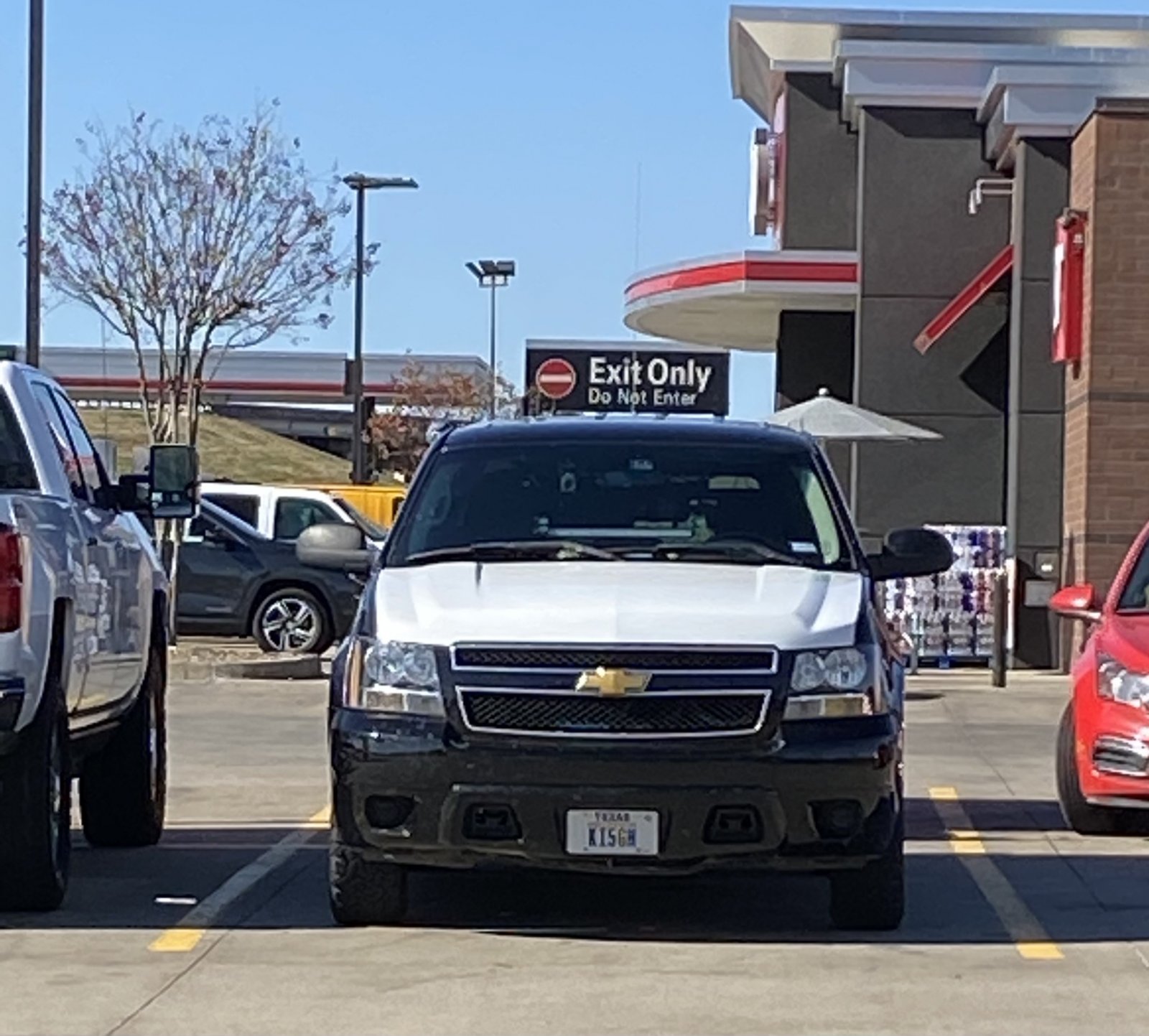

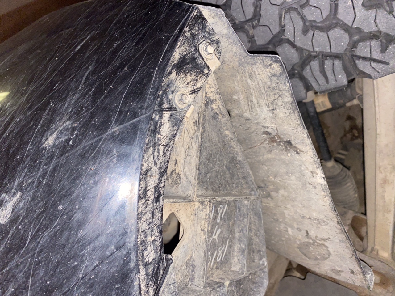

So, of course I did this:
View attachment 267631 View attachment 267632
Some things are just meant to be.
Later I'll be building a recessed winch mount and an offroad bumper / pushbar. I didn't like any of the commercially available options because the winch bumpers all protrude and diminish your angle of approach.
How much else did you have to trim along with the bumper skin?

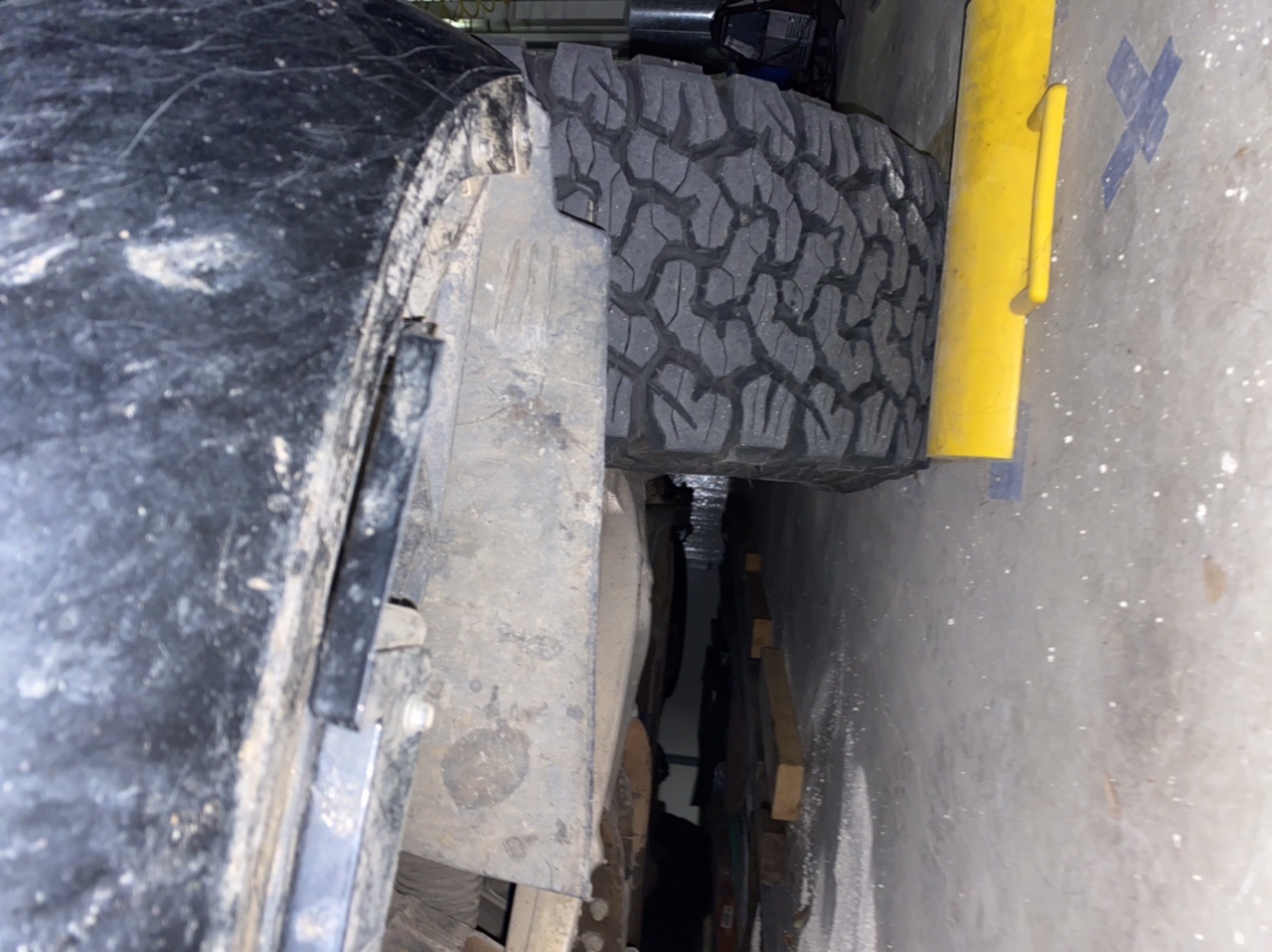

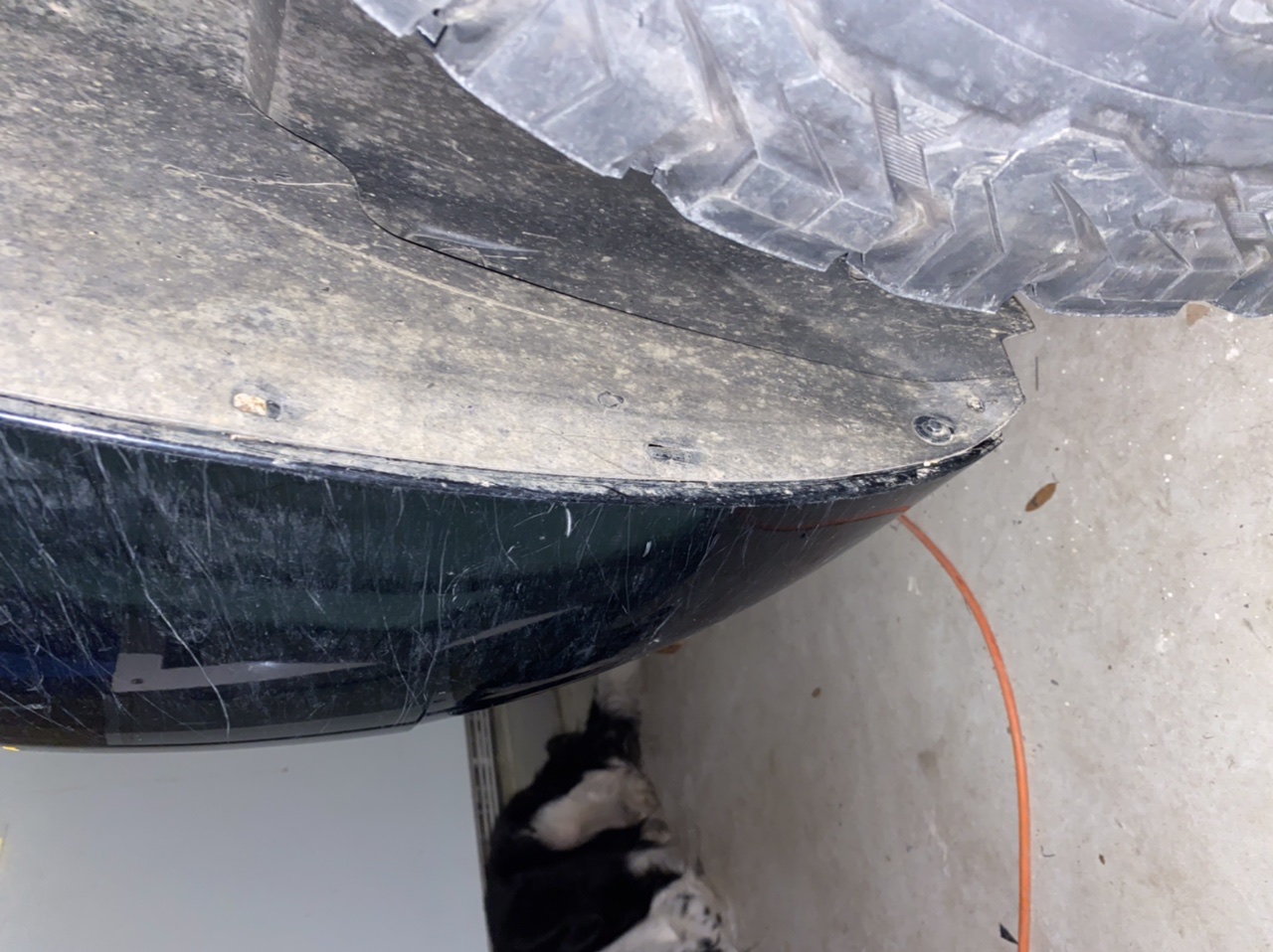

Not a thing. Probably because some of the OEM lower brackets were missing I believe. Looks to me like when it was modified originally they took out some stuff to install a skidplate, push bar, or whatever they mounted on the front.
The new front end they hung on it was only bolted at the top and sides where it intersects the wheel well. Took me all of five minutes to remove the front and ten minutes with a circular saw to cut it along the crease in the bumper skin.
The OEM steel bumper is still hidden right behind the trimmed up skin. Everything I removed is just air dam, basically.

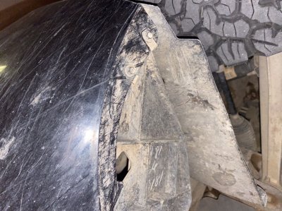

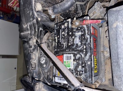

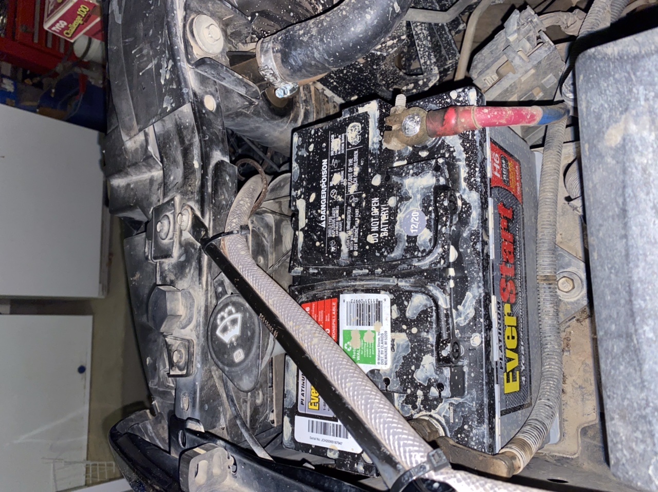

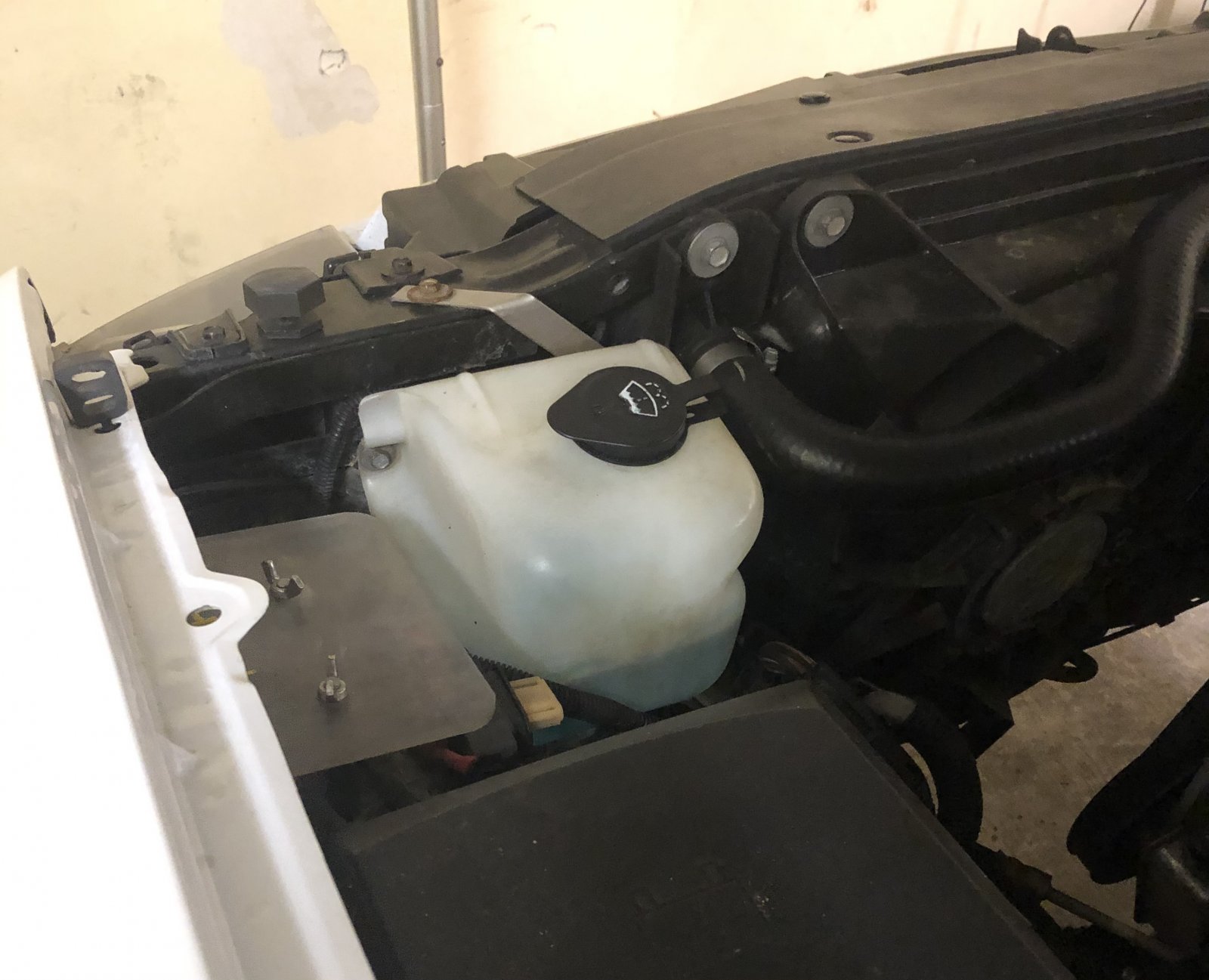

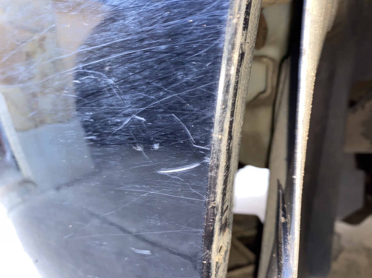

Here’s some new chin pinstripes from my last adventure at new year’s. I had removed the air dam itself months ago. The fender wells are just visible in front of each tire if you’re looking carefully. I’m guessing yours were already trimmed.
The washer fluid tank is one thing I’m curious about as far as doing the CBP trim.

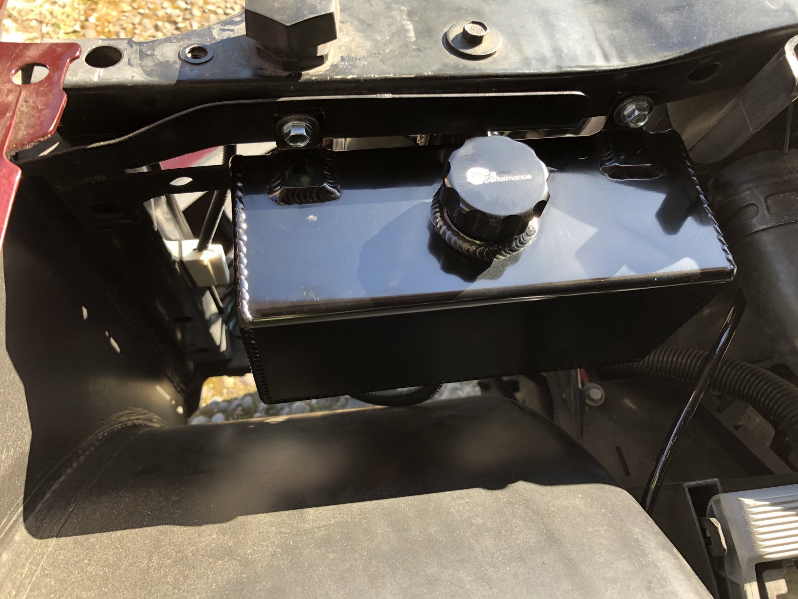

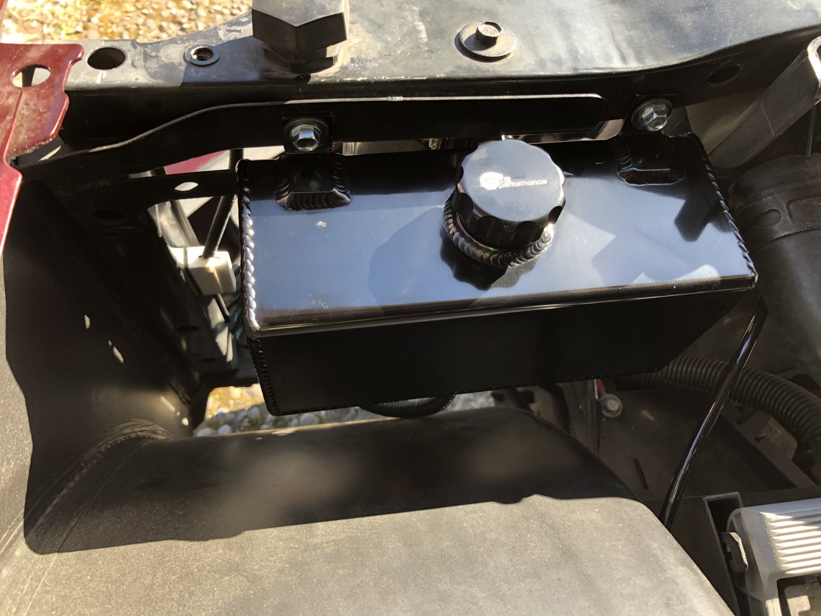

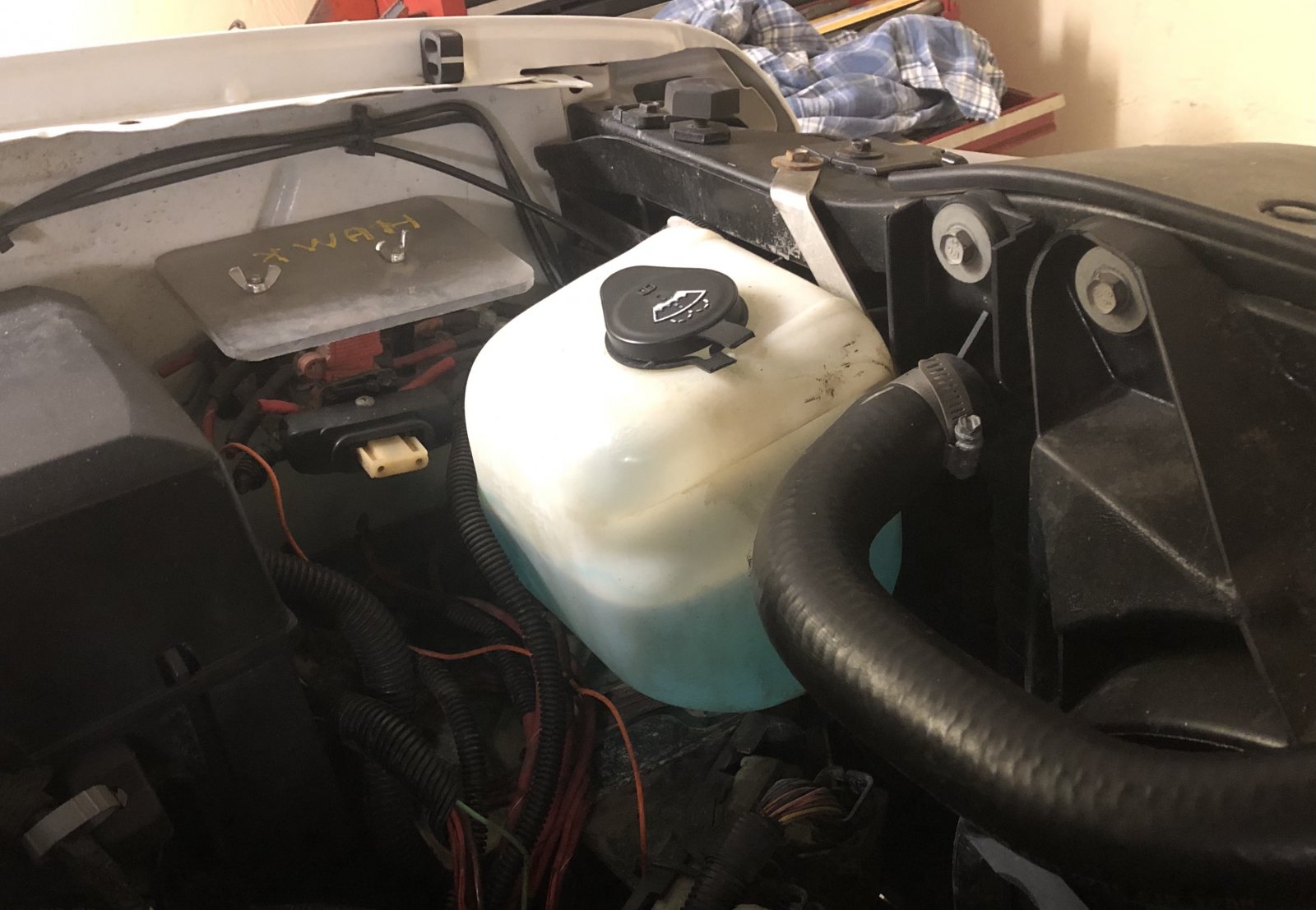

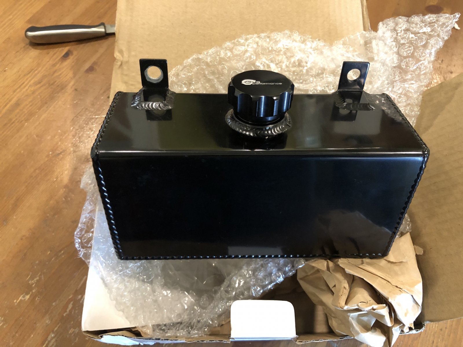

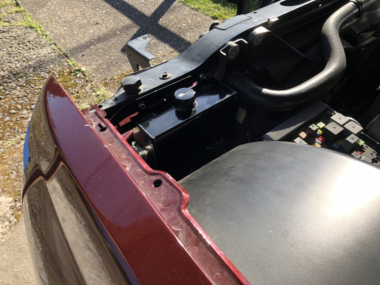

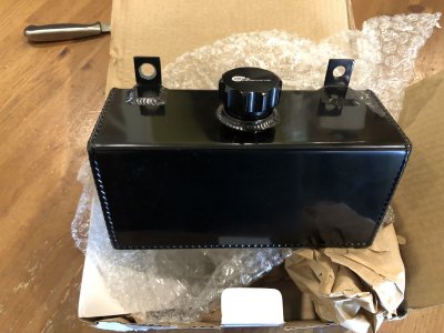

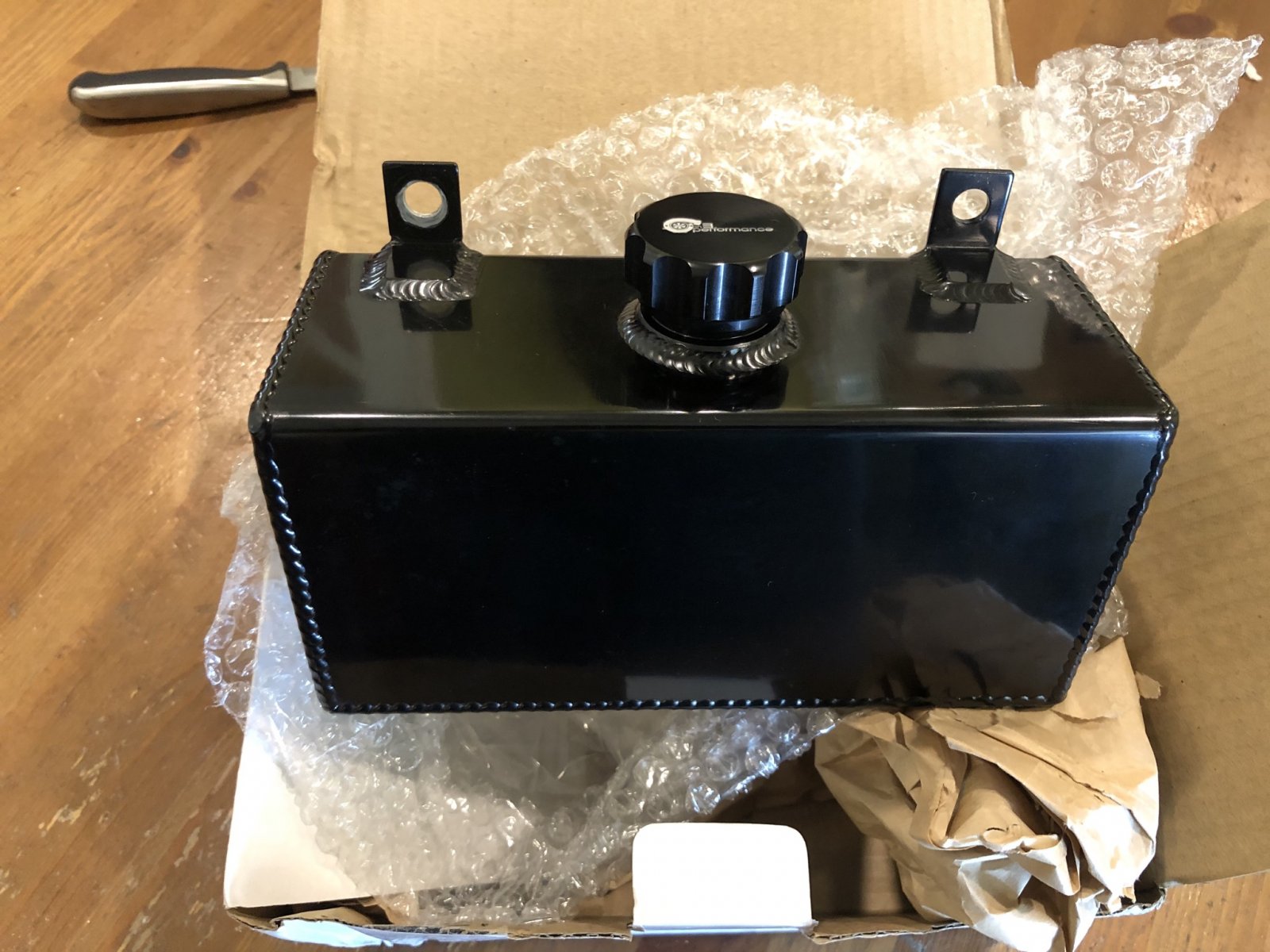

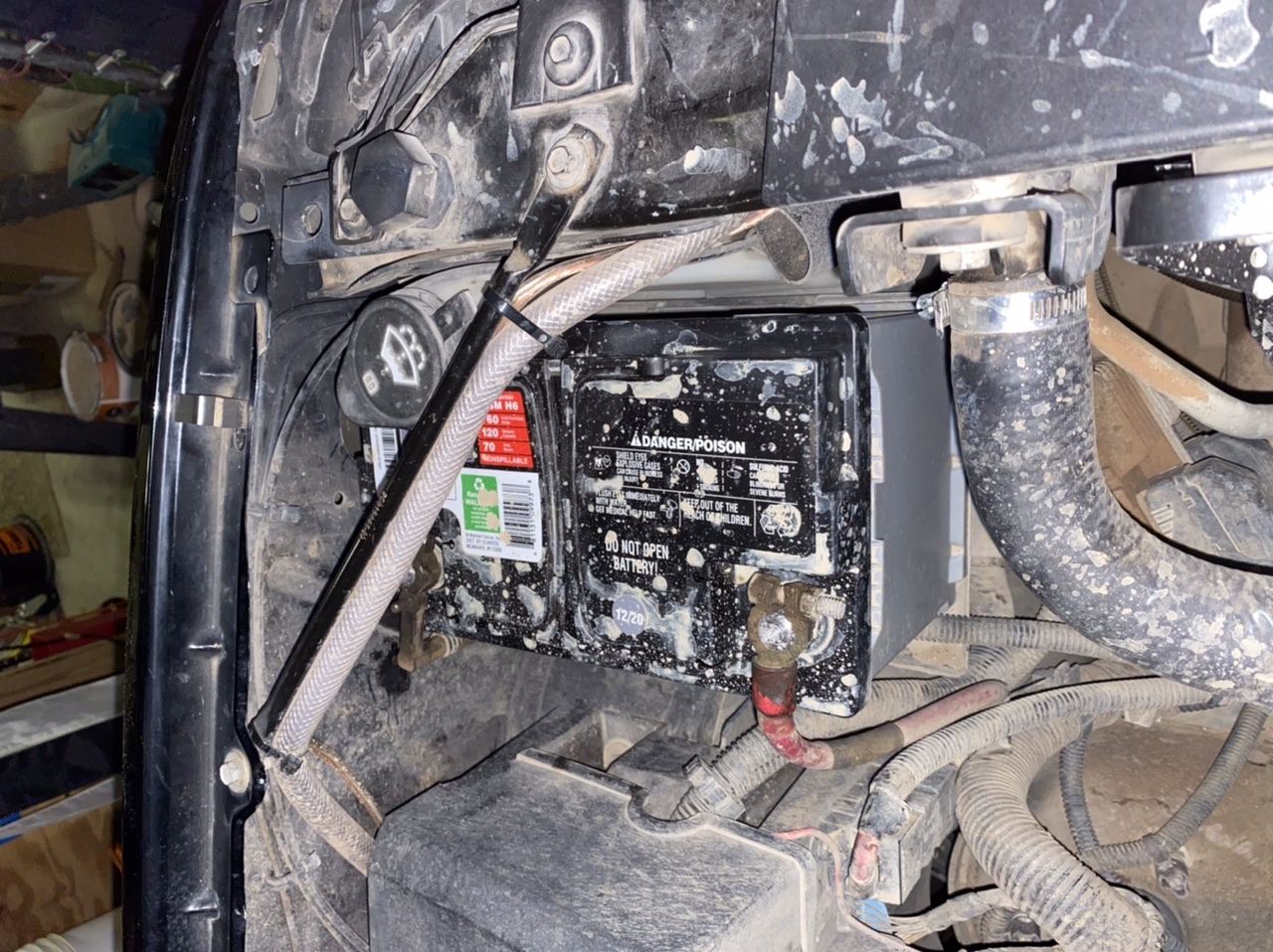

@Sparksalot , I've been curious about where the factory washer fluid tank sits, I'm guessing it's in front of the LF tire like my Jeep used to be before I trimmed on that.
My Hoe came with an aftermarket tank mounted on top of the secondary battery tray. Which I'd like to move so I can put a second battery in. Show me your factory tank and I'll show you my aftermarket. Pics:
E702B54E-E771-4944-B573-0A952B328AA9.jpeg ECFD457C-D8FB-4599-BC48-47ABAD9711A6.jpeg
If anyone needs a part number off this tank I'll see if I can find one when I get around to relocating it for the new battery. In the past I had no problem finding a square aftermarket tank for my Jeep when I cut out the factory tank.
