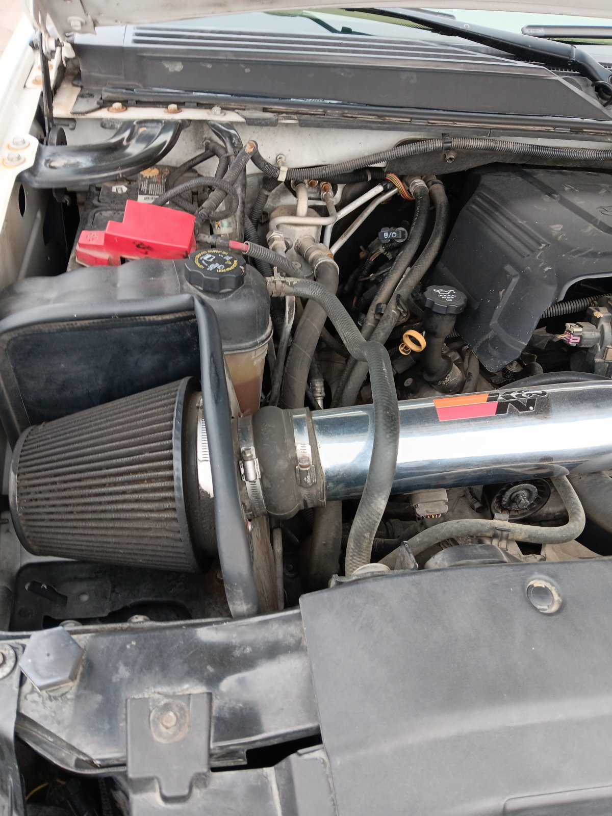

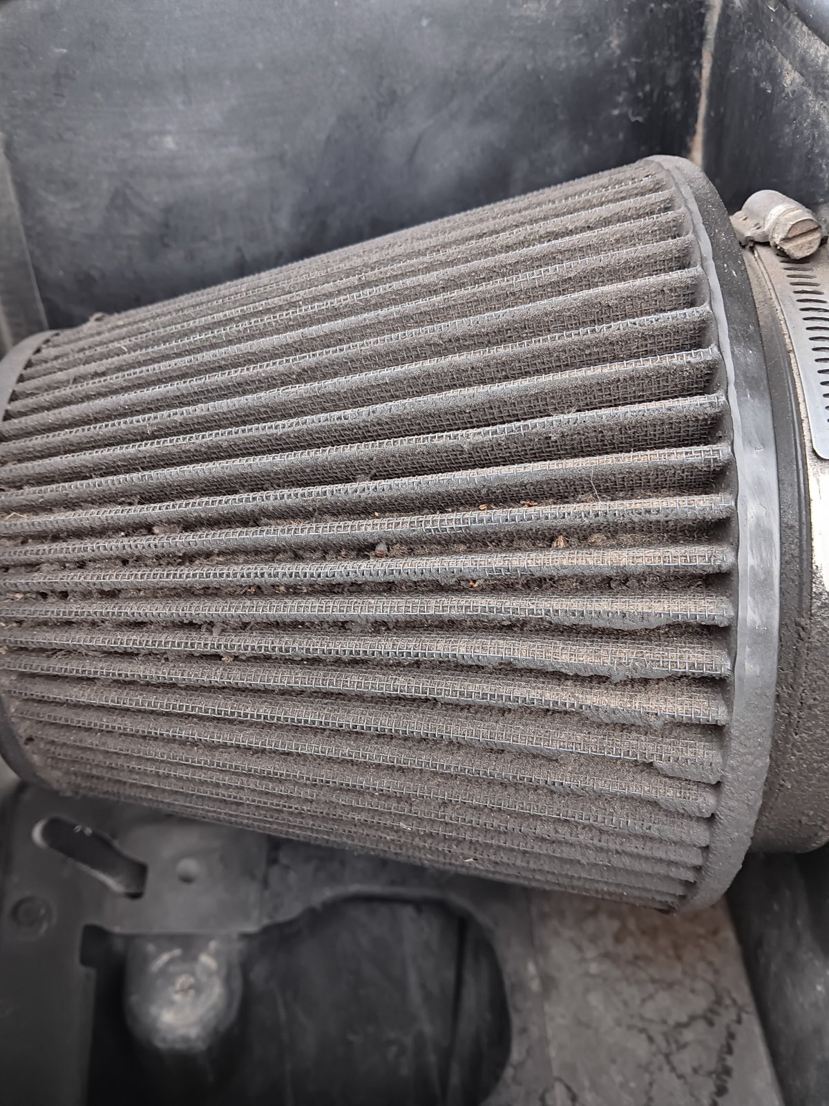

What symptoms and or problems would be fixed by clean the after market cool air/ mass air intake filter when I got it and looked under hood it's filthy

can we get a picture if this air filter?
