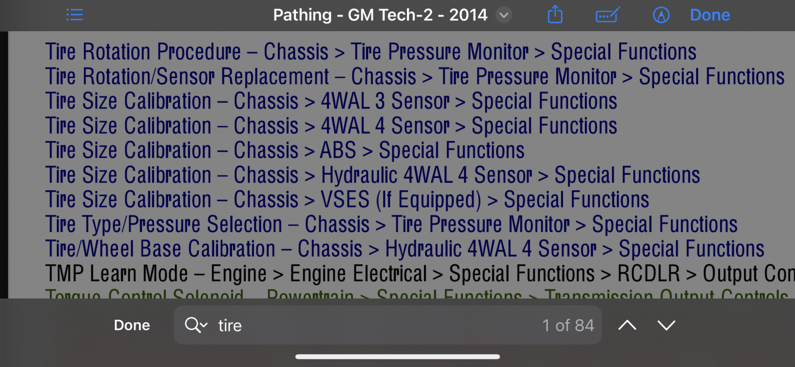

There is no option in the Tech-2 to do so. You can only select the tire type and air pressure in the RCDLR module. I had BlackBear change the tire size when he tuned the Sierra.
Well, I might be wrong as I just seen George's post up there! Check it out and let us know.
I think there are limits to what you can select. I can check on my ‘13.
