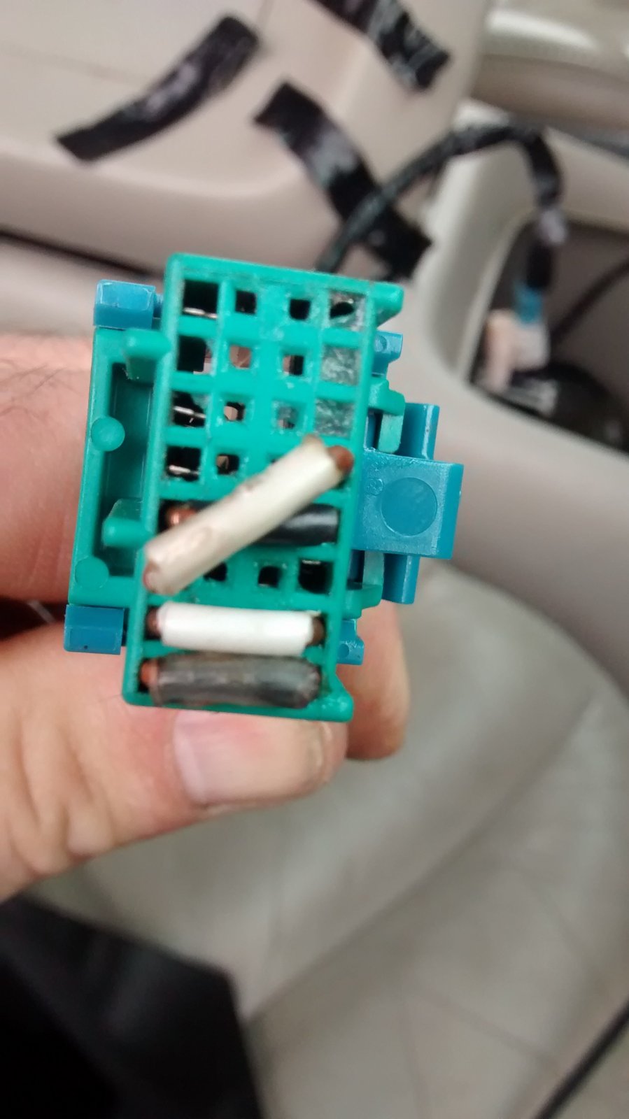

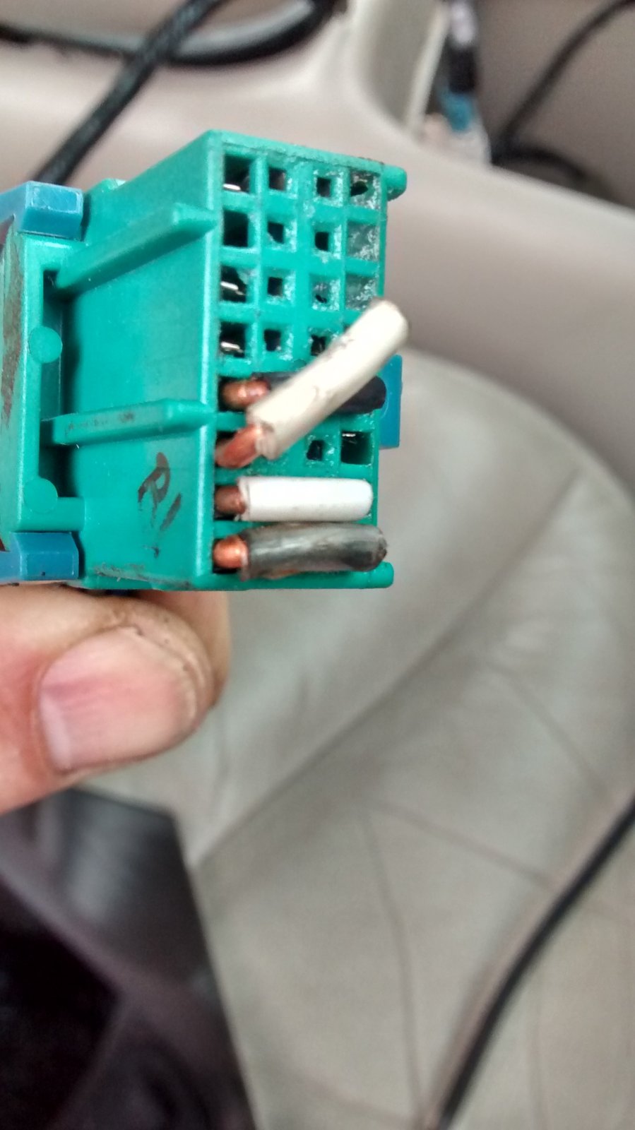

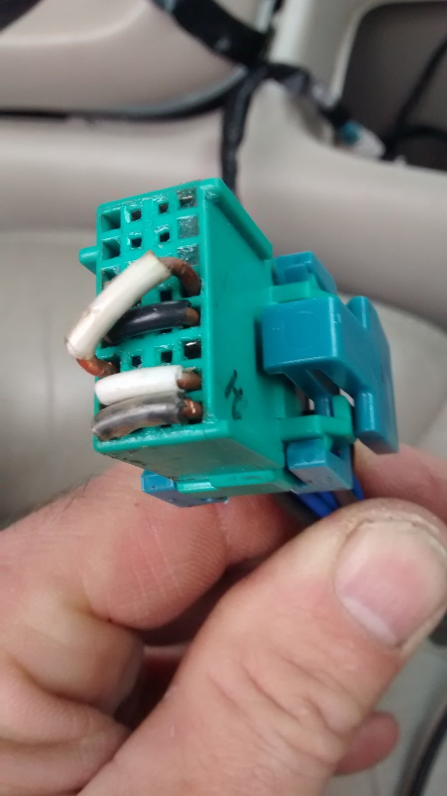

This is the harness I deleted, which is a jumper harness.
Main harness connects to this jumper then routes to rear control back to the radio.
Hey man. I went to go delete mine. After I cut them out I lost all power to my radio and plugs. I have no power coming through them now and I’m guessing Aftermarket got radio fried.

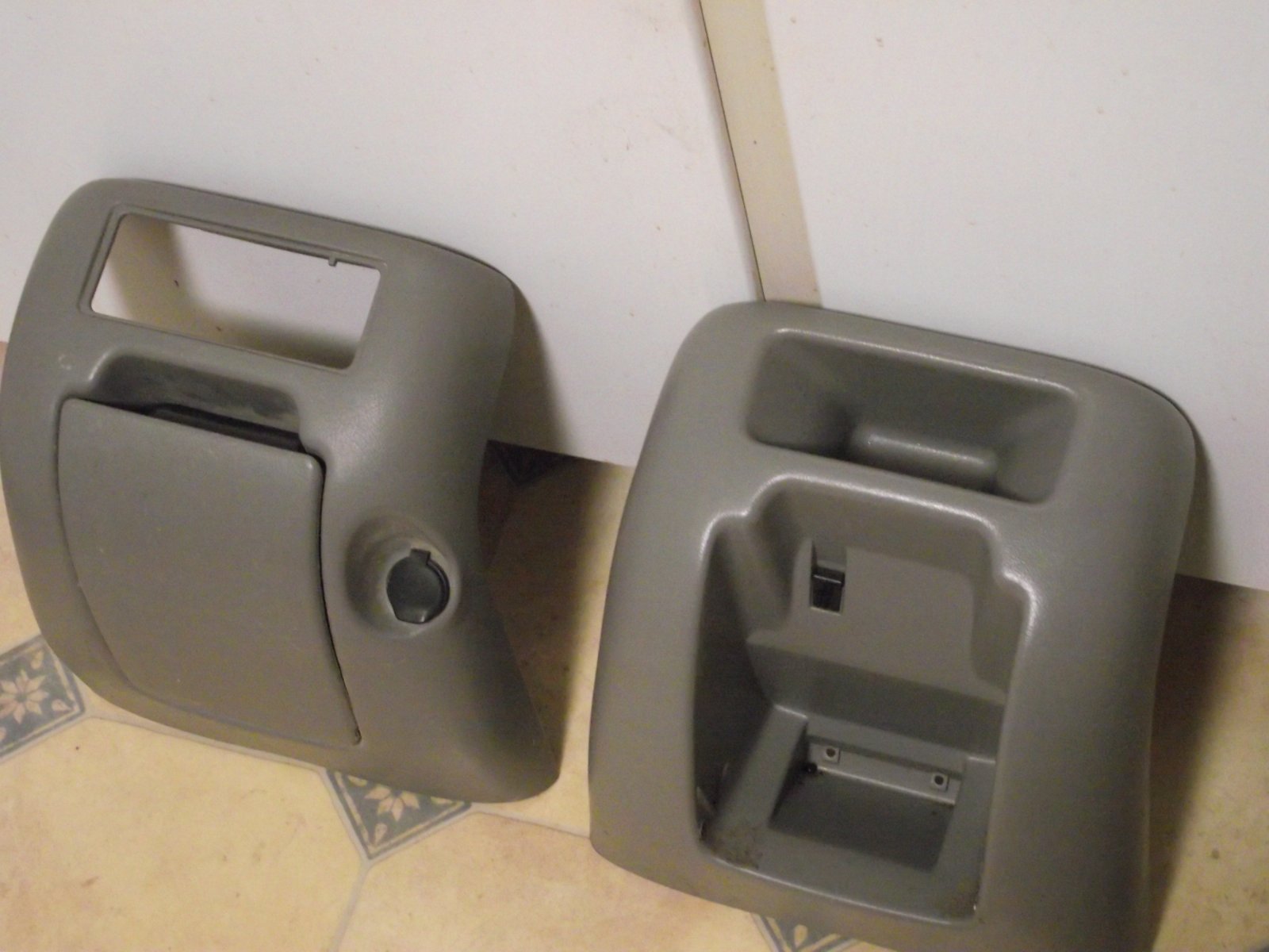

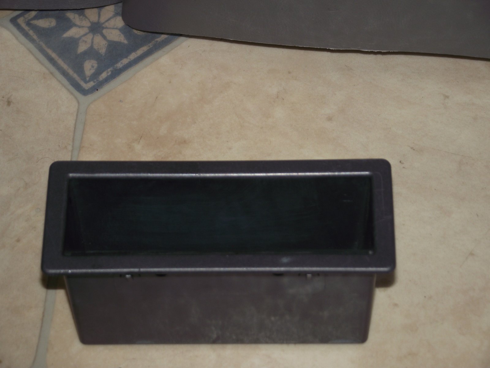

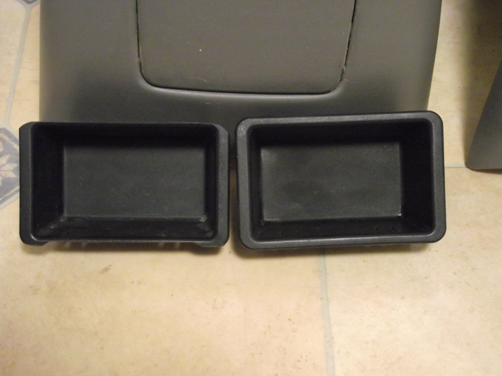

How much you gonna want for one of them storage pockets?
Well, I have several, some grey some bronze some with the rubber insert and some without. I was thinking $6 w/o and $9 with the rubber plus whatever shipping would be.
I will post some close-up photos tomorrow of what I have.
EDIT : lowered price ; $3 each complete plus shipping. But when using Paypal, select the option as sending money to a friend to avoid paypal fees. Thanks.

Just saw this, I still have the harness I pulled out. I'll post up some pics of how I did it. I also just recently bypassed the stock amp and ran my own amp to the upgraded sub in the factory box. Came out really great I'll get the pics up soon.
