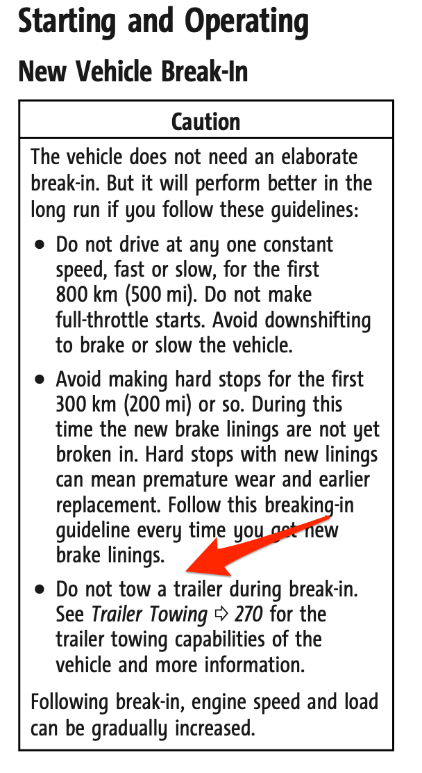

just go to GMC web page, Support, Manuals, and download it. Great reading. I did that for my Tahoe while I was waiting for it to arrive.
I read thru it about 2 months ago shortly after ordering my tahoe the 1st time. I will do it again, after i get home from vacation

Off topic alert! Item two about hard braking. At less than 100 miles I had an idiot turn left in front of me. I was going 60mph. Had i not braked hard, I would have hit him. He barely made it by me
Sometimes you have to do what you have to do to stay safe.
