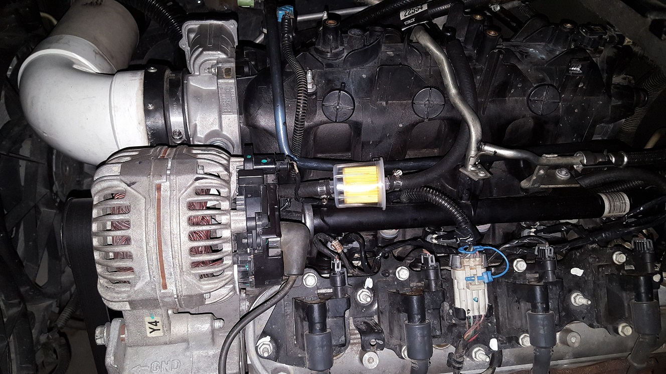

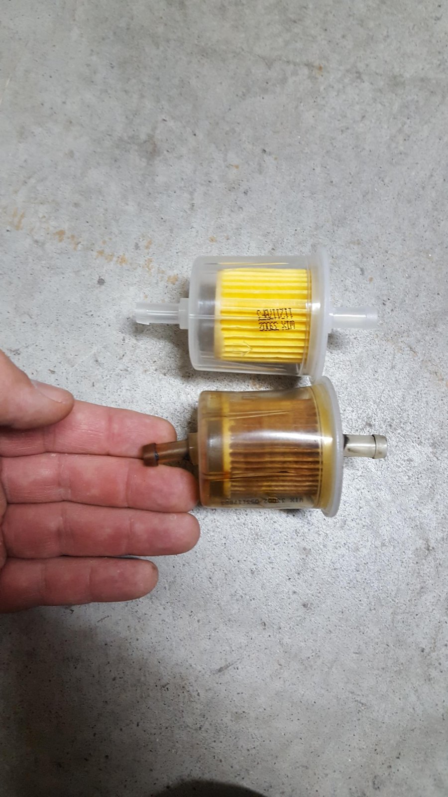

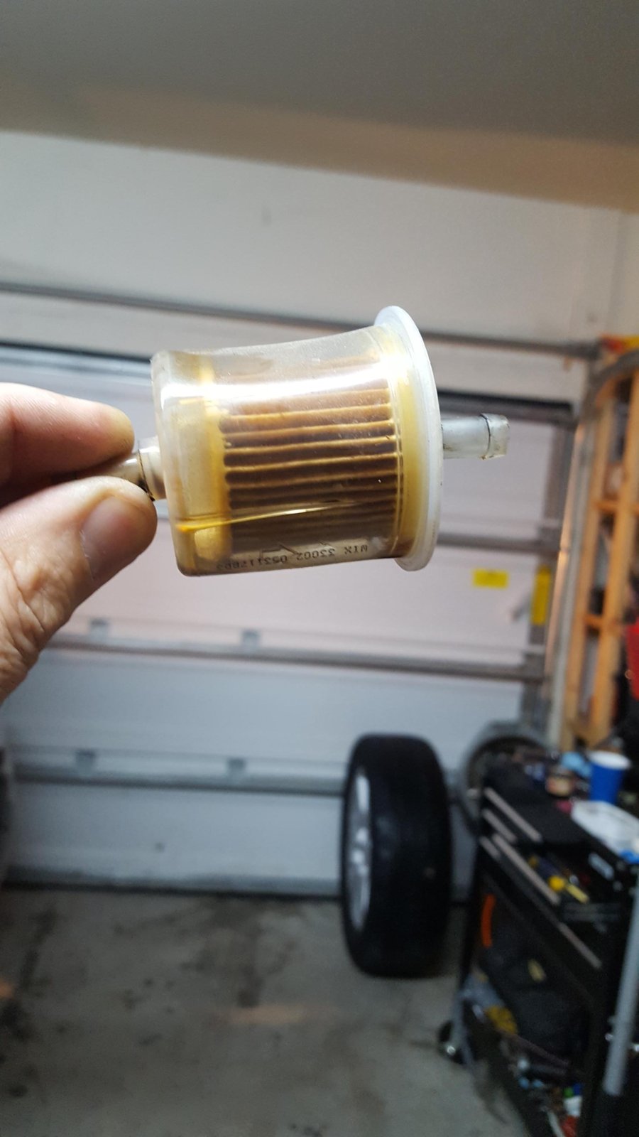

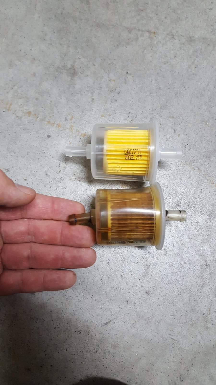

I didn't think about the temperature/condensation aspect, but does it really make THAT much of a difference? Mine's mounted next to the alternator, so it's getting the heat coming off the radiator and up from the exhaust manifold.
For reference, if anyone's counting, mine consistently fills a 3oz. Dixie cup to within 1/2" from the brim over a 5000-mile OCI.

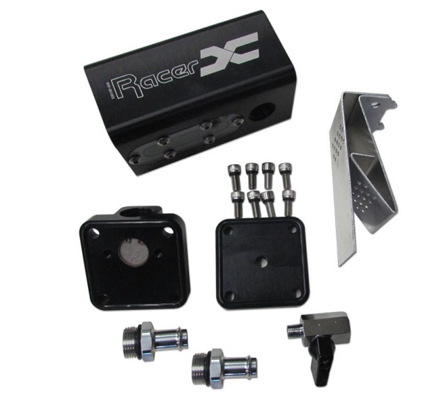

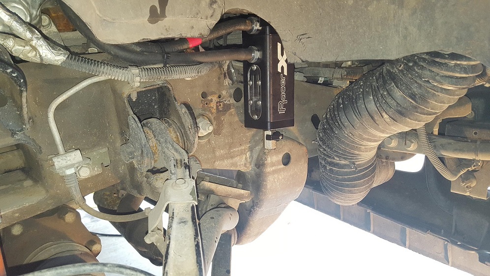

...And here's the design formed from a collaboration with an aerospace company:
https://www.rxspeedworks.com/product/chevy-silverado-oil-catch-can/
