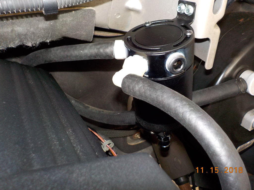

I bought the JLT and the install seemed backwards to me so I checked the instructions for any indication of inlet filter. So in the end I switched the sides so the filter was on the intake side.
JLT is likely correct that the best filter placement is on the valve cover side. However, even with my backwards install, it still collects oil quite well.
44,966
So far, it seems the consensus is to have the inlet hit the filter. That's what the "big brands", which I'd be inclined to believe have put more R&D into their products than the Chi-clones, seem to agree on. But that's not to say that having it reversed won't work, either.
I'm gonna stick to my assessment that make a whole lot of difference, assuming you have proper coalescing media. But, where it would matter is if you're trying to keep something in the engine (like oil) and just catch what makes it through versus trying to vacate and capture something (like moisture). If just oil, inlet goes directly to filter. If moisture, inlet goes to reservoir.
