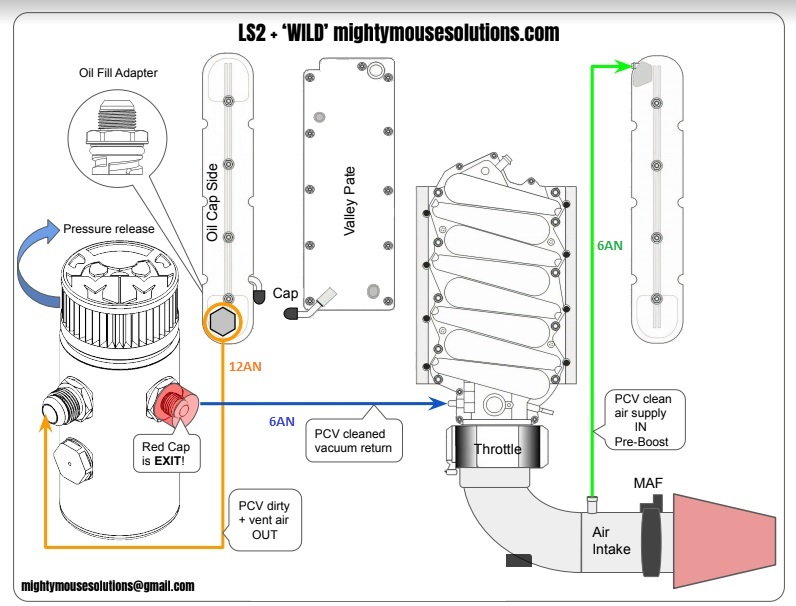

I have a 2019 Tahoe with a 5.3 and a 2.9l whipple. Looking to install a catch can or cans. Can anyone recommend me a good setup and show me how they routed it?

i installed a dual catch can on my 2019, overkill for a no boost engine but not for you!, I mounted the big can off of the radiator core support. There are unused holes drilled and I made a simple bracket. I mounted the second can back by the firewall, took out a retaining clip for the plastic cover and bolted the clean side can back there. I was going to mount them in the 2nd battery area but wanted to keep it open to possibly upgrade to 2 batteries.

Thanks for this! Did you install this on your truck? Could you send pics? I used aluminium 90 degree, drilled no holes . used existing. Painted black. Some people hung this off the brake booster but I heard that the felt vibrations in the brake petal so I avoided that.
