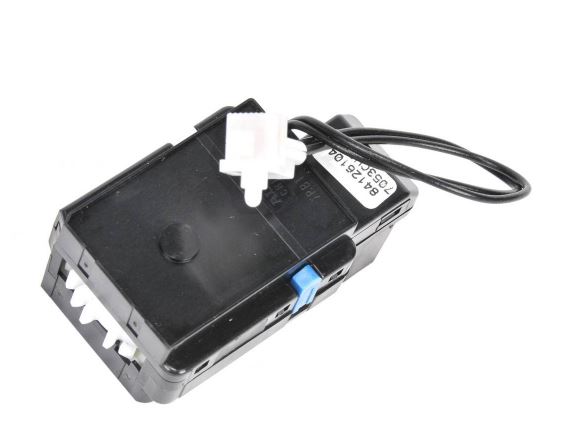

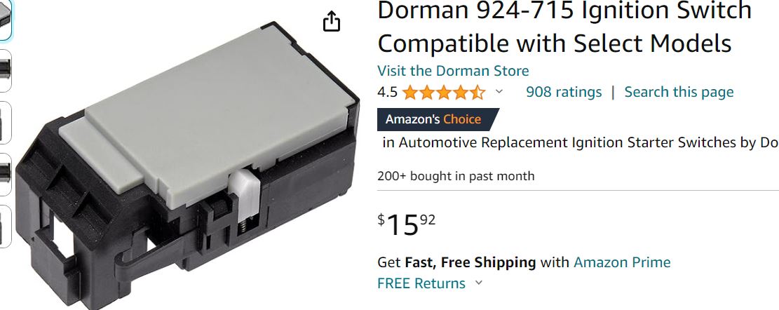

Update. Went to my know good repair place. They sent me to the known good transmission place somewhat near me (San Jose). The guy there looked at the codes and said he is about 99% sure it is caused by a bad ignition module. He said there is a bulletin out on it.
I'm going to have one put in and see what happens.
"Ignition module"? Huh? There's something called "ignition control module (ICM) on the previous generation of engine family, but the V8 LS engines don't have this.
I guess I was also going to say check your fuses to make something isn't blown, but let's hope whatever they change IS your issue.
Interesting..... I don't find any ignition module type parts in Rock Auto.
