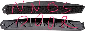

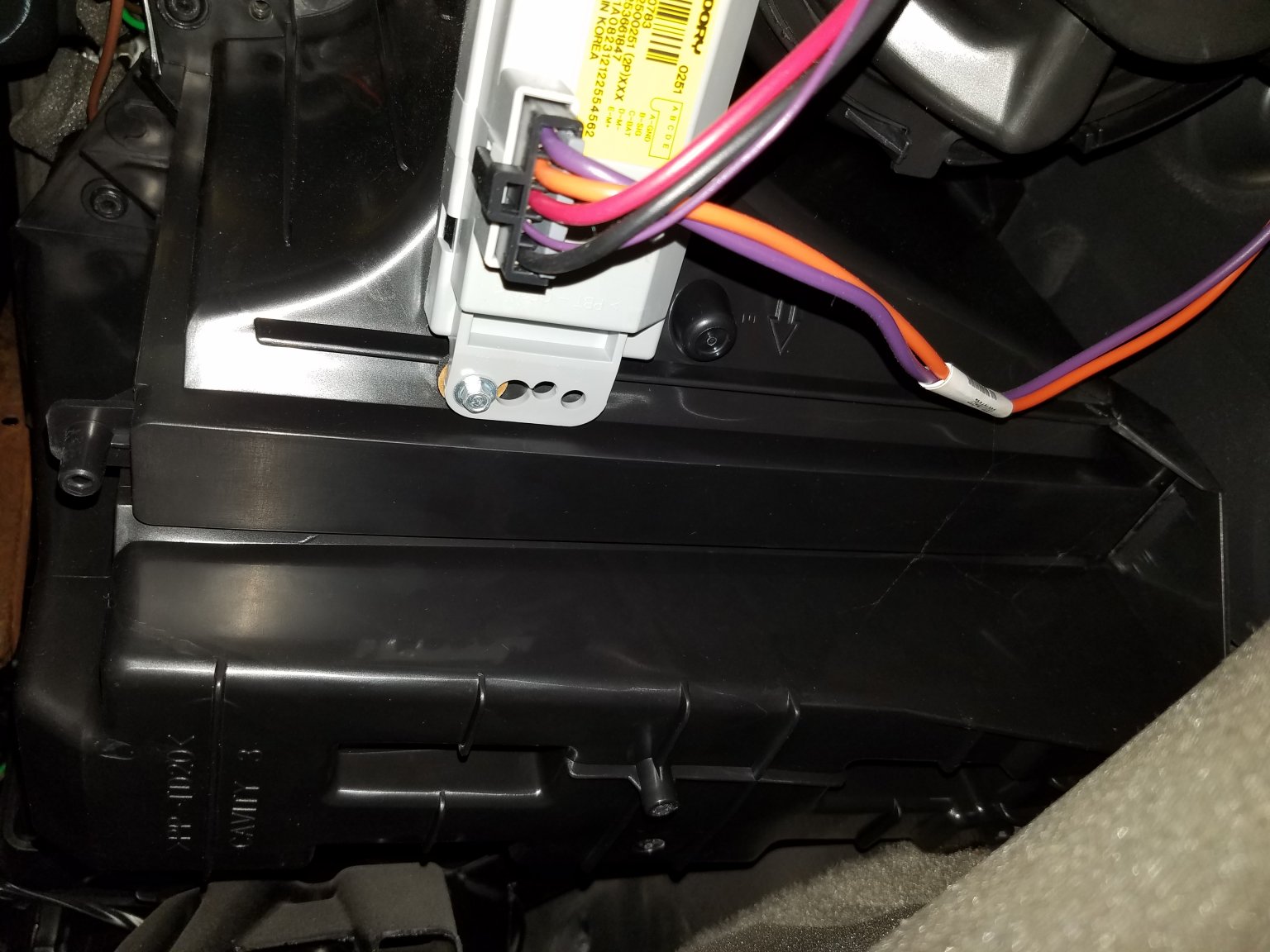

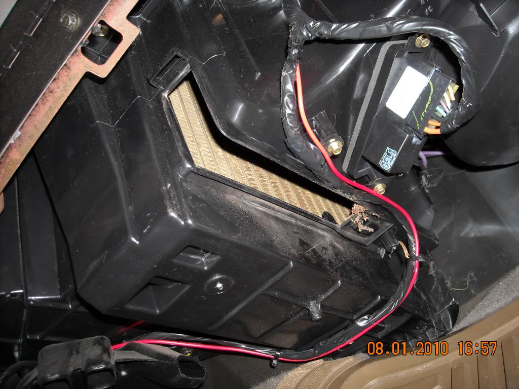

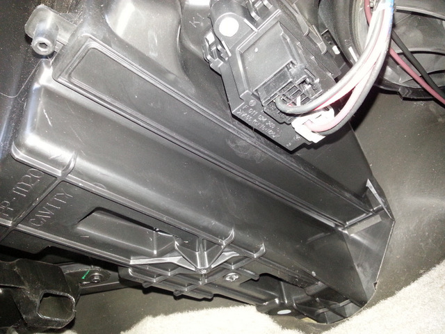

01-03 had them then certain models after that had them. 07-14 did away with them, you can cut into box and put one in....ill find the thread I commented on ... very easy....very easy....sheet rock knife and a door from amazon....amazon sells a kit to do it.... nbs may be a little diff but same principle...they put 2 filters in nbs as opposed to 1 in the nnbs. I put one in my 13 hoe
