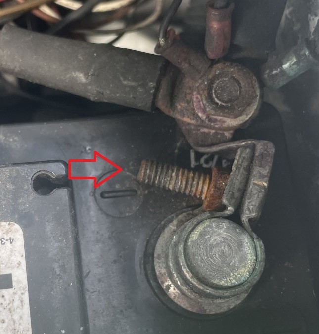

I have the SSV unit with battery in top left and battery front right. Would I charge battery in top left?
Passenger side battery up against the firewall is your primary, driver's side is secondary. Severely drained batteries should be charged with a charger, not your alternator.
Connect the charger to each of them separately. But for starting, you'd want to charge the primary.

If I disconnect negative from primary battery will there still be power? I need to disconnect battery to remove seats
The SSVs have an ignition switch-activated isolator. When the ignition is off, the isolator disconnects the secondary. Ignition turns on, it connects the secondary. If you just turn on the ignition with the hood open (or better, a helper sticking their head over the engine) without starting the engine, you should hear a loud "thunk" of the isolator. It's on the firewall on the driver's side. So disconnecting the primary battery's ground cable should kill the truck.
Otherwise, yeah, just disconnect the ground cable of both batteries.

Anyone know how I can get access to nut? Tried putting socket wrench but plastic on battery in way

Yes I’m trying to slide socket on where arrow is but becomes all cockeyed because plastic is in way. Using 3/8 socket and 10 mm socket

I think I need a different tool I tried sliding a socket wrench on positive side where no issue with getting on but won’t fit on nut. Tried different sizes
