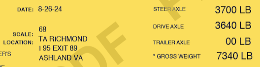

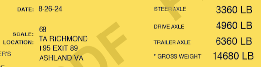

Picked up the camper today and stopped by the CAT scales. Got a reading with just the Suburban with a full tank of gas + me with my father-in-law on board, plus some tools in the cargo area. Then got a reading with the camper hooked up. I messed up though and forgot to put it in neutral without the camper attached, so my steer axle is probably 150 lbs high in the first image. I had it in neutral with the camper attached in the 2nd image though, so that should be accurate. Note that I did NOT weigh it without the WDH bars engaged. Clearly they're not doing much right now, which I expected given the increased hitch height of the 3500HD. Doesn't matter though - I'm not even close to either GAWR, which is 4900 lb front, and 6200 lb rear. Doing the math, the trailer is coming in at the exact same weight as the truck itself - 7340 lbs. Subtracting the trailer weight from the trailer axle weight, I calculate 960 lbs. on the tongue, which is about right with all holding tanks empty.
To all of this, we will add about 500 lbs of kids and dog this Thursday to go camping.
This is great info Geo! Dang, these trucks are heavy.
Not that I want you to be in the same scenario but we had to do a panic stop the other day (no trailer) and for the size, it comes down to a stop FAST. Nose dive is very minimal and you never feel like the truck is on edge. Very planted. +1 for brakes on this thing.
I was re-reading one of your posts and realized you asked how many miles we have on our truck. I think we are at 73k or so. Have a few small things I will be doing over the next couple months, will be doing an oil change when we come back from SC next week. Will top off/check fluids as I am coming to a conclusion the dealer did not check these… and will be order the trans dipstick mod + Rancho xl9000 shocks. I have been going round-and-round on shocks and with the warranty they offer. They seem to be hard to argue with since they are able to be adjusted soft/firm + price point. Full set from Rock Auto is $350 or something. If someone has a VALID point to make as to why NOT to buy them I’m all ears but this is a Burb3500 thread NOT a shock thread. I have been reading up on these vs Bilstein and both camps have extremist opinions.
