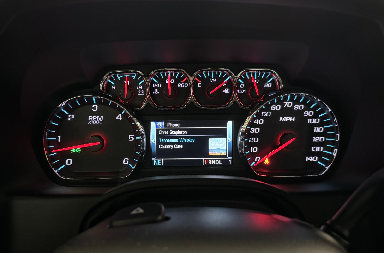

Got the Denali cluster installed today.
Before:
After:
Mileage came over correctly. However I haven’t been able to get Apple Maps to work on the navigation screen via either wired (direct) or wireless CarPlay (with adapter). Album art comes over but the playlist names don’t. Seems to get more data the longer it’s connected and running so we’ll see if anything changes on our next trip.
I did not install the HUD gear yet.
One thing I love: tow/haul mode displays the transmission temperature in place of voltage.
Going to hang on to the original cluster for a few weeks at least to make sure I like this new one.
