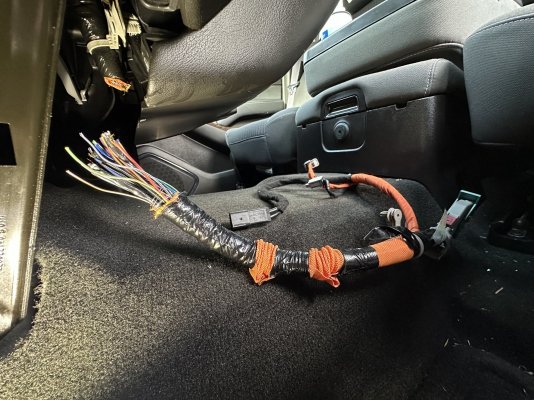

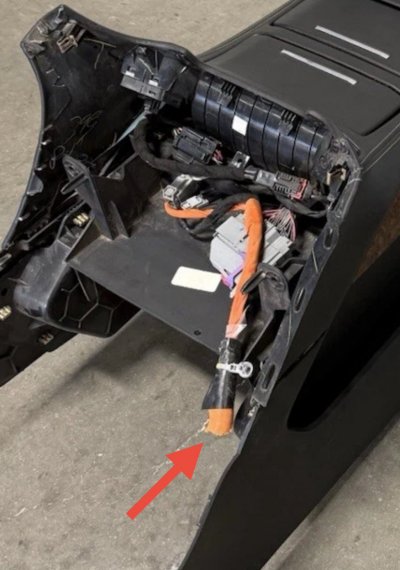

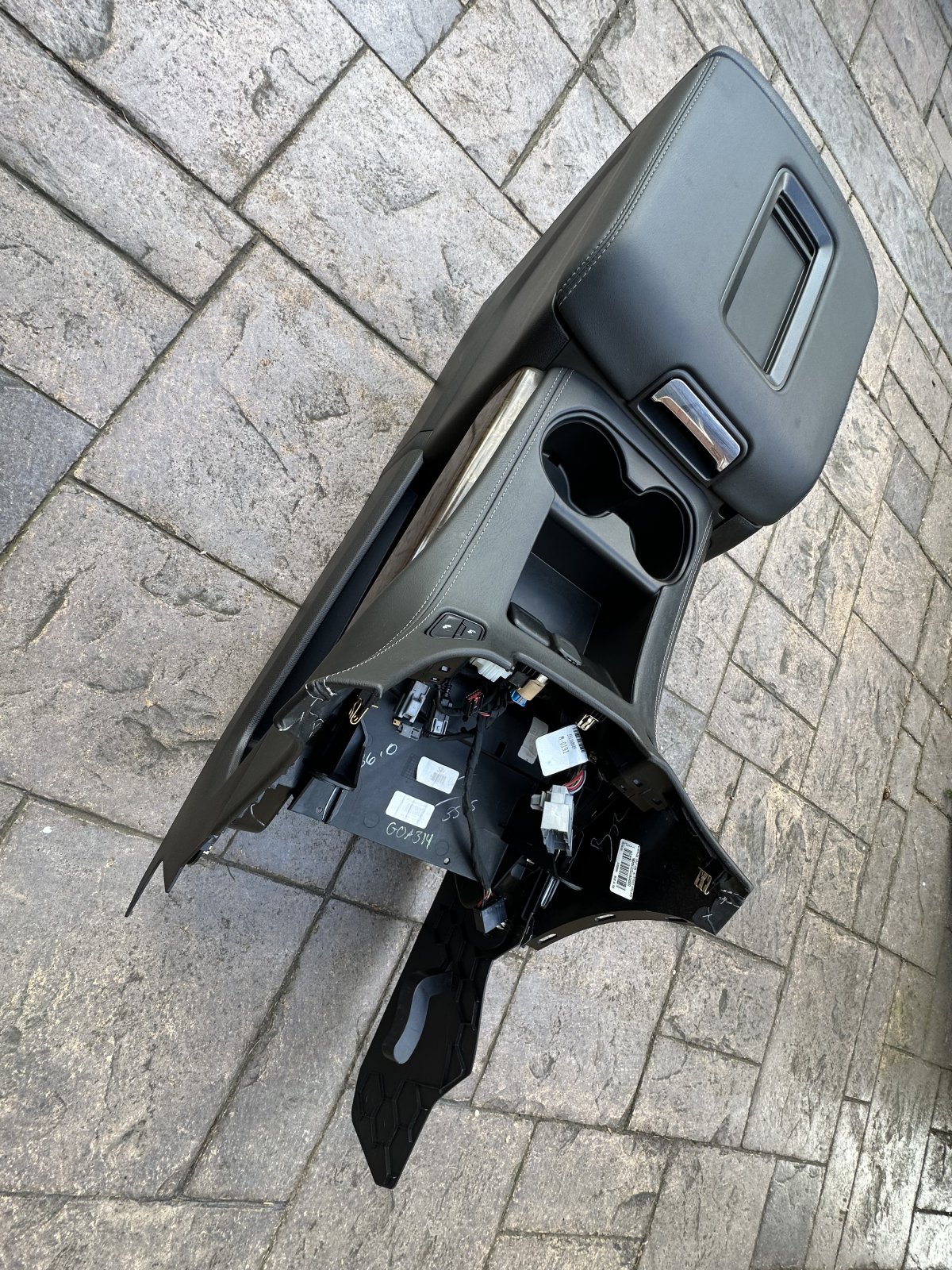

Team, appreciate all your help. I have not given up and think Im getting somewhere. Found some photos of what my cut harness is to look like.
Basically what I see is my Harness that was cut has plug or plugs (connectors) that go from Dash to Jump-seat or Console.
Now I just need to find part number of harness that goes / fits my 2016 Suburban 3500 HD LS.
Please see attached photos. Looks like the same cut on mine. They just cut it when removed.
How do we look up part number for this harness and know if it will fit my Suburban.
Great find on that! Now. This is where is becomes easy/difficult…. I would not look for 3500 specific part numbers, look for Tah/Sub/Yuk parts as they are MUCH easier to locate. Our trucks are pretty much identical when it comes to this kind of stuff.
Might just want to search for “console wire harness” and start there?
