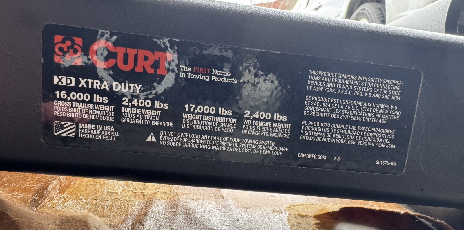

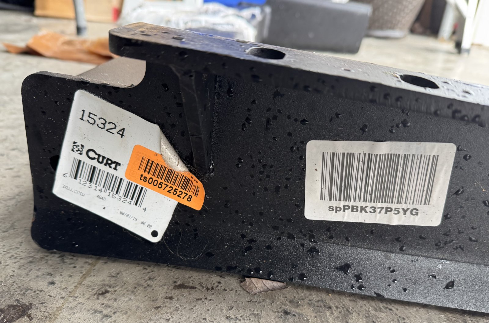

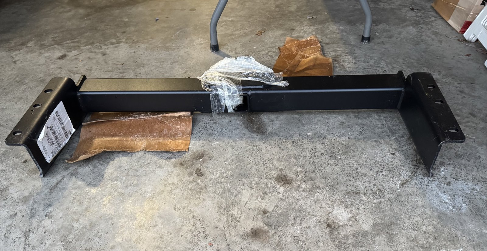

For those not following my build thread, I learned from another 3500 owner what the correct hitch is for these if you want to go to a Class V:
Picked up one from a local guy on FB today. He had a Suburban 3500 but sold it a couple of years ago. $100, delivered to the Wawa close to my house this afternoon. Heckuva deal.
It’s a bolt in replacement for the factory Class IV hitch but as you can see, it lacks the holes for the electrical socket and the spare tire hoist.

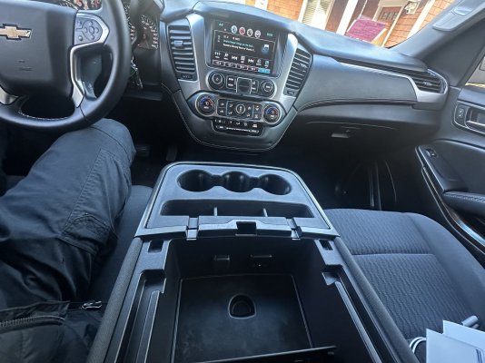

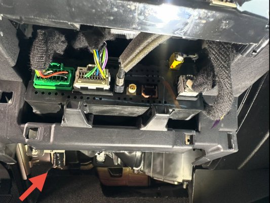

Hello All, recently purchased 16 Suburban 3500 LS. It was a homeland security vehicle. Wire under radio dash is cut. Everything works as it should except the USBs below radio and in the jump seat.
Does anyone have a photo of what this is to look like or know what this goes to?
I have searched this forum and the web but can not find dash and consul or jump seat wiring diagram.
Please help. Thank you all.

Welcome to the family! Looks awesome! I have an alldatadiy subscription for mine (highly recommended) and there are complete wiring diagrams there. I don't have any photos of that area in mine because I haven't removed those pieces. Might also want to check the GM up-fitters manual.
Anyway, here's the schematic for the 2018 Suburban 3500.

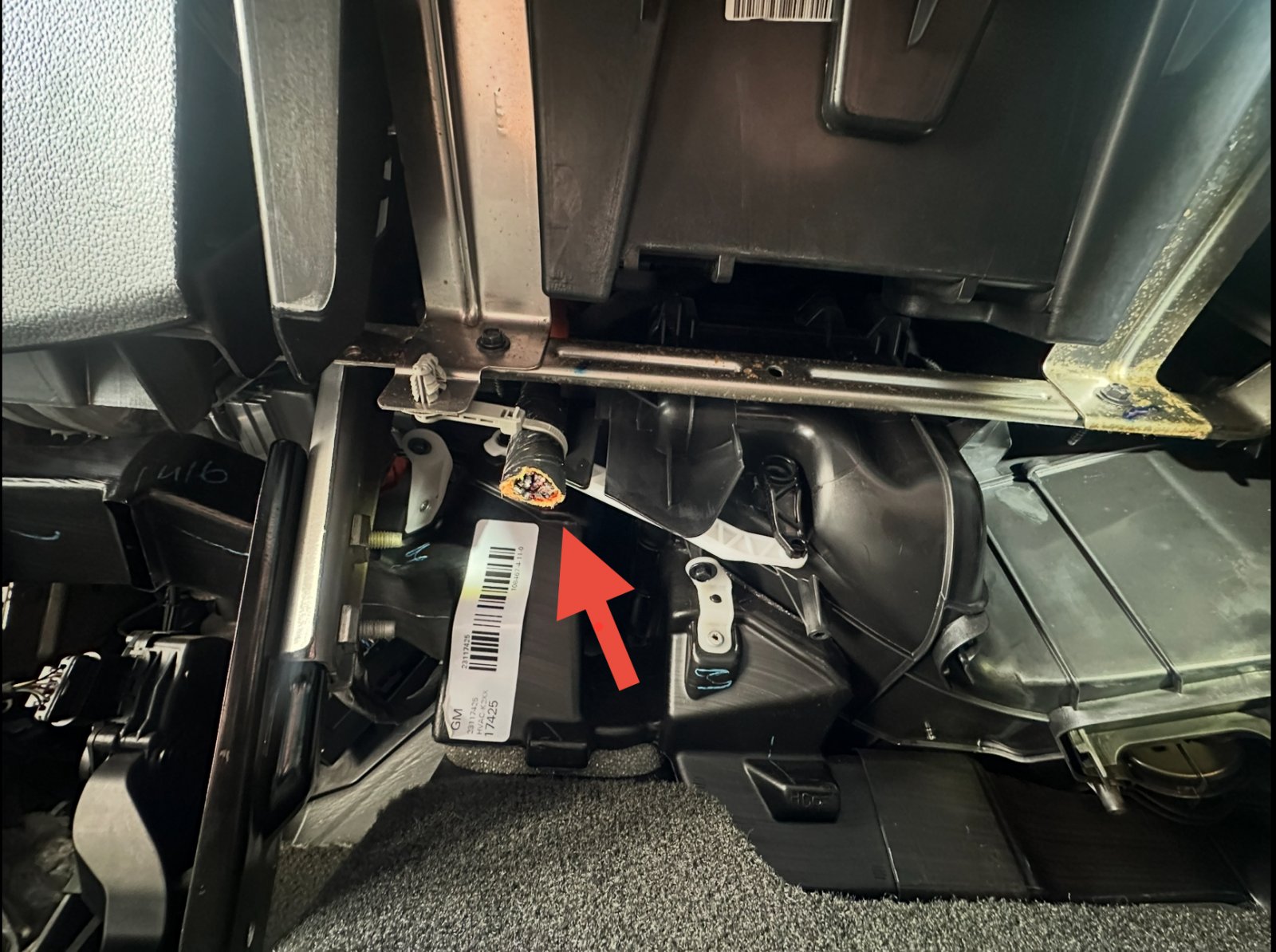

Welcome! To one small little obscure corner of the internet where we now have a whopping 3 members part of the 3500 owners group! I will be able to check this later this evening and post a picture. Where under the dash is this?
Hello Bigburb3500, appreciate your help with this. Thanks for the welcome.
Its located right under the center left. Under the drivers temp control knob close to floor.
See attached photo with red arrow.

Ok, I might not be able to check tonight as I have a full center console, and I may have to open a panel to see this area.

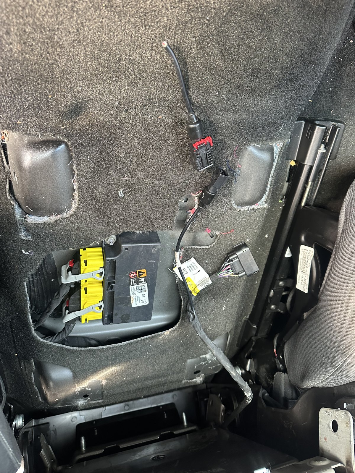

The Jump Seats wiring that I have needs to go to under the center console where the wires are cut. Need to figure out wiring from my Jump seat plug/connector to the cut wire that probably had a plug/connector.
Attached photos of cut wires below center console and jump seat harness that probably needs to go to front where wires are cut.
Next step will be to unwind some of that electrical tape and sheathing around the cut wires so you can get a good look at the wire colors. Compare those to the schematic I posted and you can probably start piecing things back together.

Also, note that this looks like a mini usb connector. My guess is it originally went to the USB outlet at the back of the center console.
