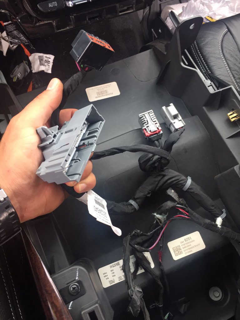

How difficult was the center console install? We're all the plugs there when you pulled up the rubber flooring?
See the photos earlier it the thread. Very simple operation. I installed a GMC Denali center console - I wanted the flip top cup holders - cigarette lighter, 110V and USB plugged into the plugs that came out of the PPV dash. I think some wires needed to be altered, I don't recall now.

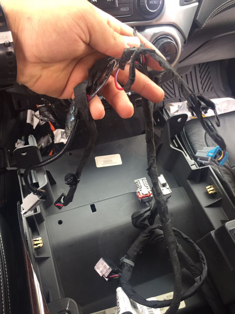

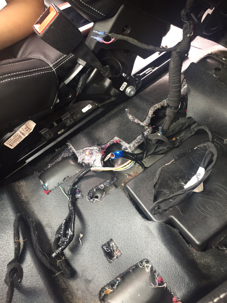

Do you by any chance remember how the wiring was for your center console? Here's my situation. Seems like wires were cut while changing this over to a squad car and I can't seem to figure it out. Any help would be appreciated.

I'm having the same exact issue please let me know if you figure anything out.
I ended up using the lighter and USB already supplied in ppv trucks. Ppv trucks have a different wiring harnesss (gmupfitter harness). So the outlet, climate control etc don't work in the rear. Sucks but I'm no electrical guru to figure this all out.
What I did was extend the PPV USB to the USB in the center console and the 110V power outlet to the 110V power outlet on the rear of the center console.
