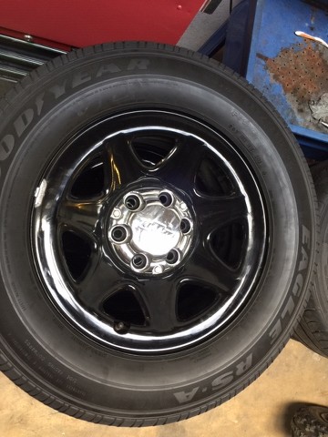

I was going through the storage and found my original PPV wheels.
Is there any demand for these?
