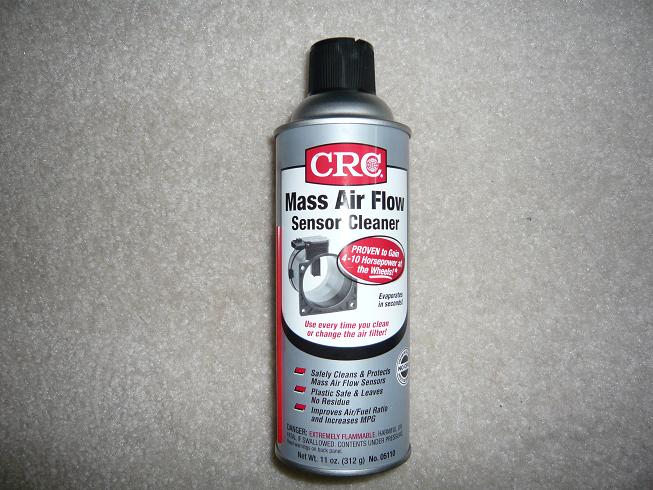

Follow the instructions on the back and be careful not to touch the screen with your bare hands it is delicate.

okay soo mass air flow sensor is next to clean, i dnt think my throttle body had ever been cleaned it had alot of build up in there and being a 2000 dats a loong time. i also heard cleaning the Idle Air Control valve is a good idea to do?

For the MAF cleaner, you're supposed to remove the MAF, spray the CRC on there and then let it air dry. i have the K&N intake, so i just remove the tube and filter and spray the MAF and then let it dry for like 1/2 hour while i clean the TB. not sure about other intakes, but i dont have to remove mine. I'm probably due for a cleaning too pretty soon
