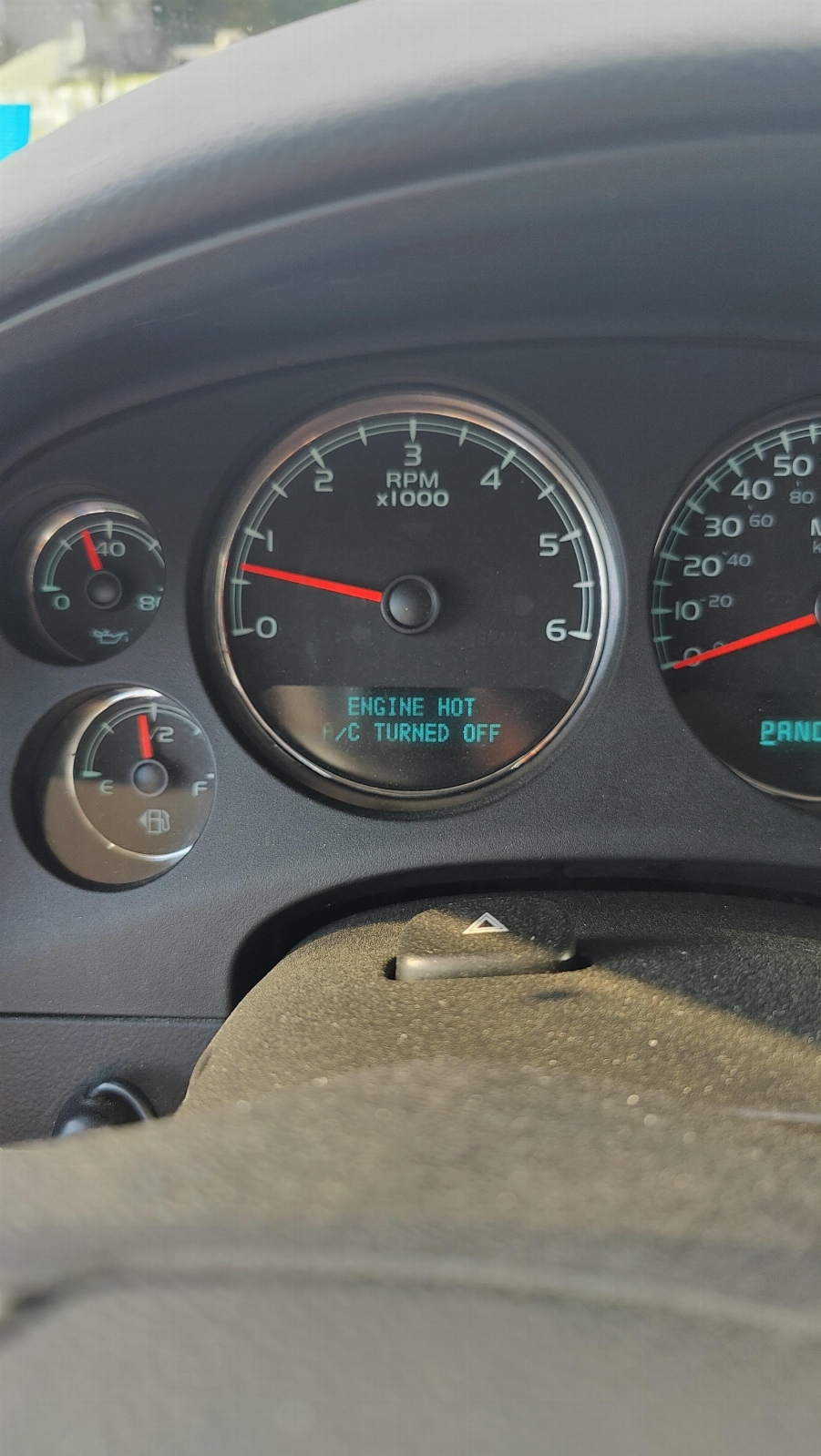

It's cooler out today and on the way to work this popped up. Temp gauge was at the bottom below 160. Surge tank is full. Does this radiator work too good? I'll be checking the temp sensor when I get home. Top radiator hose was hot but I could hold it without burning myself. Cold side of the radiator was just above ambient temp I'd say.
Thoughts?View attachment 376362

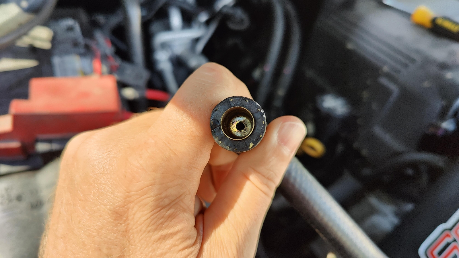

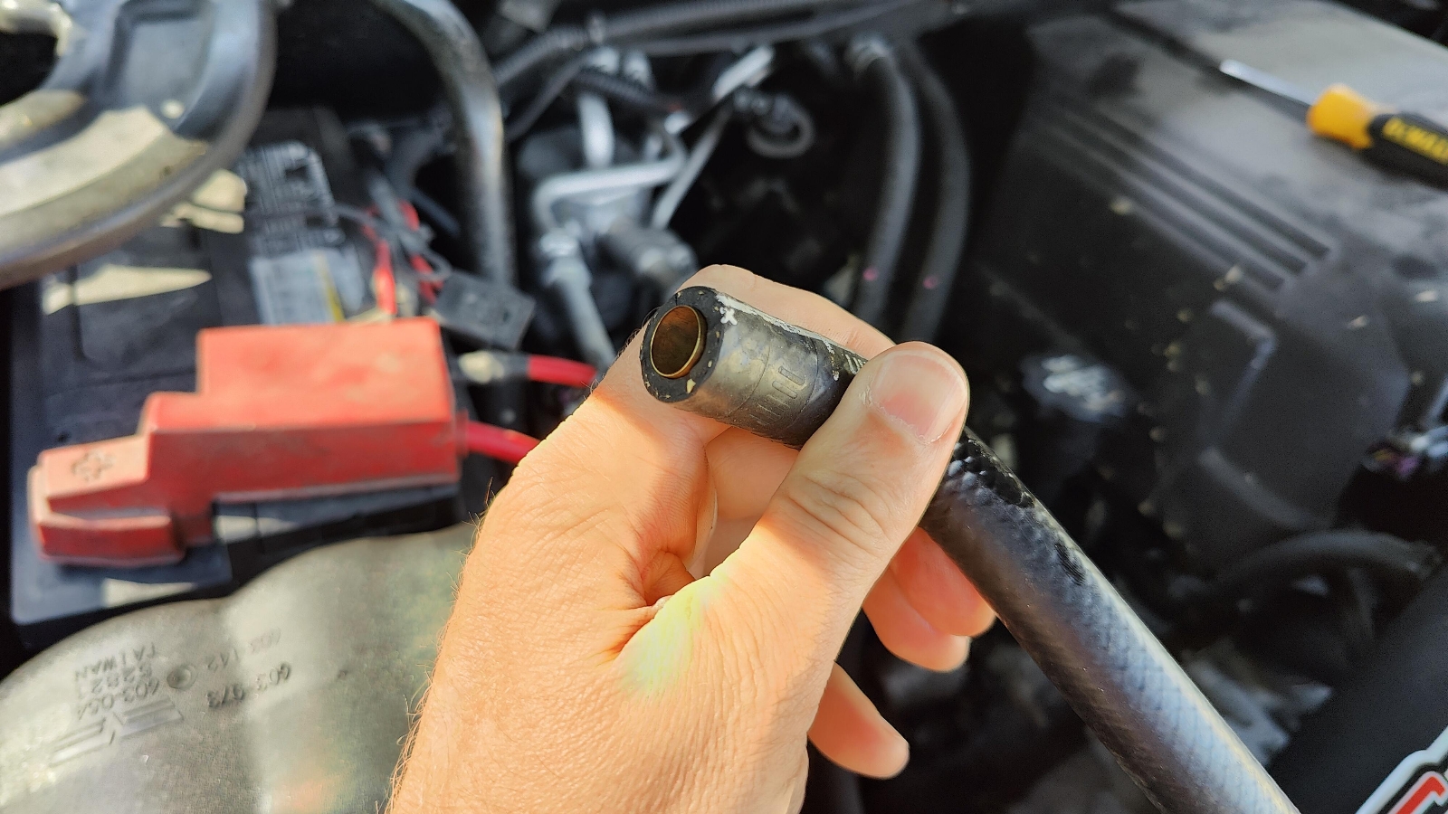

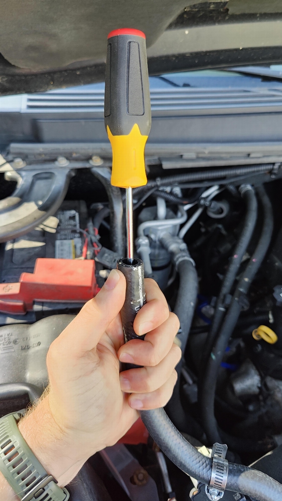

I used the nipple from the old radiator as in insert in the line to get the restriction.

I tossed the old radiator already but I have plenty of brass casings so I'll try that.

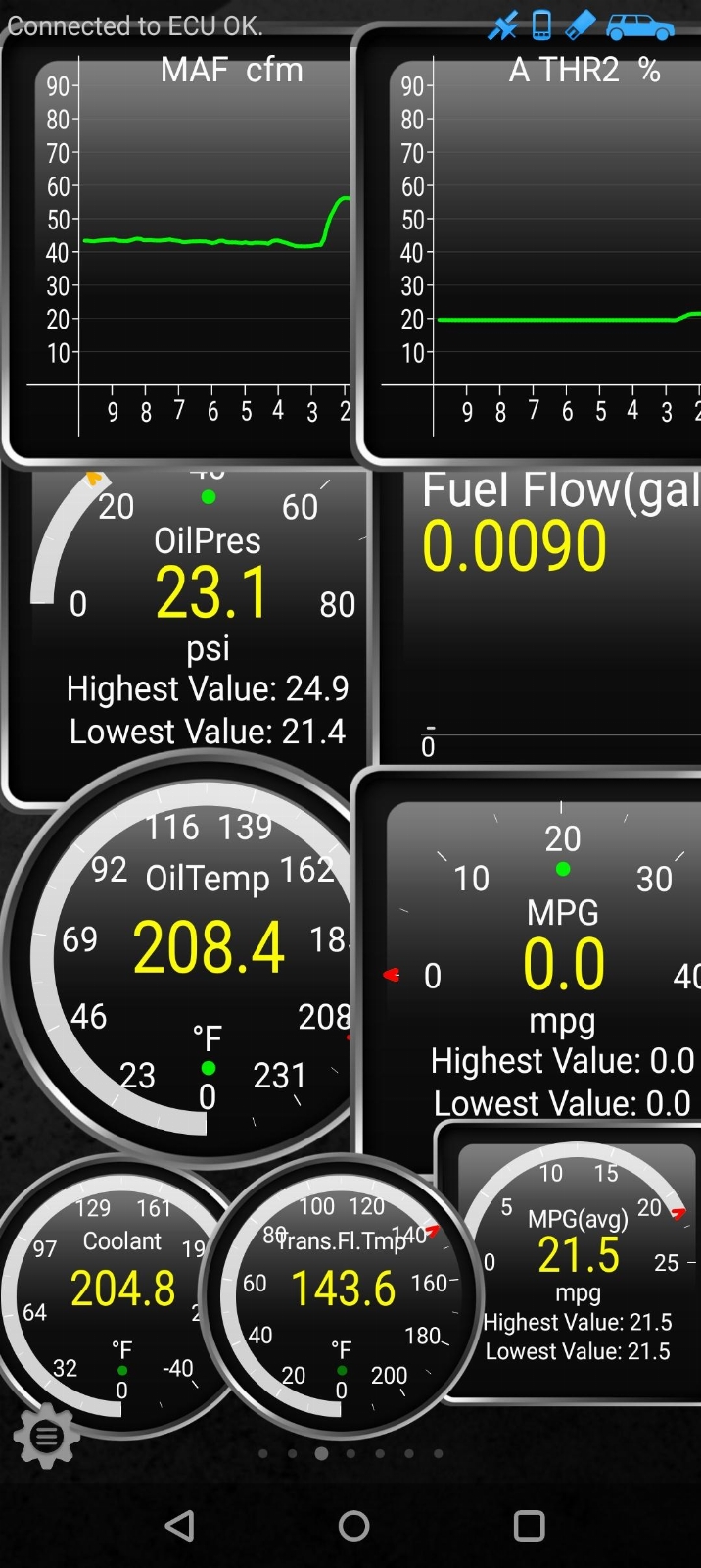

I know it's not the temp sensor because after driving around a while it must have got hot enough for the warning to go away and the temp came back up to 210.
