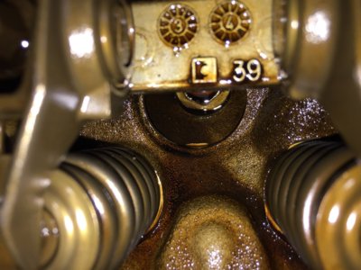

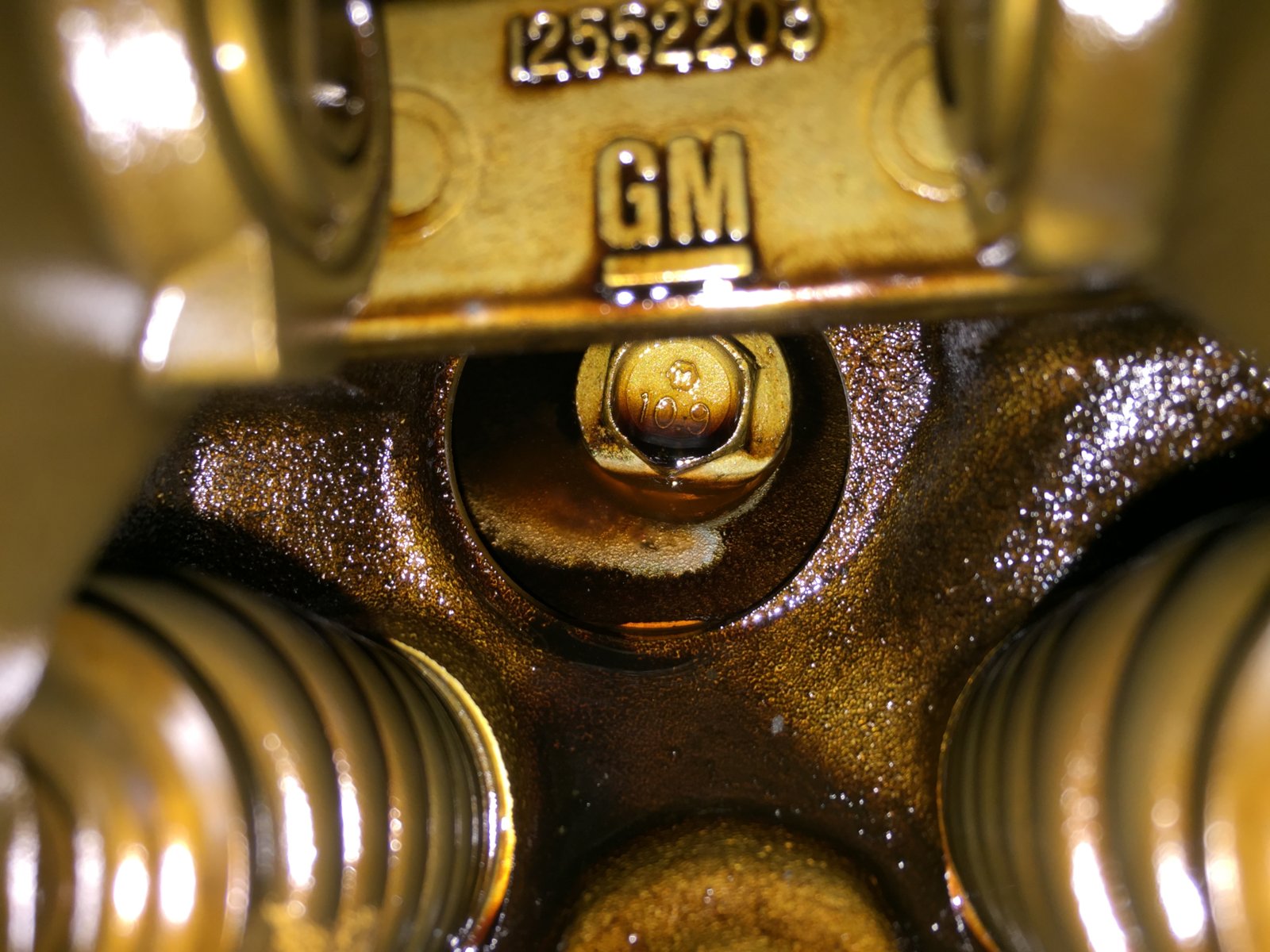

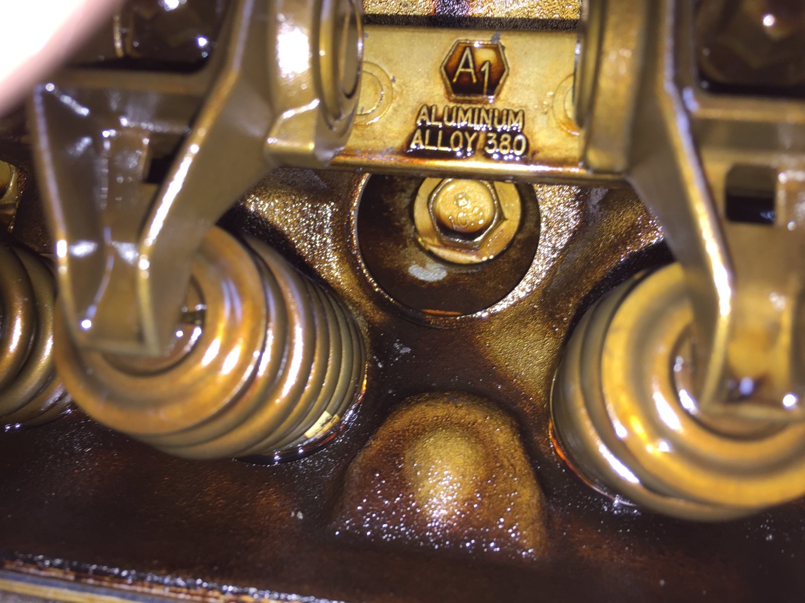

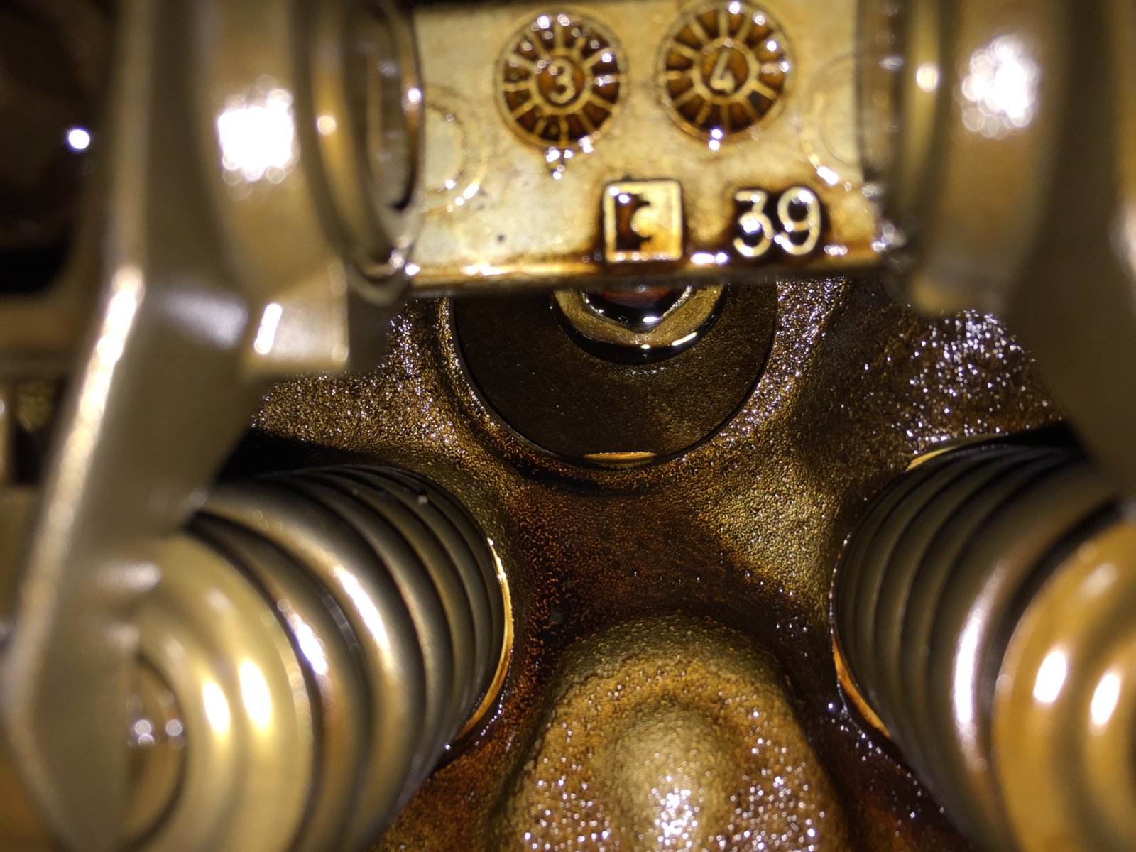

Easiest way--On the driver side, look all the way to the lower right(rear of the head) , you'll see a 3 digit # stamped on the head, that'll tell you what head casting you have--on the pass side that number is all the way to the right(front of the head)View attachment 205981
