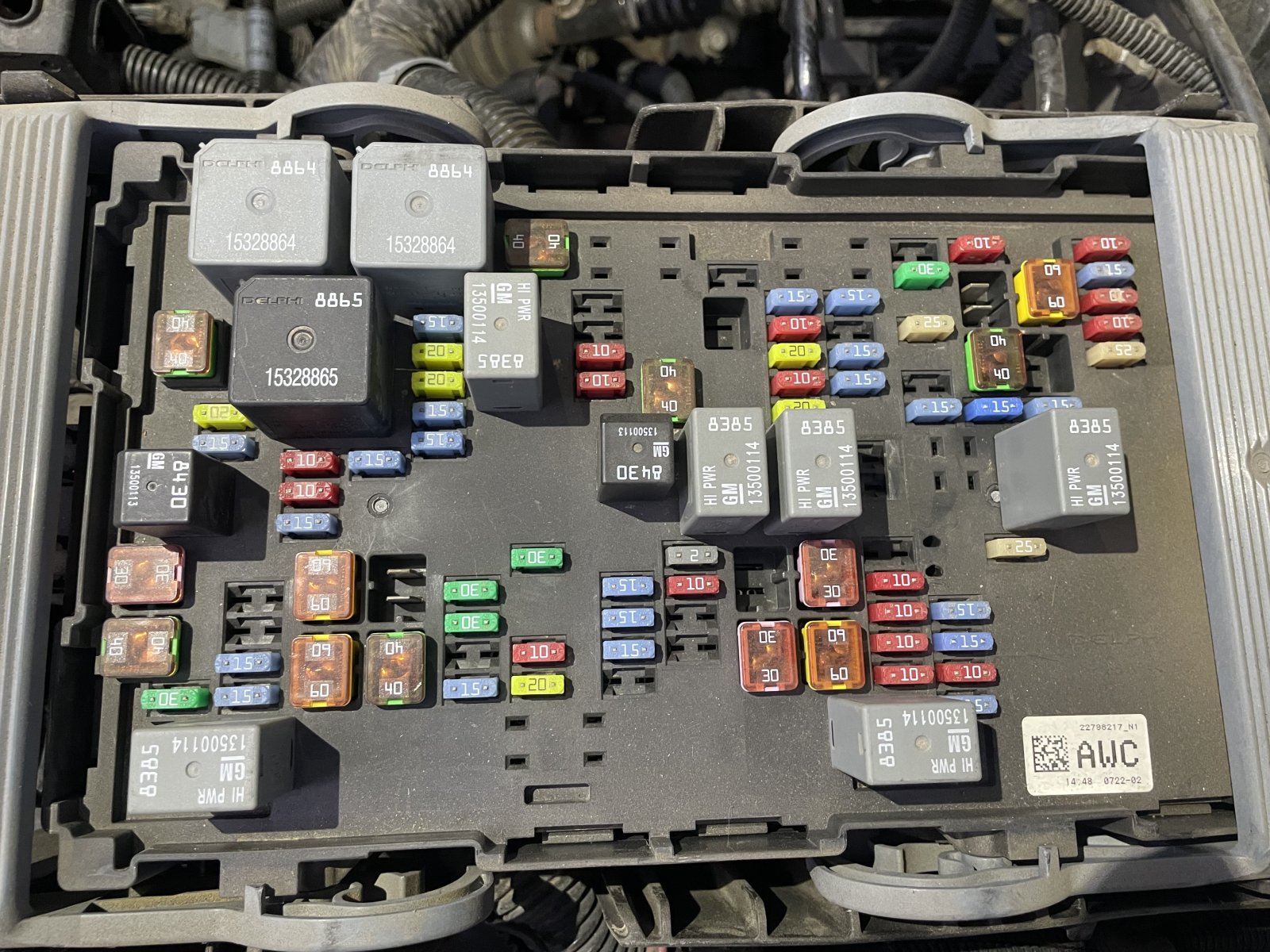

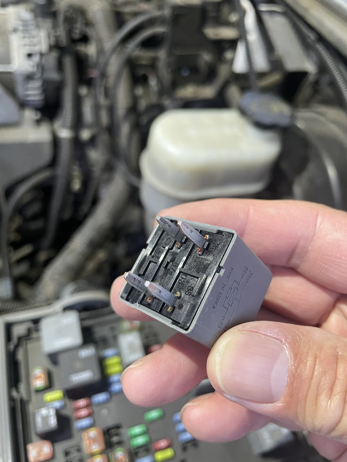

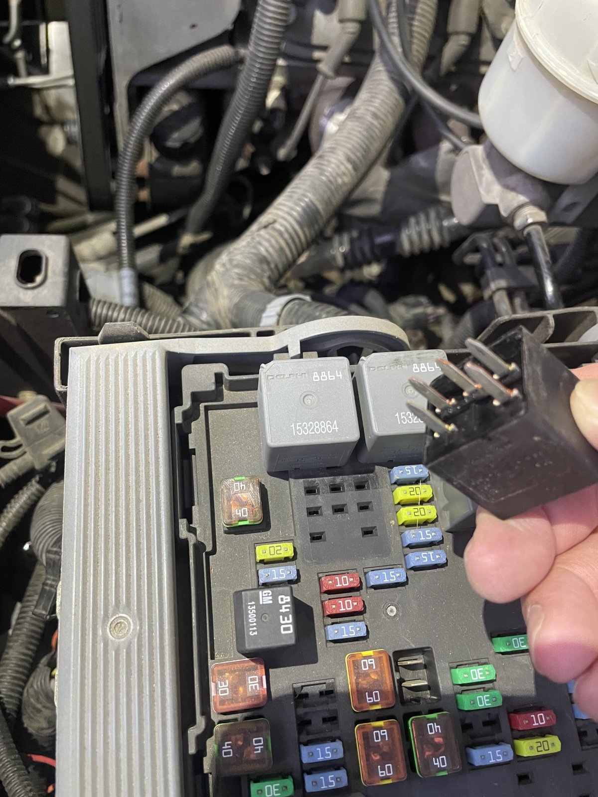

I did a eFan swap on my 2001 Tahoe. It's canibalized from multiple years. I believe a ~2005 GMT800 fan harness and junction block then the 700W severe duty fans from a 2012 6.2L. My notes are below:
All three relays in the junction block failed (high / low select, fan 1, and fan 2). I'm curious if the GMT800 circuitry isn't strong enough for the 6.2L fans. However, I don't have a GMT900 around to look at how they are wired up. Does anybody have pictures or anything of the junction block where the fuses and relays are for the GMT900 radiator fans?

Top left corner, 5 pin control relay on bottom. No amp markings, but rockauto seems to show 35 and 40 amp relays for this style.

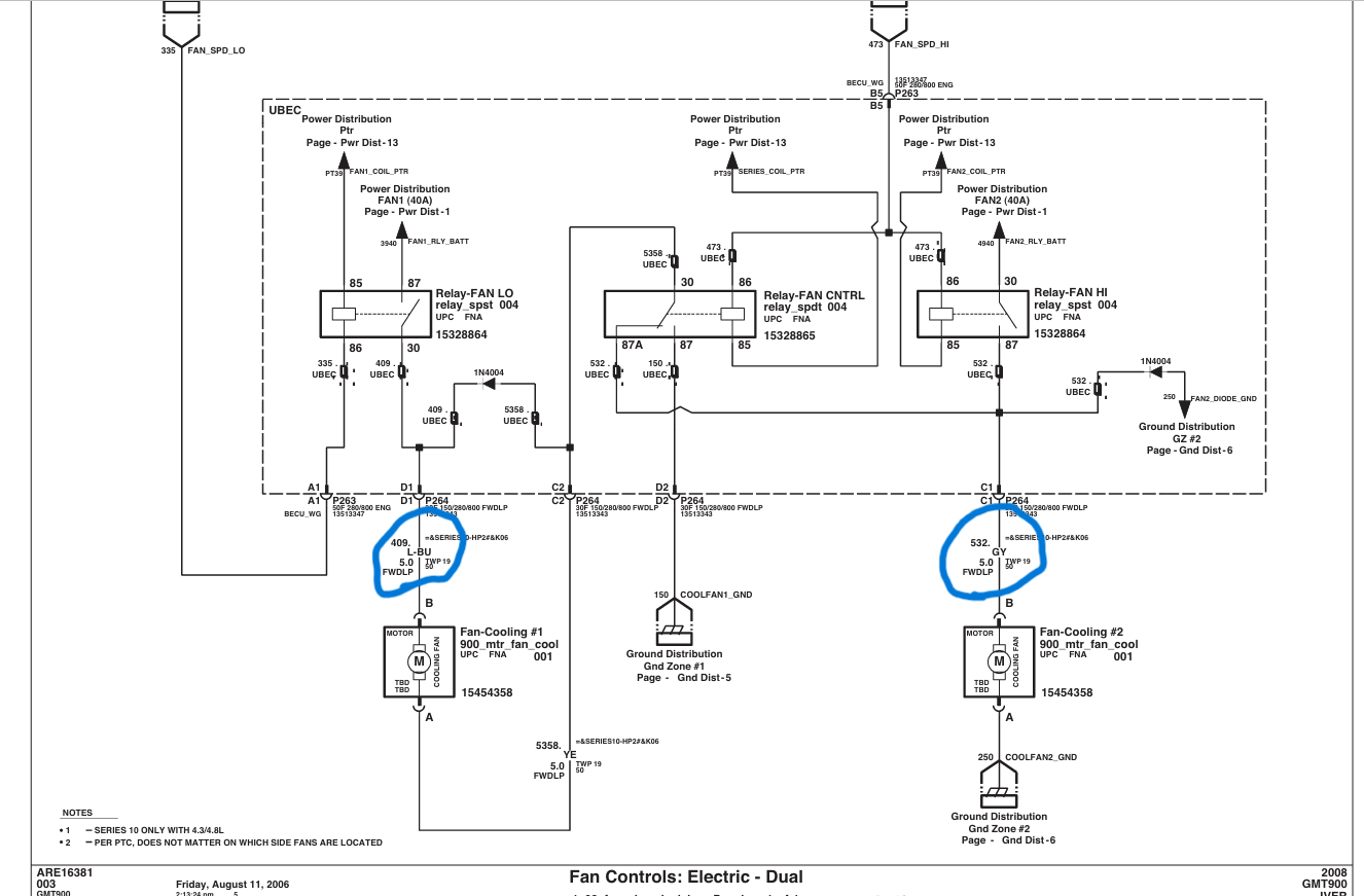

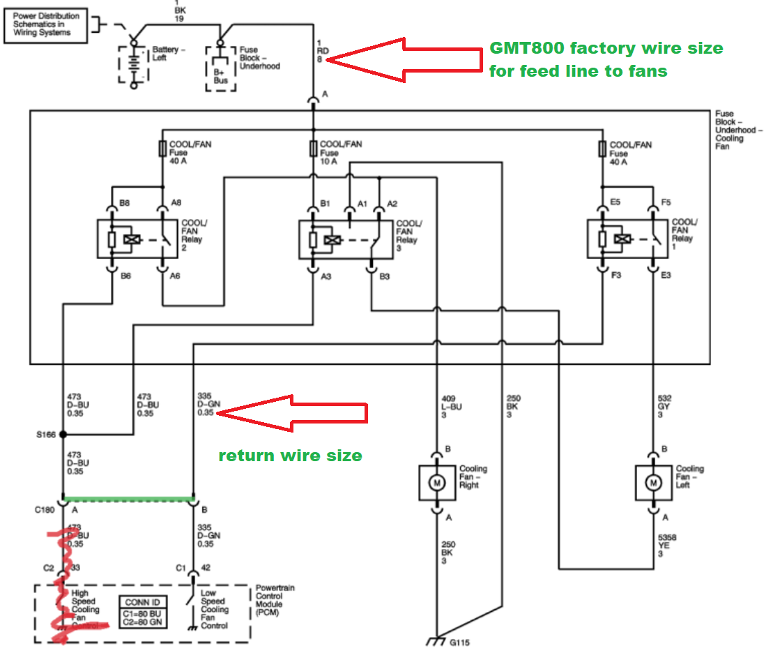

I'm looking at the wiring diagram from the FSM for the GMT900 provided by @swathdiver I cannot see the wire diameter. Below is the diagram from the GMT800...
Not sure if I'm reading this correctly...
When looking at the gmt800 wiring diagram the positive line is 8mm^2 ~ 8 AWG... On the low end that's around 40 amps.
The return path / ground is 0.35mm^2 ~ 22 gauge. I'm not as concerned about the return line as it's adding resistance to the load which maybe helping my cause... if my thinking is correct. If I enlarge it then the feed line will have to be enlarged as well.

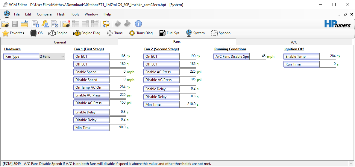

Here's a screen grab of my fan settings in HP Tuners:
I'm not sure if enable speed and disable speed set to 0 is defeating the Vehicle speed trigger for the low speed fan? If memory serves me correctly, I only ever got the high speed fan (currently broken so I cannot confirm at this moment).
HP Tuners parameter labeling and context help are a bit vague. I assume AC Fans Disable Speed turns the fans off all together over a certain speed, and isn't necessarily linked to the AC being on or off? After all what's the point of energizing fans if you get a larger volume of air from velocity of vehicle.
I should note, I don't have the pressure sensor for the AC so those parameters are unchanged. I lied in the tune a bit to get dual fan control, this released one of the PCM pins which was in control of an AC function to command the high speed fan. Maybe some logic that's not quite right w/o the pressure sensor? I'm wondering if it's forcing the high speed fan on if the AC is on... Additionally, I do a lot of trail driving so well under 45 MPH. Actually under 20 mph, and it's HOT here so I run the AC. This may have further provoked the underlying issue.

Here's the wire cross sections I was looking at circled in blue..

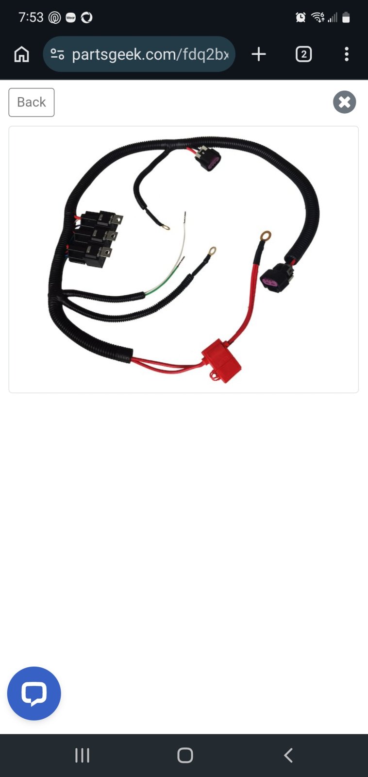

Take the load off ur factory system and use this. Was just talking about this in another forum. Amazon.com and its cheap and comes with the ledger for where the wires go in the PCM harness. And or partsgeek.com

I've seen those. I'm trying to keep an as factory configuration as possible. However, maybe worth canibalizing one of those for the wire... Otherwise my next question was... where can somebody get 8 or 10 gauge bulk GLX J1128 compliant wire or otherwise for under hood conditions?
