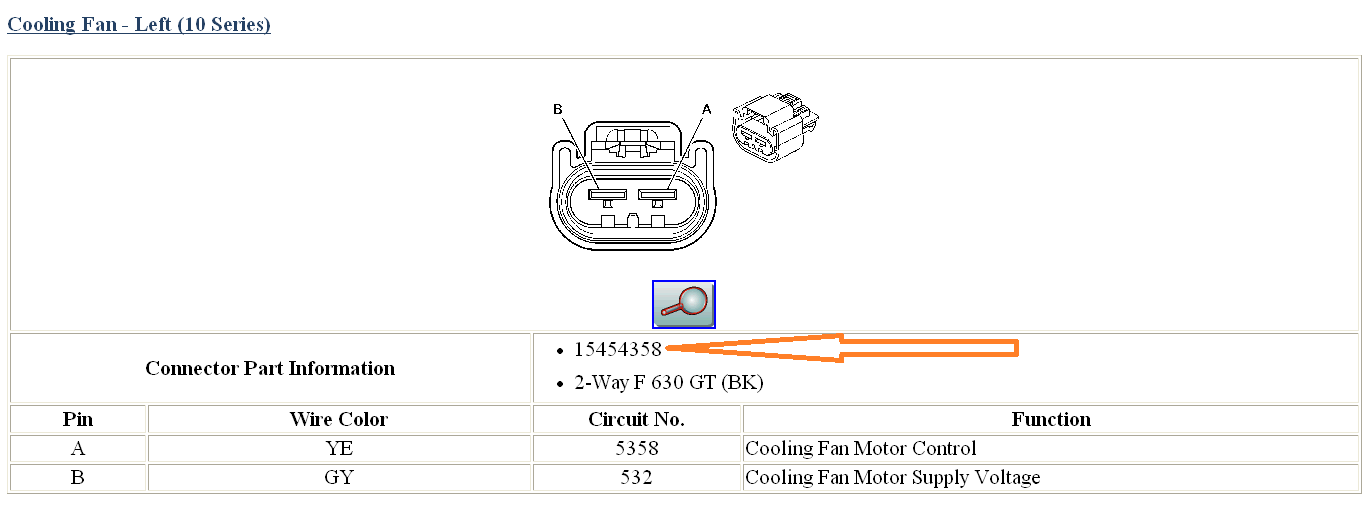

Anybody have the PN / Connector End view for the GMT900 fan connectors?
The plan is to, rebuild the fan harness 8 gauge wire... Or 10 if driven by connector limitations, more in a sec.
I'm getting ready to order the pins for the fan connectors. I don't have access to the FSM for the GMT900 though. I've found the terminal pins and wire gaskets for the GMT800 on Mouser.com However, they're spec'd to accommodate 12 to 14 gauge wire (GMT800 harness uses a 13 gauge). NOT the 8 to 10 gauge I need to run.
If I had the aptiv part number (shown below) from the "connector end views" in FSM for GMT900 I could order the terminals for larger gauge wire. The GMT900 uses 10 gauge in the fan harness.

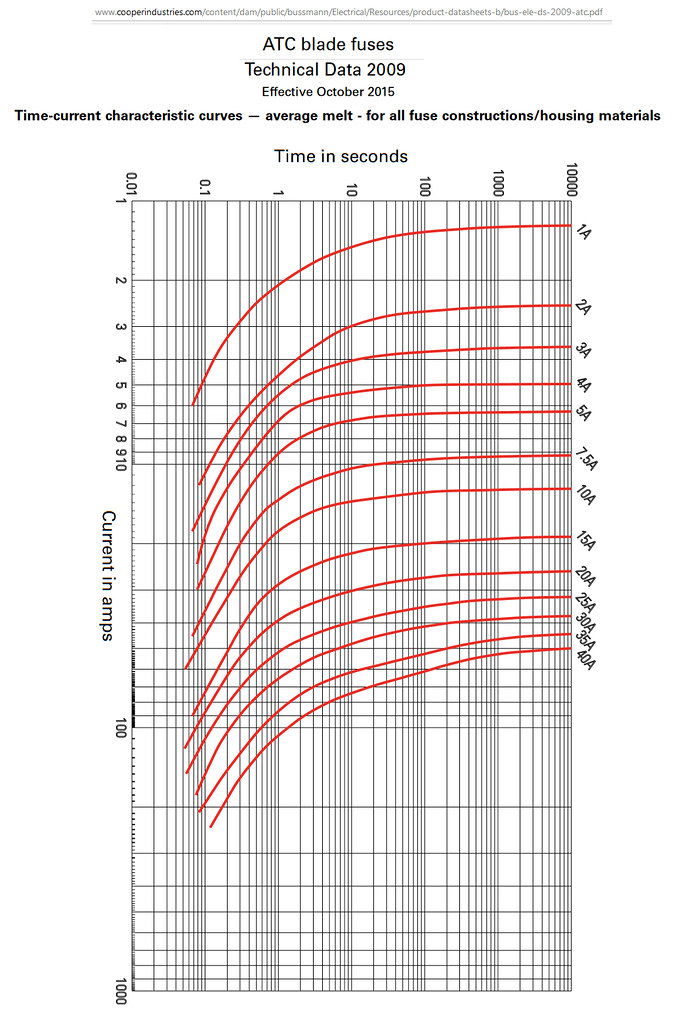

AI lead me down a rabbit hole insisting there's a recall of sorts on GMT800 / GMT900 fan relays due to melting issue. After much searching I found no evidence of this being the case. *sigh* Did find some interesting info though...
Quite a few people did melt their fan circuit doing eFan upgrades. One person speculates older motors draw more current... Could quite possibly be the case. I also drive off road a LOT. Possibly mine got caked with dust.
Interesting chart I found elsewhere.

Neat chart!
AI has led me down a rabbit hole too..
It's a know-it-all, that doesn't know when to say it doesn't know...

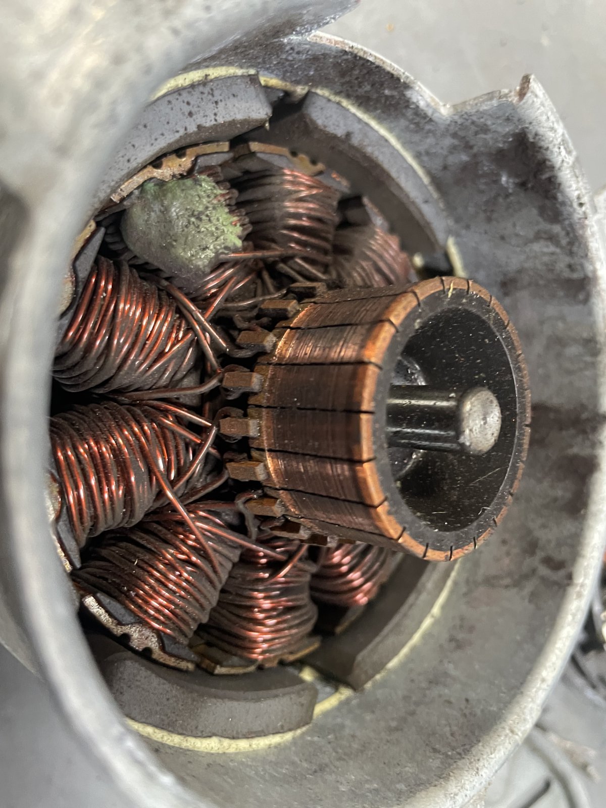

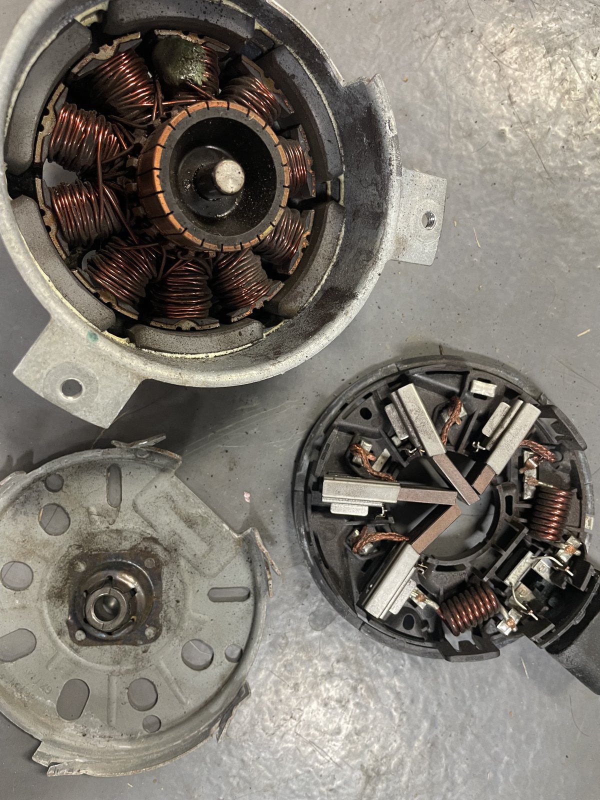

Are your fans old? Possible they will cause overheating on the new relay wiring as well?
I opened one up just now.. (I already bought new motors so I don't have to re-assemble this one!)
This one was somewhat scratchy feeling, and was a little squeaky too.
But all my old fan motors feel scratchy when turning by hand.. I guess that is just brushed motors..
(2nd version 700W motor.)

Yeah measuring current draw is simple enough. I'll do that.
Although I'd be really curious about what these fans looked like on the inside! You could rebuild that! Really cool!
I've rebuilt a starter before. It's a similar motor in concept. You replace the brushes. I also lightly sanded the commutator. Lastly you can check the friction surfaces / bearing & shaft. If they're not scarred it could be something else... if they are scared can lightly polish, put a little silicone or lithium grease and put it back together.
I also tried to rebuild window regulator motors. The brushes fail on them. I think our trucks have Siemens motors for those. The design is such you need a jig to put it back together. I cannot recall what bits I couldn't get enough fingers to hold for reassembly.
