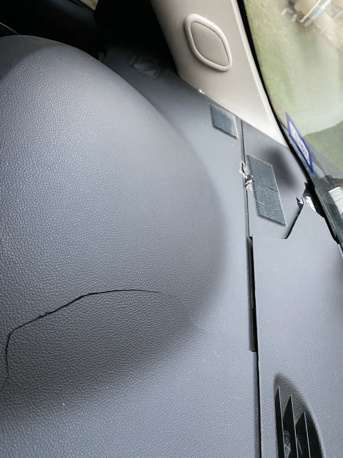

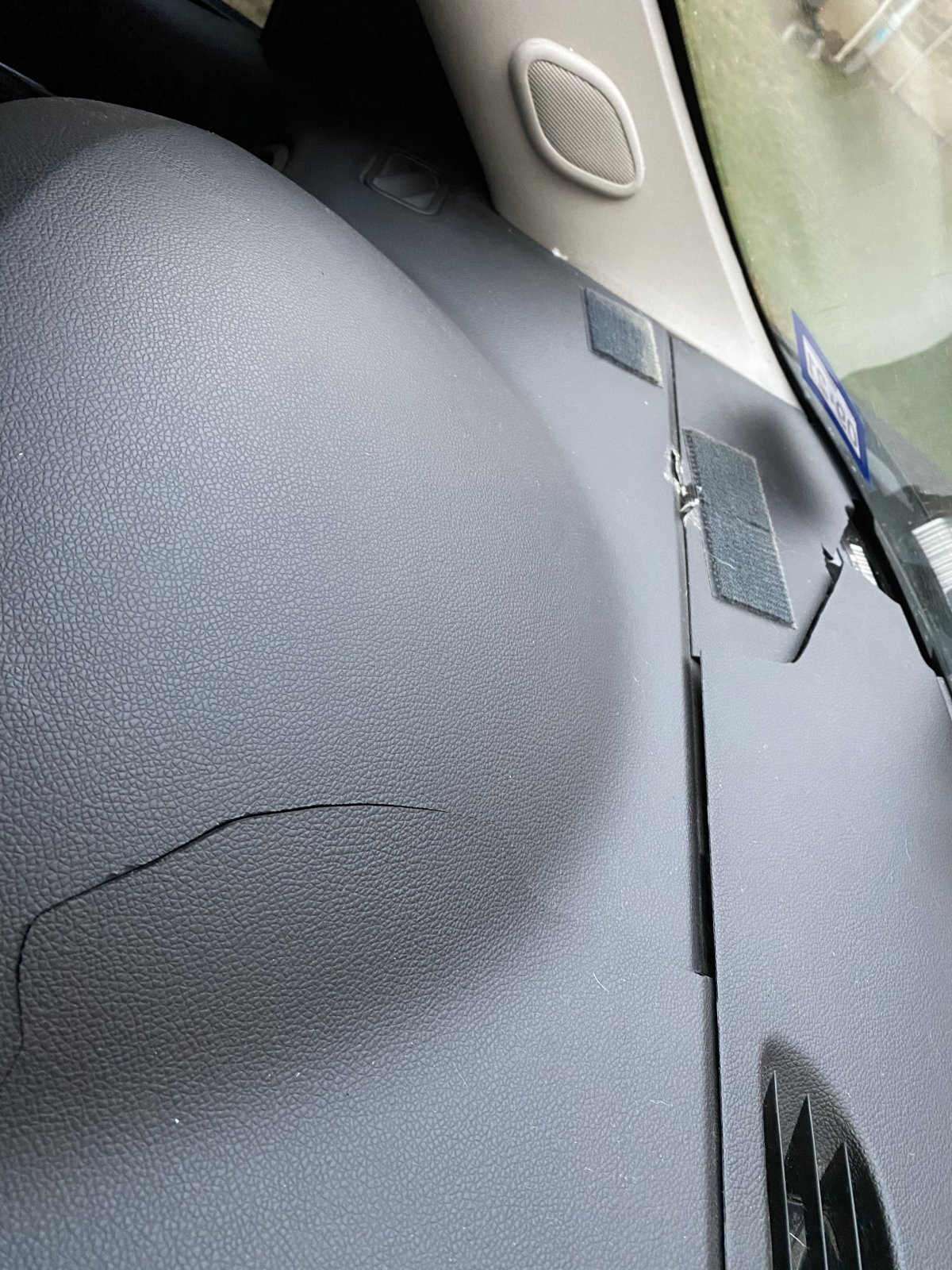

Well the cold temps finally got it. My 2012 Tahoe has had a small crack in the dash by the passenger air bag for the past few yrs.But now one formed on driver side behind the tach.
Is there any way to repair this without getting a complete dash? A patch job would work if it didnt look too bad.
I just went online and found an overlay cover for like $120. It’s not perfect and the texture doesn’t quite match but it works for me. Better than seeing those ugly cracks.
