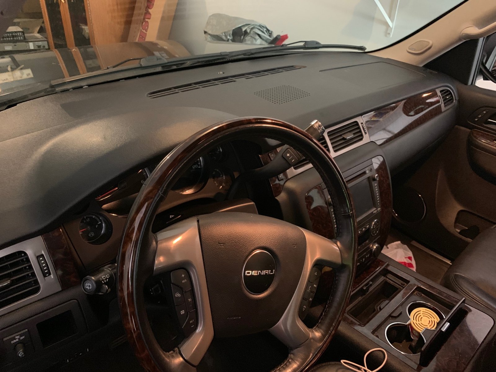

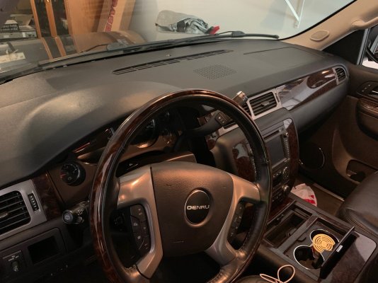

Awesome!! Looks right to me so I don't know why I need this other part number (sigh). Would you mind snapping a pic of the front of the dash from end to end, as it will look installed? I want to see if it matches my dash. If so, I'll be changing my order since it is STILL on back order.
Aug 3, 2021
33
24
My only other thought is perhaps mounting points could be different between the two part numbers?
