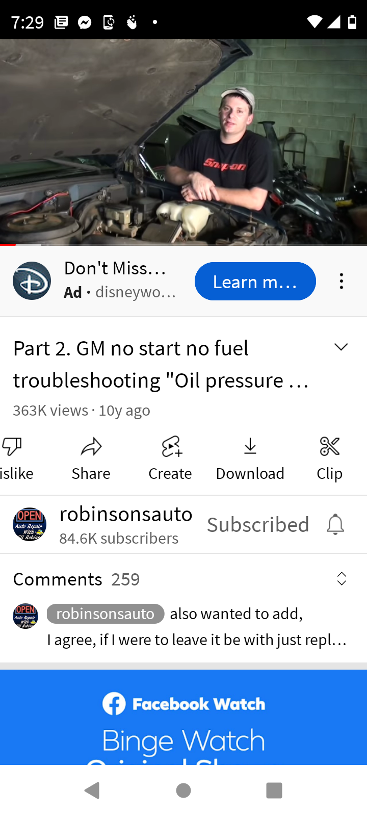

I have a cheap obd ll reader...but oddly it isn't showing any codes but that could be from the previous battery going dead..I went at this six months ago and got frustrated and let it sit recently revisiting it and doing the things mentioned and unplugging maf was done with no change.. I even ran an alternate battery to block ground trying to eliminate a ground issue..I heavily want to lean on the ignition switch or pass lock but I don't have a security light so I've opted to not replace but I almost feel like it's one of only things left...question I was researching and watched a video that states the oil pressure switch could be faulty interrupting the fuel pump circuit and a backup source of power in event there was a failure with the relay for fuel pump....what's your thoughts
