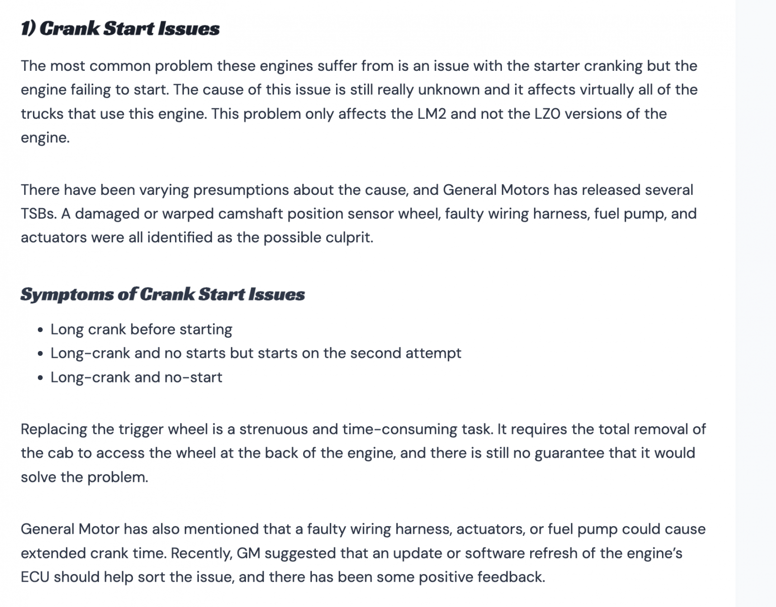

Have you had this Yukon since new? There was an issue with early LM2s that caused an intermittent crank - no start issue. It urned out to be an issue with the cam position sensor not generating a signal fast enough. They also found a few (very small number) that left the factory where the metal wheel on the cam was bent/warped causing some weird issues. One of the early attempts to fix involved putting a shim under the cam position sensor (didn't work). A later software update did fix the issue. If you aren't the original owner the added shim may have been installed and cause the issue. I had a 2021 Silverado with the issue and the software did fix the issue. Duramax forums and GMtrucks.com forums tend to have a lot more info on the LM2/LZ0.
