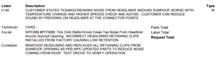

That sounds like what I am hearing. If you push the headliner up gently with your hand you should be able to replicate. I spent about 3 hours yesterday driving and didn’t hear sound after putting foam in.

I did have a chirping sound coming from the back every time I'd hit a bump. It turned out to be the back hatch interior door panel was not fully connected. The lower left corner was completely popped out. I snapped back into position and no more chirps. Two of the metals clips that snap into the metal door frame would rub and make the chirp sound. This came from the factory that way and was one of the first problems I fixed. I looked everywhere for that sound and one day I slammed the back window closed and I heard the chirp. Opened up the back hatch, inspected interior door panel and voilà.

What if we put felt tape in between the male and female clips? I can't tell if the noise generates from friction between the clips or from the female(top) clip and aluminum pano frame? Or both.
View attachment 261890 View attachment 261891
Do you think silicone would do the trick? Just put a nice bead of silicone at the plastic connections? I don't have my Yukon yet, but I was thinking about silicone if I have the same issue.

I removed all of the foam this weekend, so service can get a good listen for this Wednesday. While removing the foam, the connectors started to disconnect, which allowed me to get a much better look inside (photos in Nov 7th post). I thought about cutting the two posts off the male end connector and using adhesive Velcro in between. May try the silicone route if service dept can't fix, which I highly doubt. Then again, once I get silicone up there it may be difficult to stick Velcro afterwards, if needed.
As jna97 said, they don't really do much. Velcro may work fine.
