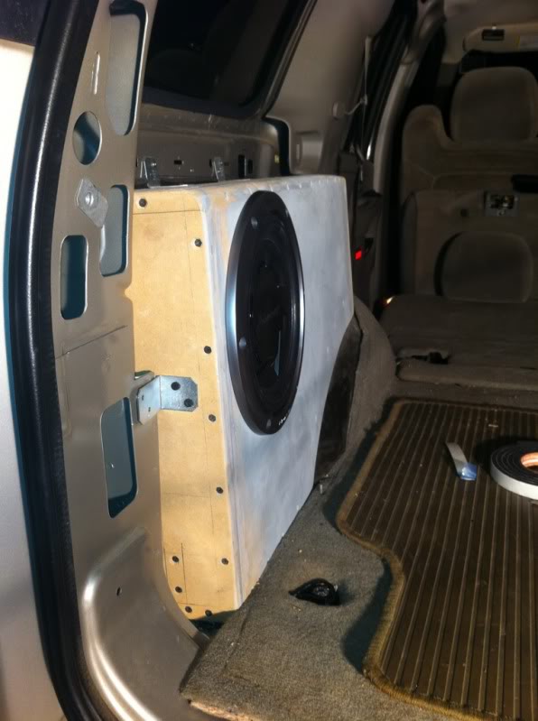

Question for the OP... I see that your sub also goes out beyond the bounds of the factory sub opening in the panel. Do you get any additional vibration of that panel from reflection? Any issues with the jack access panel or did you somehow permanently afix it to the main panel? The reason I ask is the Thunderform places the sub at a similar location to yours and I am thinking of modifying the panel to place a larger opening for better acoustic transparency.

My access panels are epoxy on the inside. (yes permanent) I lined the inside of panel with dymamatt. And the box has multiple 90* brackets bolting it to the body. The main panel I occasionally get vibration from is the tailgate. Reflection is not noticeable if it's happening. I dremoled out all the vent holes and I feel that the majority of the air movement passes thru the vent. Also my box is the absolute max that can fit in the space. I used every available Inch. Any more questions fire away.

box sits flush to the outer wall. flush to top of the body panel (inner supports are all cut out. the storage is cut out.. site flush to the cup holder.. then flush to the outer wall with a back taper at sub end.. so there is a 1" or so driver travel area.... the jack access and the cargor storage hatch are both 2 part epoxi closed and i spent lots of time maximizing the air space getting max air area..

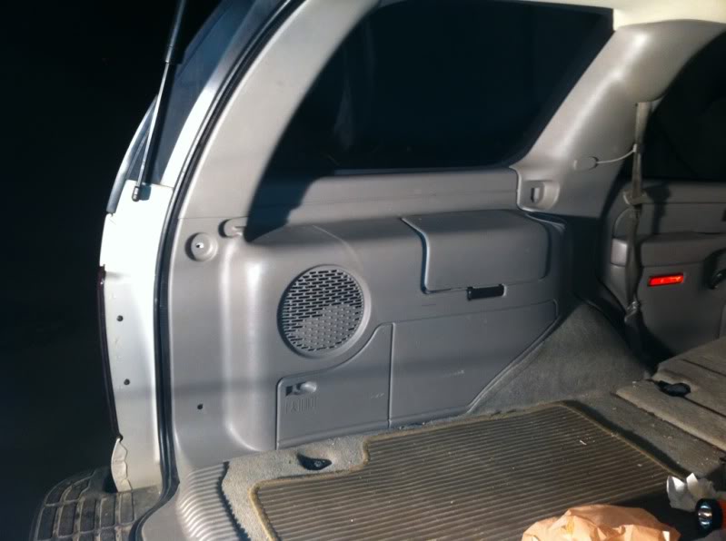

finally got around to finishing up the box and final instalation tonight.. here it is.. it weighs in at about 35lbs 148 screws and a tube and a half of liquid nails.. it is a very dense box.. the amp is turned down and it rattles multiple interior pannels that will be addressed this weekend. the box is bolted to the body so it does not move.. the rear lift gate glass needed extra thick weather stripping so it would not rattle.. sounds good for a speaker still getting broken in..
the milling out of the grill is almost done,, it is very time consuming.. no room for mistakes..
