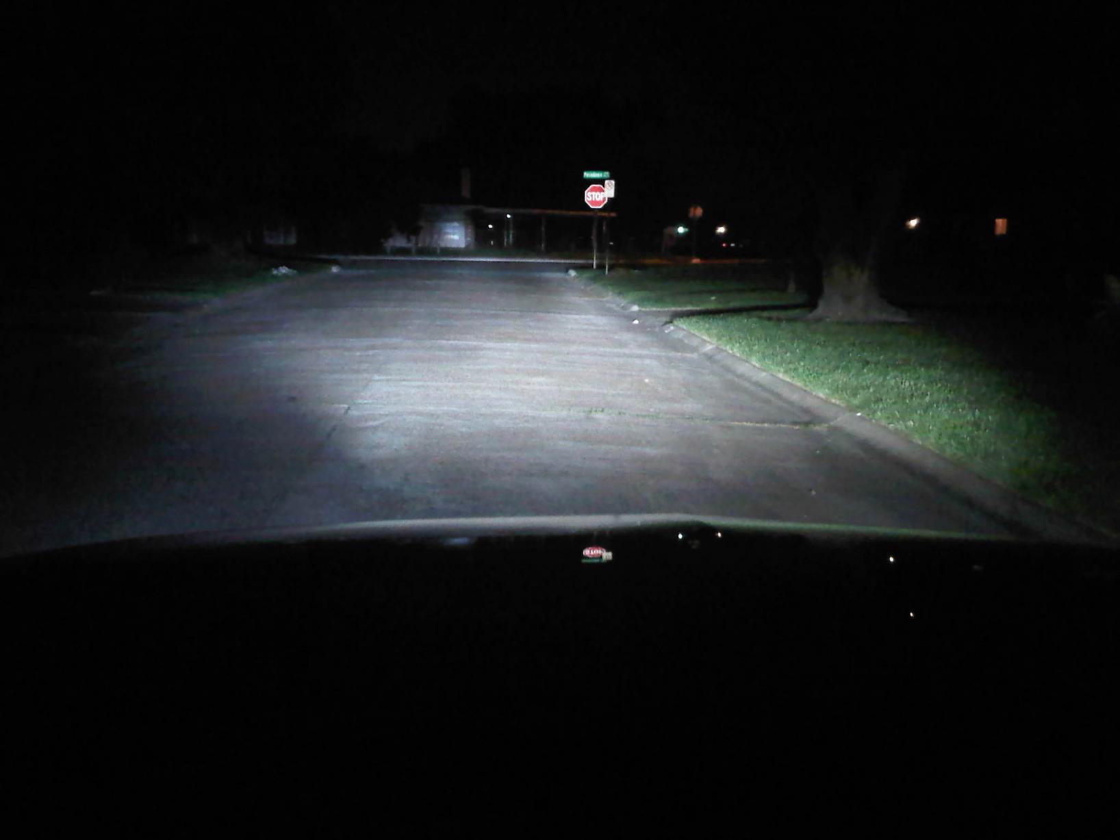

finally got my HIDs in and installed!! pretty damn good so far...and bright as hell!! damn i missed em!!
