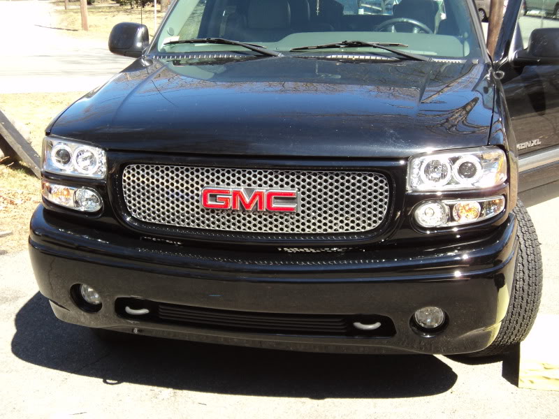

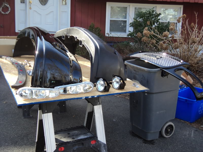

Thank you 1Lowoe04 good found!!! And with those I don't have to change the Grill Support part, because they got the cut for the one I got, samething with the fog lights, look likes the second picture kind that will match my existing fog lights, what you think?
Yukon-ya
Aug 3, 2009
136
9
Minneapolis, Minnesota
I had that duraflex denali cover, Its ok but... its not made from good material like street scenes covers or the original denali yukon. If you wanted to original you would have to change our grille because the yukon and denali have different grilles and bumpers "shape wise" or... you could put a 00 denali bumper cover on! That wouldnt look bad at all. Im still thinking about doing that.

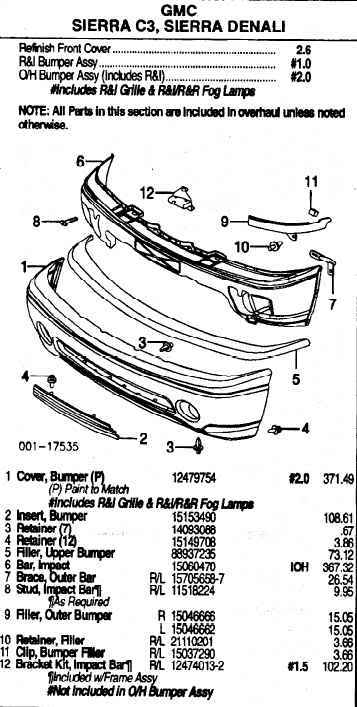

Ok Guys, The dealer say that I need to buy all this parts, but if i am right the only ones i need for my Project is parts 1 and 4, correct? CARCRZ help me out here.
1) Bumper cover
2) Retainer Type 1
3) Retainer Type 2
4) Bumper grille
5) Impact bar
6) Mount brace Right
7) Cap
8) Filler Right
---------- Post added at 01:56 PM ---------- Previous post was at 01:52 PM ----------
I almost forgot, anybody will be able to tell me if I need part number 7?
1) Bumper cover
2) Retainer Type 1
3) Retainer Type 2
4) Bumper grille
5) Impact bar
7) Cap
8) Filler Right
yeah thats all you need the bumper and and grille and you will need about 4 retainers to hold the cover on and the lights (turn sig.) and no you don't need #7 i bought that and didn't need it i still got it and as far as the lower grille you should get you a billet grille looks better

Thank You CARCRZ. and I assume that #5 is the one that I have to trim out as you explain in other post? and I just realize the lower grille situation

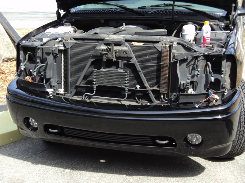

yes sir thats the one so remember when you start doing it start by cutting the fog light holes first, then you will see what you got to trim to make it fit right if i remember right i think the gap between the cover and the grille was too tight so by trimming down the corners will bring it down for that oem look.

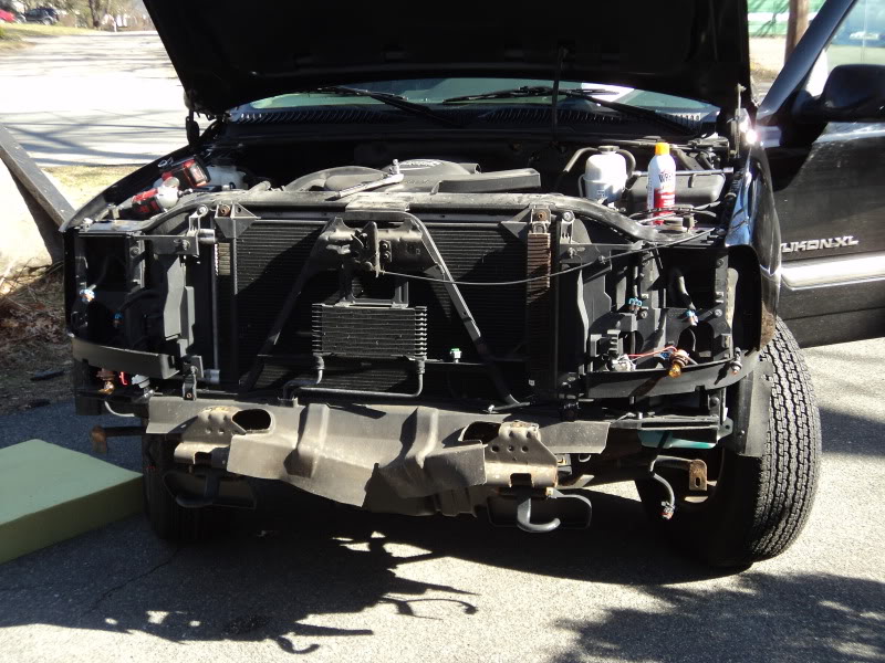

Mr. CARCRZ, I'm going with option #1, the one where I buy the IMPACT BAR (#6 part in this Picture). Question..... DO I need to buy the Brackets, Fillers and Studs for that? (fig. #7, #8, #9, #11 & #12) I will try to PM you my cell for a detail conversation, if you don't mind :):)
