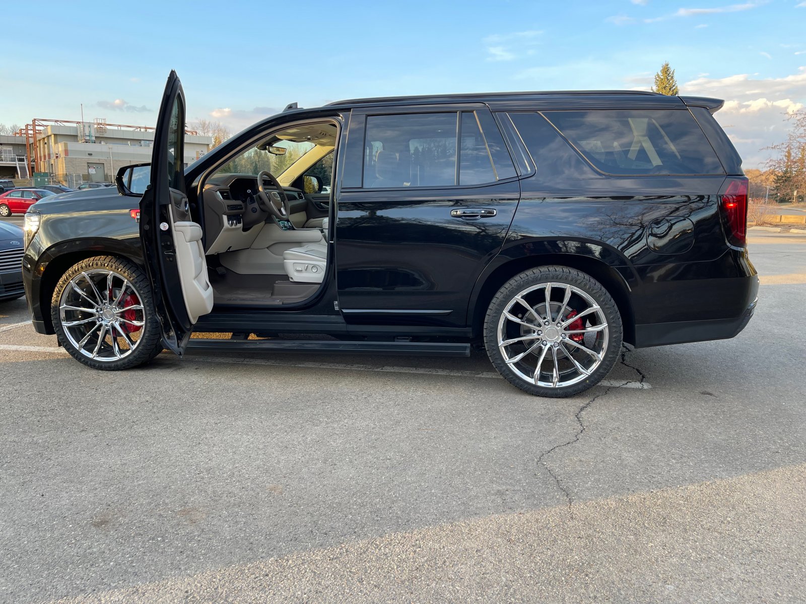

I'm not audio/electrical inclined so I need someone to post a detailed how-to on accessing the Bose amp. Until then, I've been working on wheels, chrome blackout, etc.
