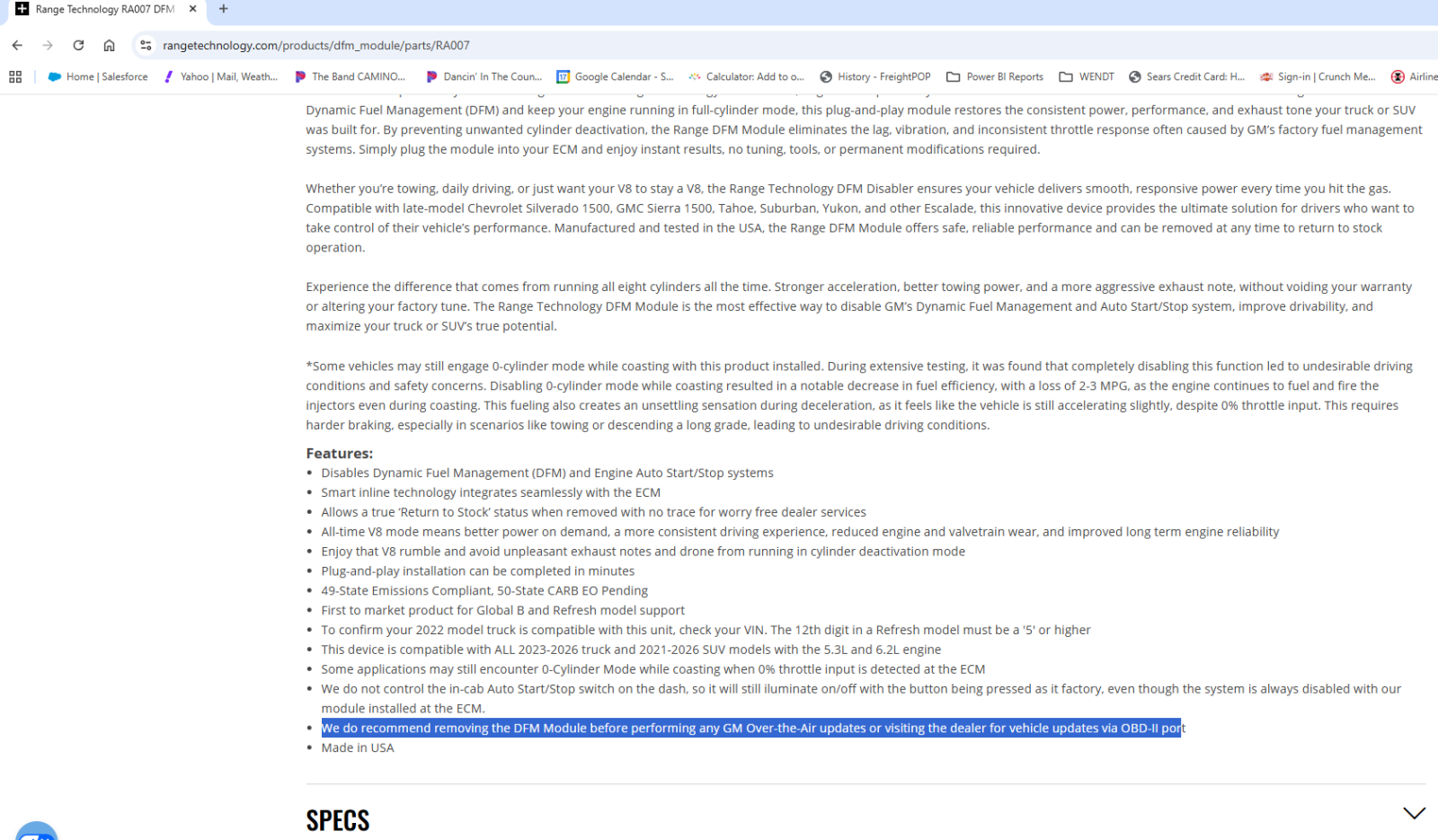

The Range unit works fine, just disappointed to know that its not actually a DFM disabler, its more of a DFM condition modifier it would seem because DFM still happens on decel.

Just so everyone is aware, and Range did not have this info on their website in the description, when the Range 007 device is plugged in the Evap and O2 Sensor Emission Readiness Monitors will not become Ready. So if you live in an area that requires Emission Testing, you will need to remove the Range module for the Emission Readiness Monitors to fully become Ready prior to Emission Inspection, otherwise you will not pass an Emission Test. This is based on OBDII Emission Inspections.
I emailed Range and they confirmed this is the case, but again, nothing on their Website about the Readilness Monitors. Unclear if this will impact OBDII codes from triggering in the future, unclear if OnStar monitoring will pick this up. Based on the price point, this is clearly some form of Spoof module rather than a sophisticated microprocessor that alters the data stream the inhibit AFM.
So BEWARE, you WILL NEED TO REMOVE the Range device prior to Emission Testing.

I was all jazzed when Range Technology , a division of Holley, one of the biggest names in the automotive aftermarket, finally came out with this device. I ordered one up basically a week after they came out (and they were already on backorder at the time).
But between them leaving on the 0 cylinder part of DFM on/ functioning (making the device a DFM schedule modifier and NOT a DFM disabler) and now the O2 sensor not ready flaw, I'm way disappointed with it.
I emailed them just prior to Thanksgiving requesting a return/ refund because the device isn't a DFM disabler. They did respond to the email saying I should hear something from Holley in a few days, so we'll see if that happens (haven't heard anything yet, but Thanksgiving may have delayed their response. Below is a screenshot of their most recent return email.

Why do you think the Range device will "potentially avoid lifter failure" when it still has the DFM functioning during the 0-Cylinder mode (which is literally every time you drive the vehicle and come to a stop)??? Having the 0-Cyilder part of DFM still enabled totally negates any potential lifter saving or reduced failure it might have.
Basically the one and only thing its good for is making consistent exhaust sounds for those with modified exhaust systems. Which I guess if that's something you care about then sure, the range tech device works fine.

I would say there is an improvement in acceleration and transmission smoothness, or at least not having the engine hunting and turning cyclinders back on during tip in throttle and acceleration. This then equates to less or no transmission hunting as well.
I am still not sure about the "0" cylinder on deceleration, I can say it appears that there is Fuel Cut Off on deceleration, this has been used for years on GM and other manufacturers. My 2006 6.0 Yukon Denali has Fuel Cut Off on deceleration. I would watch the engine temperature drop quite a bit on my Ultra Gauge while engine braking down the PA mountains in the Winter. When you pump cold air thru the engine with no fire in the holes, the engine temp would drop 30-40 degrees depending on hold long the downhill grade was.
