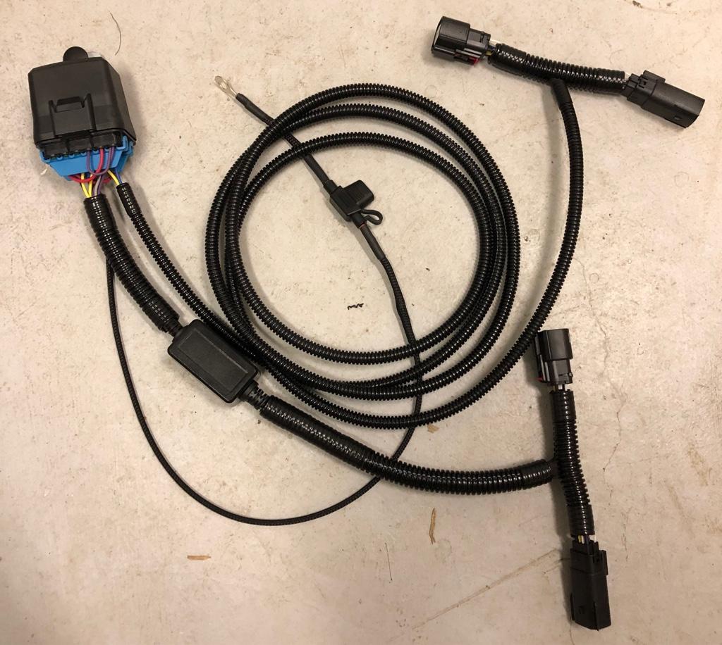

So now that things are verified, I'm ready to offer the newest DRL harness. It will give LTZ headlight behavior to 2015-2017 LS & LT Tahoes and Suburbans with the exception of the LED strips' ability to change brightness levels.
To inquire, please email me at [email protected]. This will help me keep things organized. Payment for the harness will reserve your place in the order queue. For those of you who previously got the DRL pigtails, I am offering a $25 discount (via core refund). Once the pigtails are received back and verified to be in acceptable condition, credit will be issued.

View attachment 257900 Hey Guys,
so I installed CMatt's latest harness and I'm happy to report it has all functions as described.
Supports:
LED stripe on remote start
Parking Lights
Automatic on when vehicle is in drive
I took it a step further about a year ago by installing the standard 2018 headlights that have the brighter LED light bar, and I have full LED brightness. I'm going to unload a video later to show the results.
great work Matt. This is a photo of my car in drive. It was super sunny so it's harder to see but it's working great
