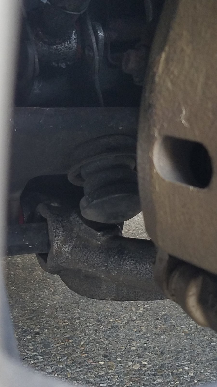

I will have the DJM upper control arms for sale once my new uppers come in. They would have worked out well for me if I didn't go lower than the 3" that it gives.
Also, that "bracing" you mention (I call it the strike plate)... Is that on the front mounting point for the LCA? If not, then why would they brace just the rear?

I've looked at DJM's website and there is no pad on the lower arms for the jounce stops to hit in the pictures. I've also heard that DJM says to not use jounce stops because they're not needed. Maybe you both can enlighten us by showing pictures of this area. Maybe they have 2 different versions?

Here's the item in question.
