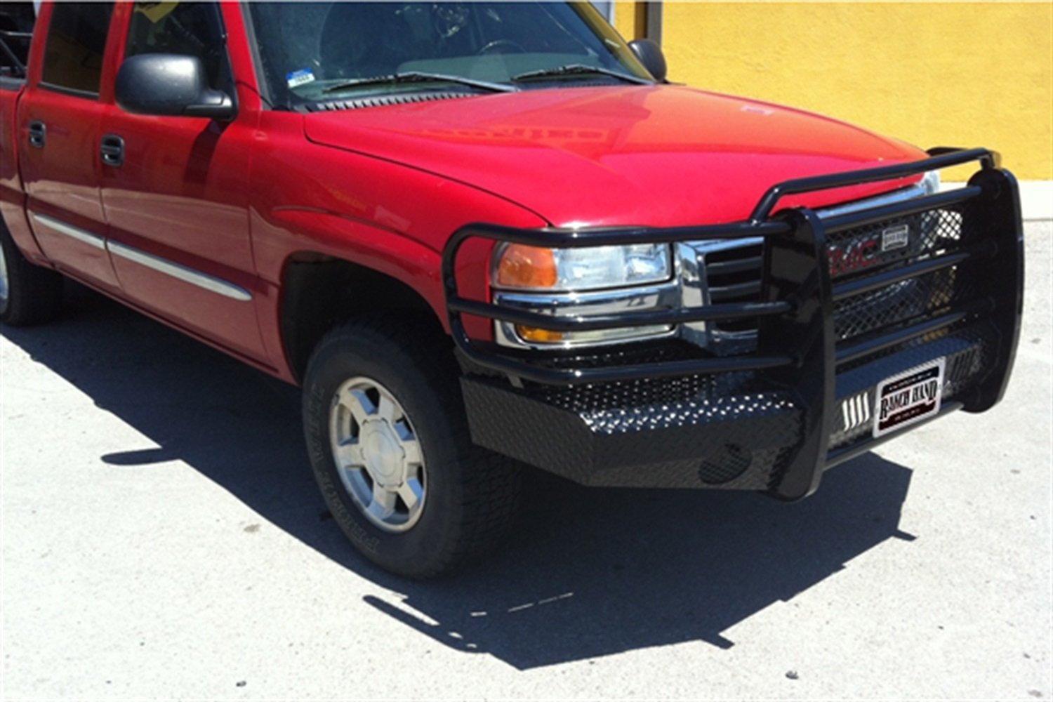

As long as the bumper is for 99-02 Sierra then yes. 03-07 sierra use different frame mounts. However you can cut your frame horns off, and bolt the 03+ in. Then get a 03+ grill and viola, the 03+ sierra bumper fits now
