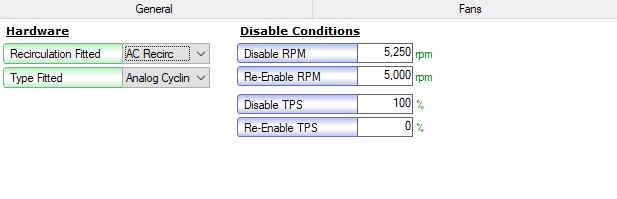

If I compare the PCM harnesses C1 and C2 the correlate with the terminology above. I think what happens if if you change these settings it reconfigures those pins and executes the logic for the pressure sensor.
My 2001 Tahoe
The 2005 Tahoe
I went out and loaded up a tune with the "Recirculation Fitted" set to Fan #2... I think I had some success! When using the scanner I commanded Fan #2 on and the recirculation door moved! This tells me that you can get control of Fan 2 from my 2001 Tahoe. However, it may require sacrificing "recirculation" functionality of HVAC and or coupling the fan and the recirculation door.
2005 C2 Pin 33 High speed Fan mode
2001 C2 Pin 33 Recirculation Actuator Control
Beyond that there appears to be a bit more to the recirculation mode I maybe sacrificing if I switch that setting. I'm not sure what C2 Pin 11 "High pressure recirculation switch" is about.. is that the defog / defrost function of the AC?
I can also of course command on fan one and the fans turn on (low speed).
