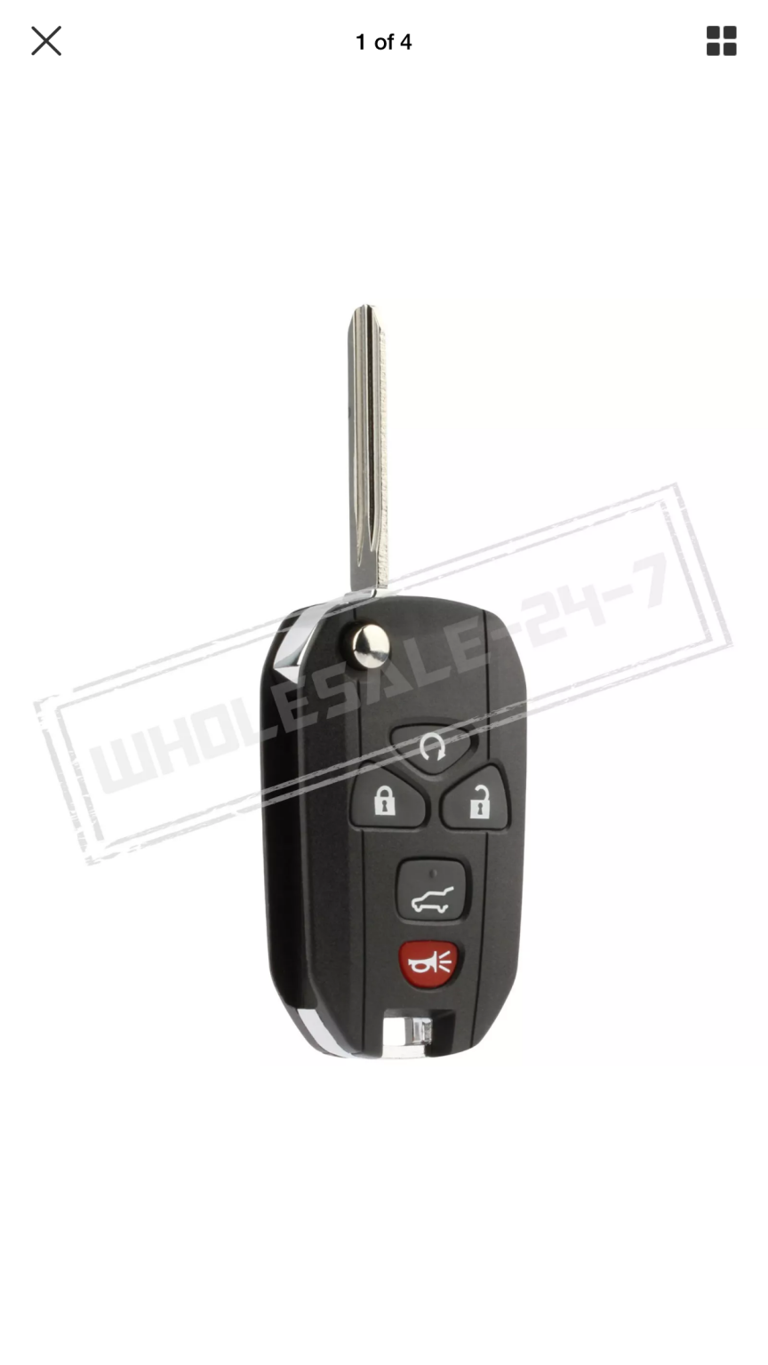

Haha ever so slightly more! I'll look into it and just see whichever one turns out to be cheaper and buy that one. I am a little picky and like the Escalade's because it is a picture of a SUV whereas the 5-button is a sedan. Pretty freaking picky, I know.

I get what you mean about the 5 button having the car instead of truck like the 6 button, but I don't even notice that my 5 button is a car. Plus it was only $45 and I don't have power lift gate so didn't want buttons what don't do anything on my remote.
